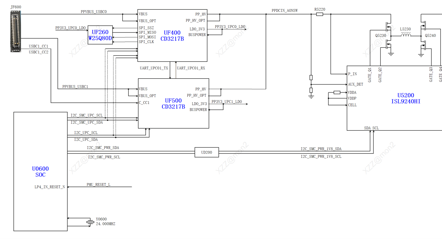

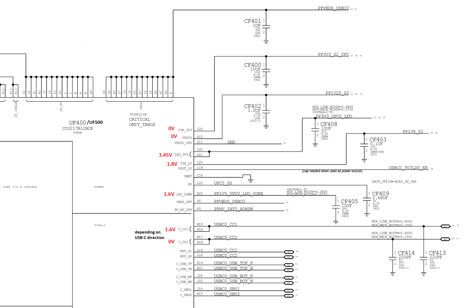

    I had some time to continue and I found out:
    CC1 1,6V on UF400 and UF500 but CC2 is 0 V
    Will it ever switch from 5 to 20V if CC2 is dead?

      CCx are the communication lines for this 1 wire interface used by power delivery. There is CC1 on one side of the USB connector blade. CC2 will be on the opposite half of the USB connector. Only one CCx pin will be active so your measurements so far are accurate.
      Remove the power plug and rotate it by 180 degrees to mate with the opposite half of the connector. Do you now see a voltage on CC2? CC1 will be at 0v since there is no connection on the original side.
      If still @ 0v then suggest to flux and carefully remove the ESD device(s) on the CCx pin that is probably shunting this signal.
      To debug, follow the general guideline for 20v and CD3215 controllers:
      https://logi.wiki/index.php/CD3215_Bootup_Sequence
      Start with confirming that each LDO rail on the CD321x controller is present. The BMC voltage of 1v1 will only be active for the active USB port. Only if each CD321x controller is not defective, then you will have 20v negotiated on the logic board.
      Would you have a thermal camera? To check if there is a shorted part on the board that may be heating up.

        thanks for your answer!
        it switches, when I rotate the USB-C plug

        PP3v3_UPC0_LDO: 0 V, 0,5V diode mode to gnd
        PP1v5_UPC0_LDO_CORE: 0 V, 0,5V diode mode to gnd
        PP3v3_UPC1_LDO: 3,4 V; 0,5V diode mode to gnd
        PP1v5_UPC1_LDO_CORE: 1,6 V; 0,5V diode mode to gnd​
        I can easily find the bmc voltage on the CD3215 but not on the CD3217. Is there another name for it?

          Check each LDO rail on these CD3217 ACE controllers.

            there are the voltages of both CD3217. (USB-C connected to UF 400 first, then UF500)

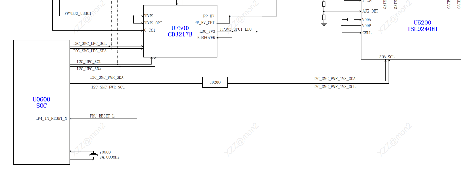

              PPBUS_AON is ok. It is not yet boosted after the SMBUS / I2C communication.
              What is the voltage to ground of the following?
              I2C_SMC_PWR_3V3_SDA
              I2C_SMC_PWR_3V3_SCL
              Test at battery connector J5150 (pins # 3 & # 4).
              The LDO_3V3 rail @ 3v45 seems high. This should be 3v3 and may be of concern. Do you see this exact voltage on the 2nd CD3217 as well? This rail is used to power the SPI firmware boot flash used by these power delivery controllers. Share the above measurements.

                I2C_SMC_PWR_3V3_SDA: 3.3V
                I2C_SMC_PWR_3V3_SCL: 3.3V
                3.3V both
                yes it's 3.43V on both now. I just double checked with another multimeter.

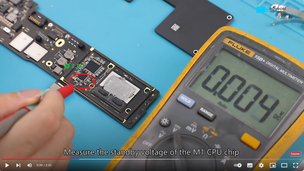

                  The repair wiki article (post #1) still notes that the voltage should be 3v3 for the LDO. The SPI flash is tolerant to 3v6 (max) so it should be ok.
                  See if this is your case here (ironically - still chasing a similar case on a high end iMAC):
                  https://www.youtube.com/watch?v=u4-66f6RFPM
                  • Patrick501
                    • Oct 2024
                    • 39

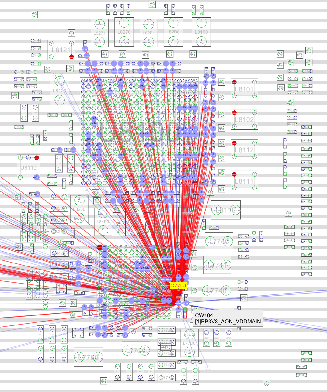

                    I have the voltage (green) on the coil like in den video but no standby voltages in the red area.
                    Only the PP3V8_AON_VDDMAIN seems present

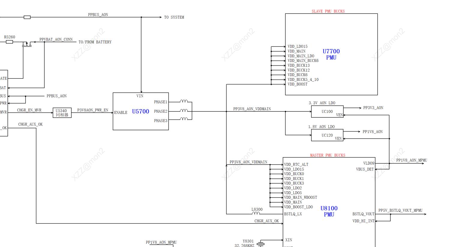

                    • mon2
                      • Dec 2019
                      • 14691

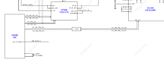

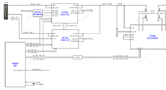

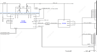

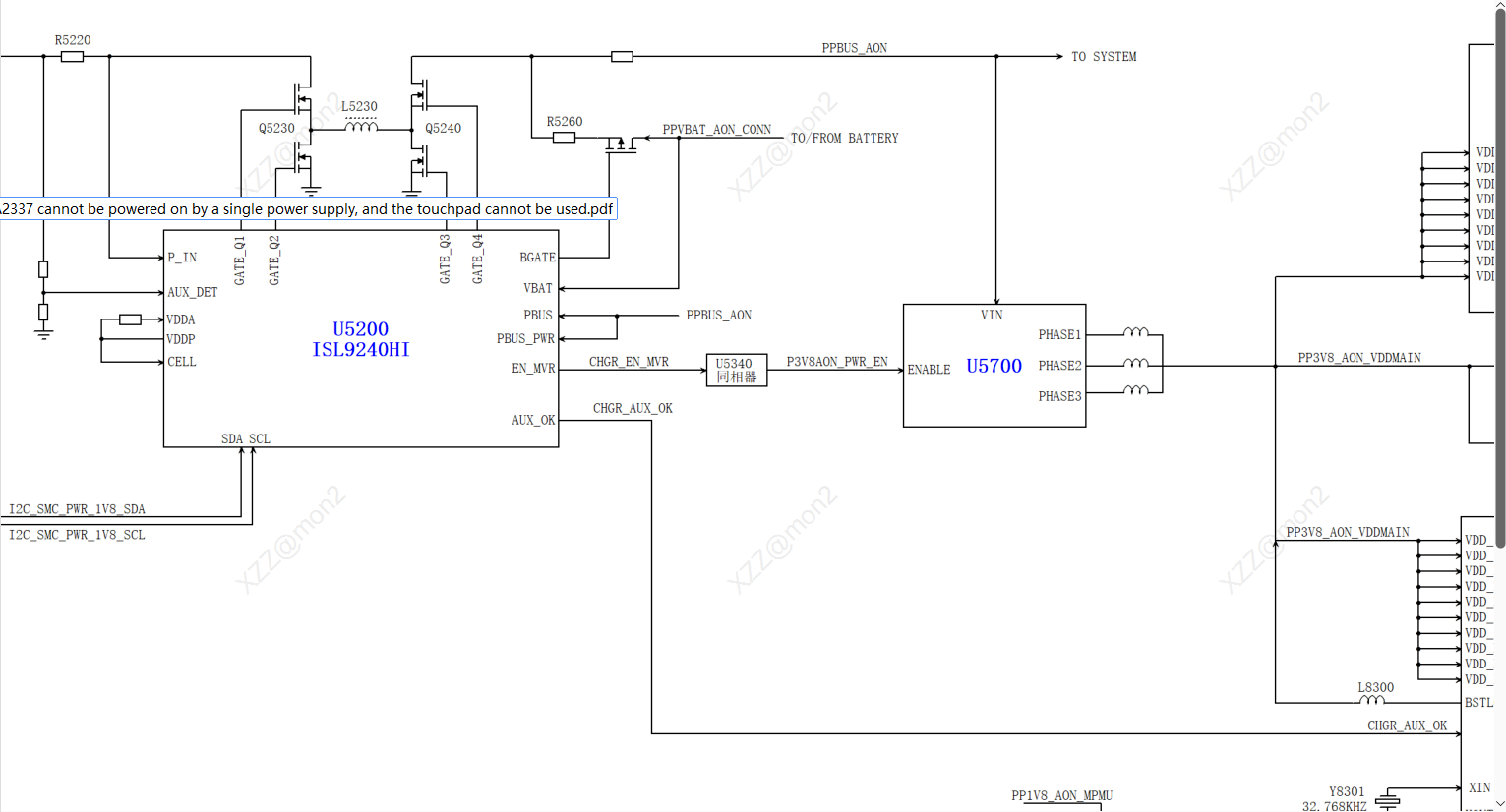

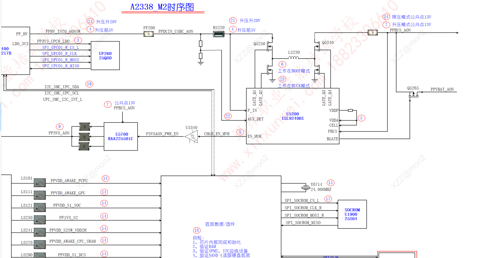

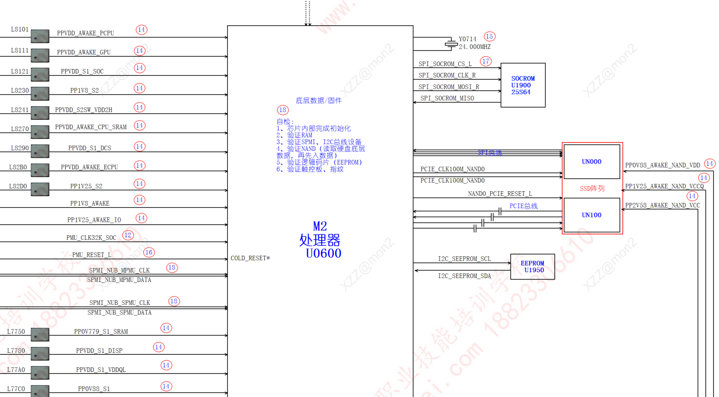

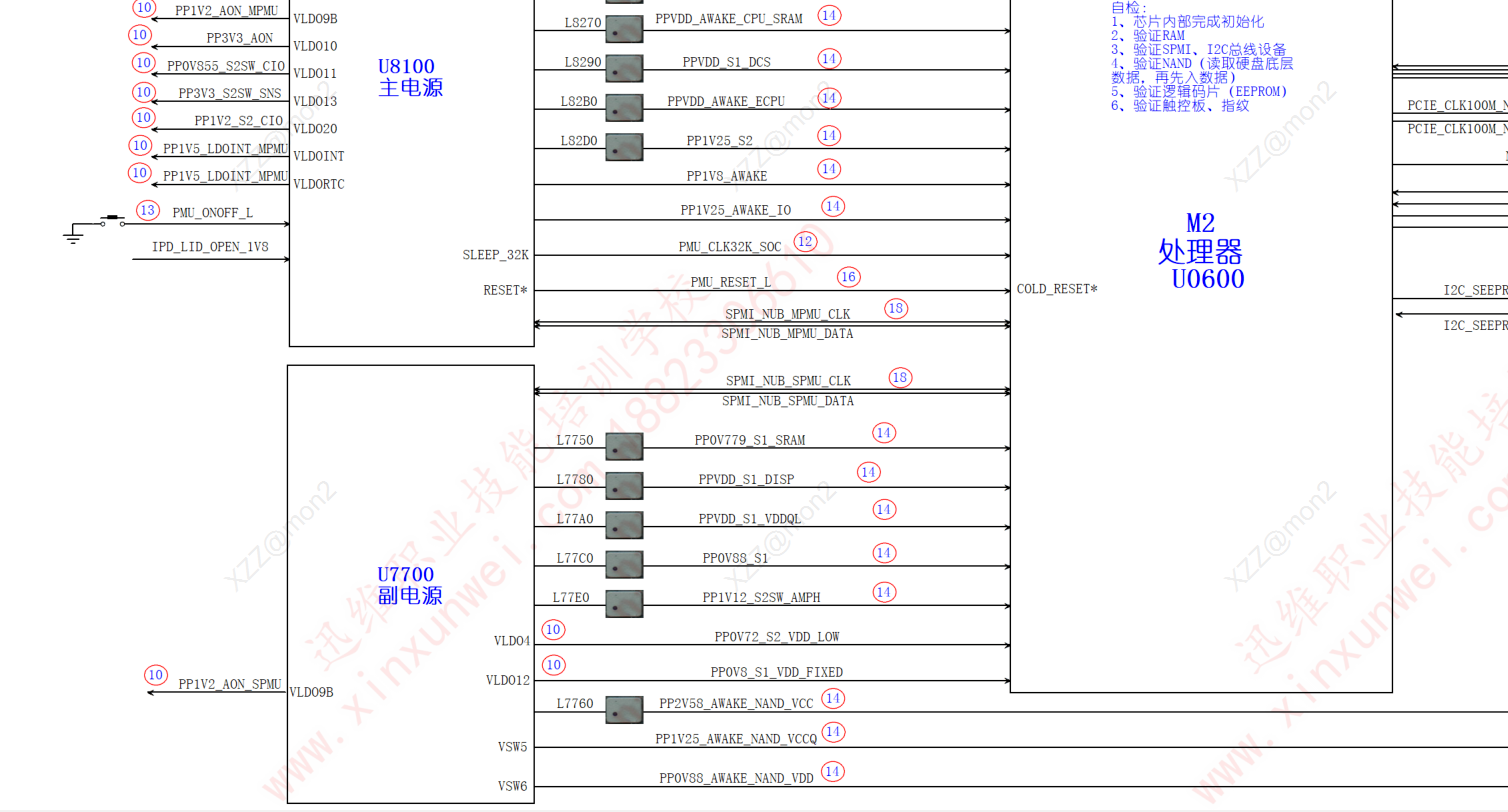

                      See if the attached helps.
                      Click image for larger version  Name:	a2338_power_sequence.png Views:	0 Size:	335.5 KB ID:	3523917
                      Click image for larger version  Name:	a2338_power_sequence2.png Views:	0 Size:	324.4 KB ID:	3523918
                      Click image for larger version  Name:	a2338_power_sequence3.png Views:	0 Size:	301.9 KB ID:	3523919
                      Click image for larger version  Name:	A2338_d1.png Views:	0 Size:	598.1 KB ID:	3523915
                      Click image for larger version  Name:	A2338_d2.png Views:	0 Size:	480.3 KB ID:	3523916
                      • mon2
                        • Dec 2019
                        • 14691

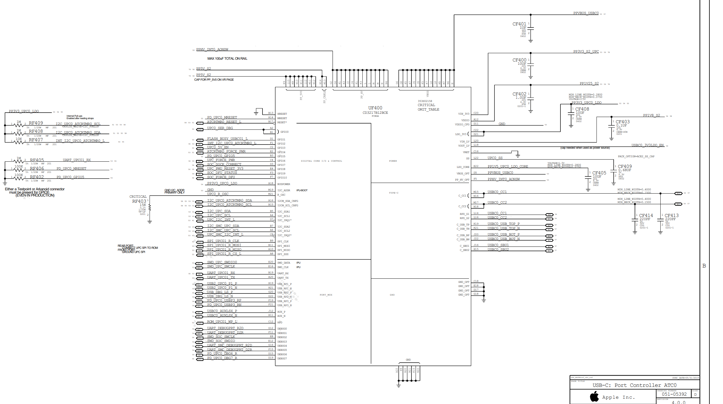

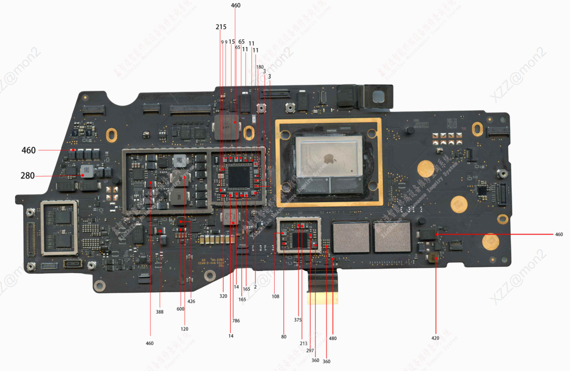

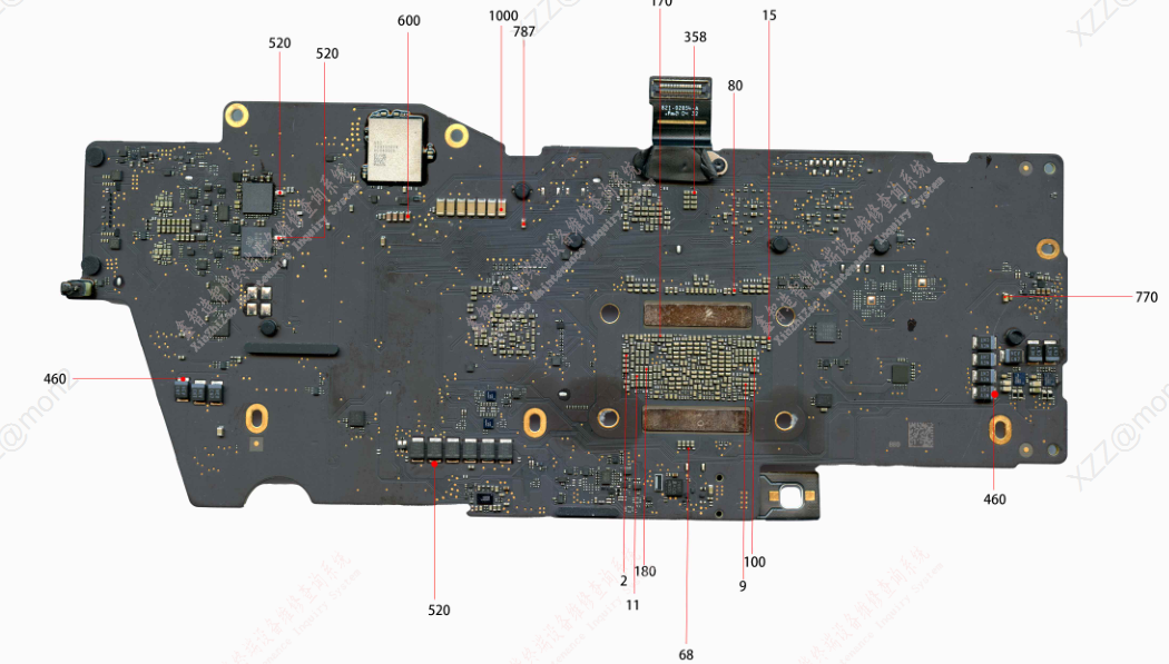

                        The above should be complete for the power up voltage sequencing diagram. Wait...these are for A2338. Ok, need to drink my coffee. Will still leave it up there. Let me check if A2337 is available for the same.
                        Drugs...or not enough of:
                        A2337 (what I have)
                        Click image for larger version  Name:	A2337_p1.png Views:	0 Size:	165.9 KB ID:	3523926
                        Click image for larger version  Name:	A2337_p2.png Views:	0 Size:	135.8 KB ID:	3523929
                        Click image for larger version  Name:	A2337_p3.png Views:	0 Size:	156.3 KB ID:	3523930

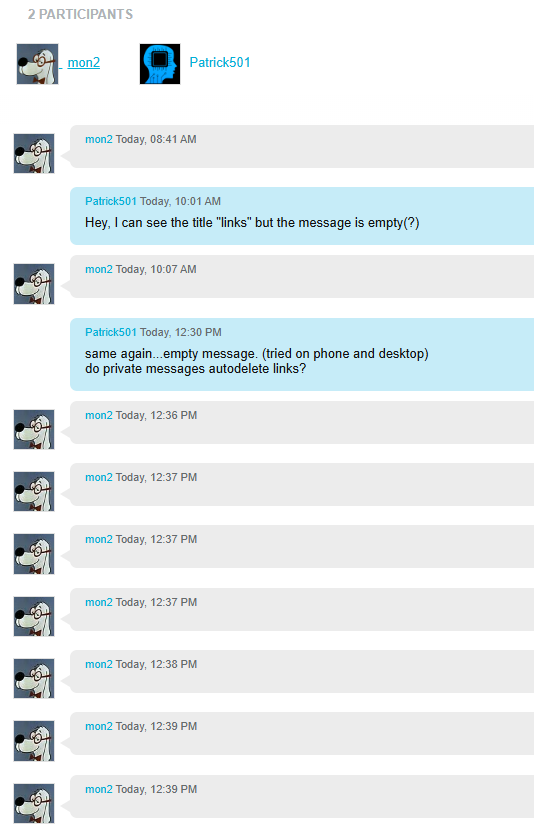

                            mon2
                            thanks for the schematics. Unfortunately is has no numbers for the sequence like the one for the A2338 but I will try to figure this out.
                            For some reason I get private messages without text. Do you know what's wrong there?
                            • mon2
                              • Dec 2019
                              • 14691
                              I received your email - check if that came through ok on your side.

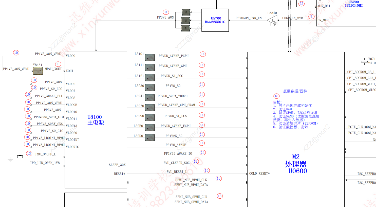

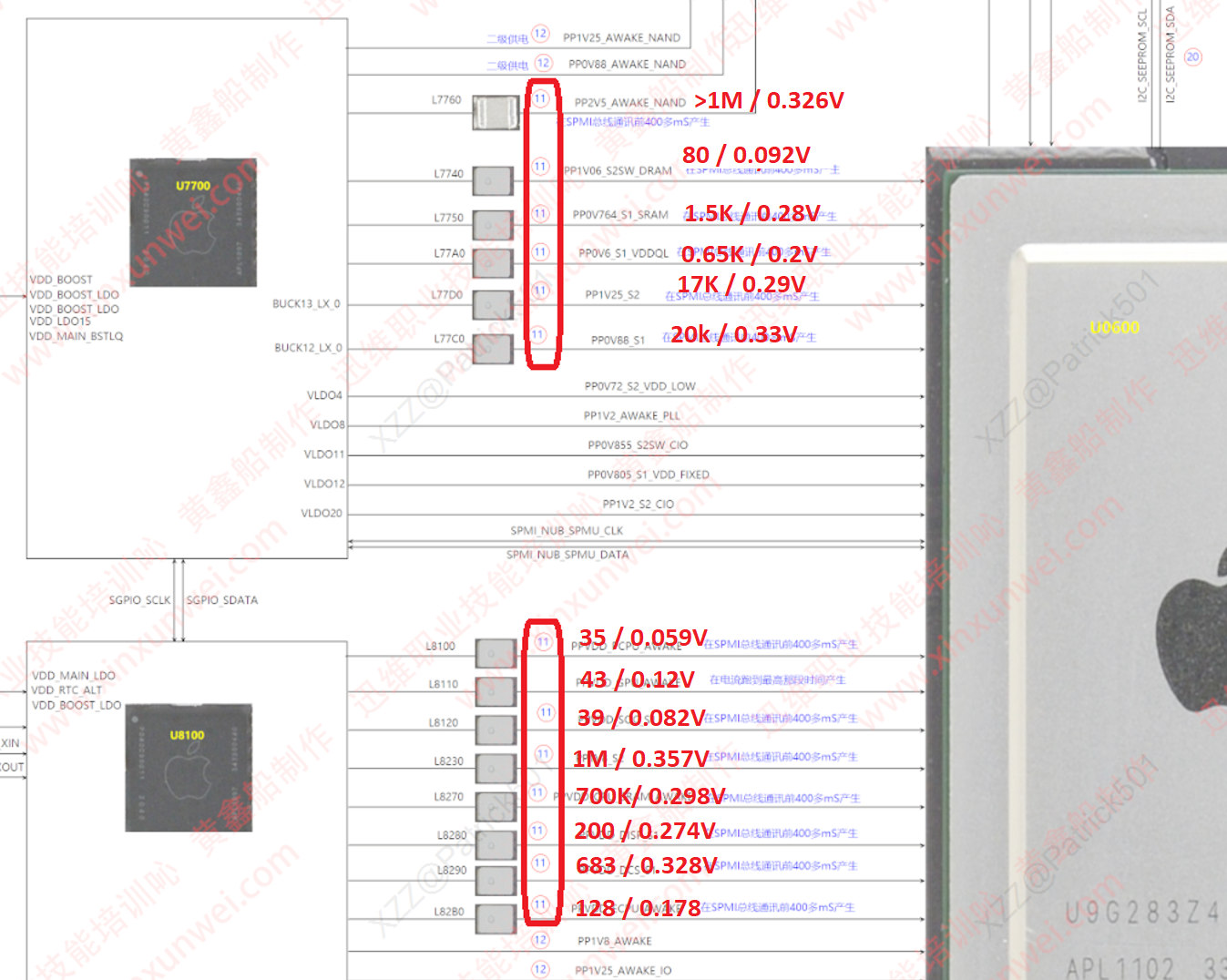

                                for anyone who has the same issue. I don't have a solution yet but meanwhile I checked the power sequences to get 20V.
                                Everything is fine until it reaches the U8100/U7700. There are no output signals, so apparently the sequence ends there. I also checked resistances of the missing output rails./ second step in diode mode.
                                35 ohm seems low but for a cpu rail it should be ok.
                                • mon2
                                  • Dec 2019
                                  • 14691
                                  CPU rail resistance is ok.

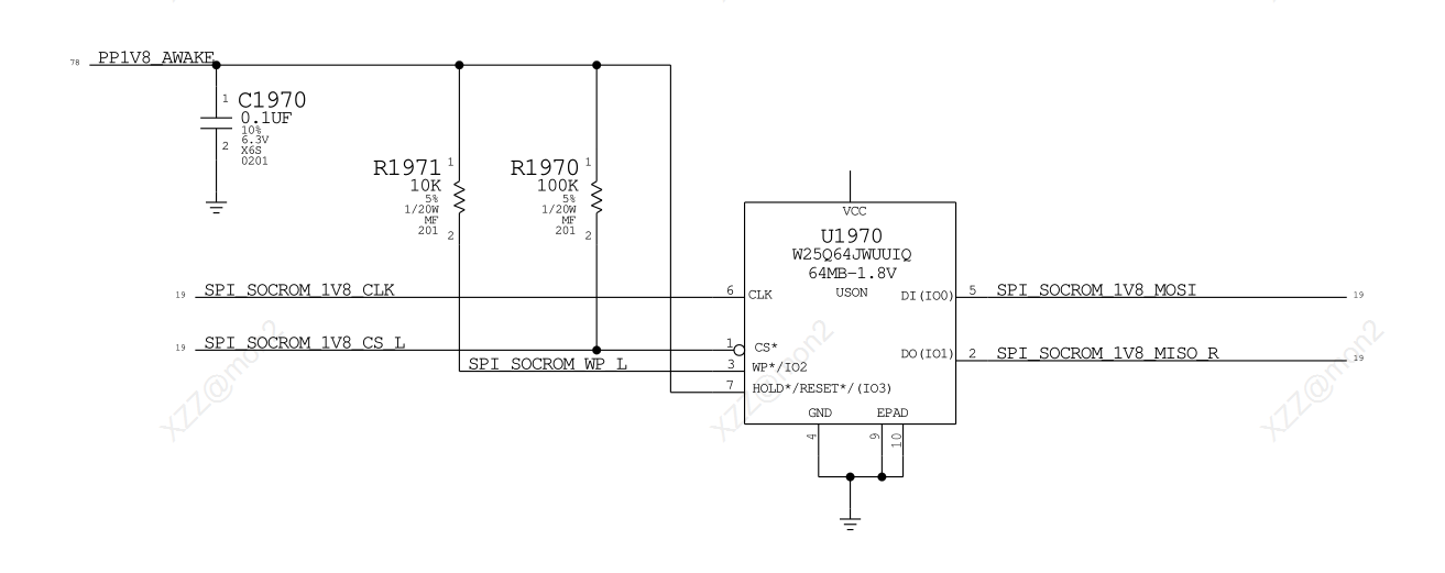

                                      From the repairwiki, missing S2 rails may be due to corrupt firmware.
                                      CD3217 support S2 rails low or missing
                                      https://repair.wiki/w/MacBook_Air_A2...w_at_5V_repair
                                      * same as you cited in post # 1
                                      I would consider the firmware replacement of U1970 before anything else.
                                      • Patrick501
                                        • Oct 2024
                                        • 39
                                        I assume the only possibility to do this is the way it was done here?
