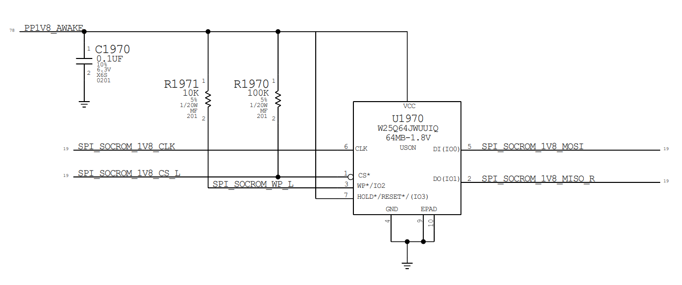

              You don't need a $400 tool to flash an SPI ROM though… Dumps may have been posted already, otherwise use the appropriate forum subsection for the request.
              • Patrick501
                • Oct 2024
                • 33
                I have a question before I start trying to do this.
                Does it even make sense when there's no VCC voltage at the U1970?
                • mon2
                  • Dec 2019
                  • 13830
                  No. This rail is linked to PP1V8_S2 (BUCK3) on the PMU @ U8100.
                  What is the resistance to ground of PP1V8_S2?
                  Would you have a thermal camera? Is U8100 heating up more than normal? U8100 may indeed be defective.

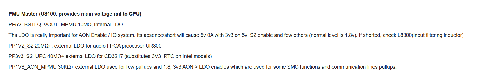

                        Found a good page on M1 notebooks:
                        https://logi.wiki/index.php/M1_MacBooks

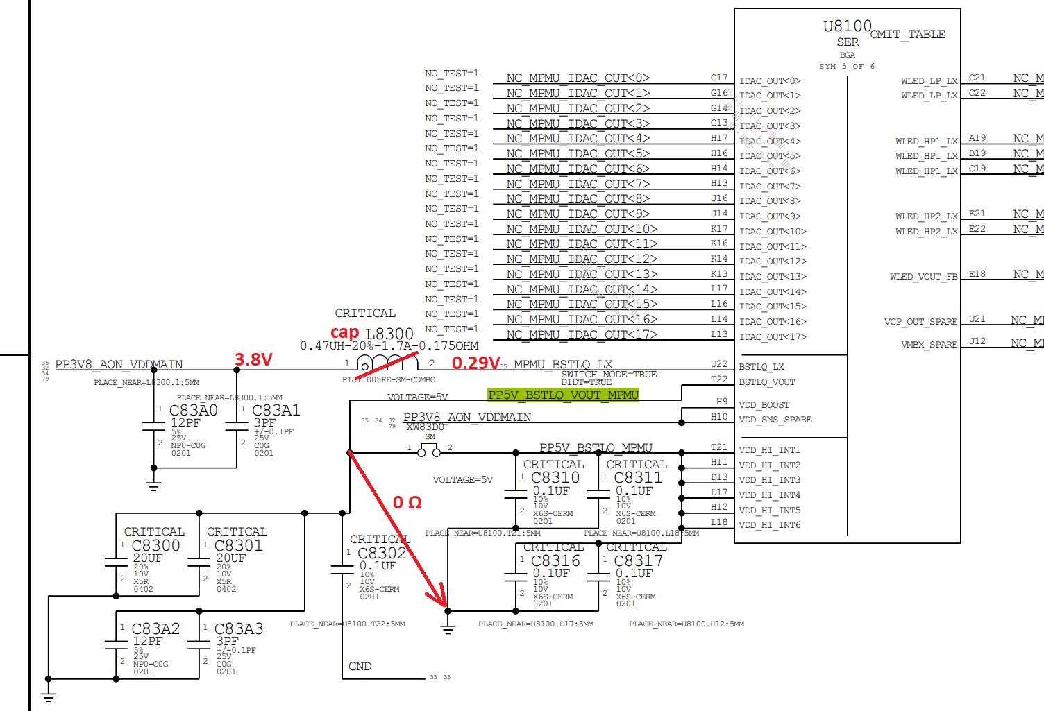

                          damn, good one mon2 ...PP5V_BSTLQ_VOUT_MPMU is 0 ohms
                          and the L8300 is a cap instead of an inductor. That's weird.
                          EDIT: I turned the brightness a bit down. The color of it is slightly different. It's an inductor but I measure14K. There's definitely something wrong

                            Good. Some progress.
                            No the inductor looks like a capacitor and is ok since you have 3v8. Leave that one alone (George Thorogood - Bad to the bone).
                            The 5v rail at 0v is of concern.
                            Would you have a dc power supply that can be dialed up to 1 volt?
                            If yes, inject onto this missing 5 volt rail. The shorted part will heat up like mad. 1 volt setting only!!
                            • Patrick501
                              • Oct 2024
                              • 33
                              #34
                              I have 3.8V going into the inductor but around 0.3V coming out. It should have a very low resistance but 14K is far away from being an inductor.
                              I just removed the cap which became hot. Now I have 20 ohms instead of nothing..

                                My bad. Expected this PMU to be the regulator. Flux and remove this part. It will need to be replaced because the component was pushed beyond normal specs. Correct that the resistance should be ~0 ohms. I was considering that this is a buck regulator and the 3v8 is the output. Instead it is in the input. Technically, you could bridge this inductor for testing but that is up to you.
                                • Patrick501
                                  • Oct 2024
                                  • 33
                                  #36
                                  I replaced the inductor by a wire. The PP5V_BSTLQ_VOUT_MPMU has 3.7V (instead of 5V) now and the U8100 is heating up.
                                  To me, it seems like it has an intern short. The other caps are ok. I desoldered them to check but still 20ohms.
                                  Only a bad cap would've been too easy...

                                    The correct inductor is necessary for a boost converter to work, can't be replaced by a wire… Will likely damage the regulator too since it's gonna basically short full current to ground.
                                    • Patrick501
                                      • Oct 2024
                                      • 33
                                      #38
                                      Same thing with the right inductor. So the U8100 needs to be replaced.
