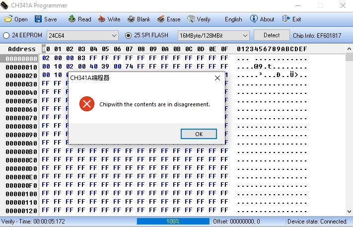

    hello guys , ok i tried everyhting and all that was left was to check bios, ch341 says bios is good? not sure here is the dump.. TIA!

    The complete file must be MB, not KB.
    • irepair559
      • Dec 2022
      • 134
      its actually 1mb but coompressed to 300kb.. when i choose 16mbyte option it saved it as 16mb, What option should i have it on in ch341? Its a winbond 25R128JWSQ 2153 .. HP ENVY X360 15-EY0013DX Thanks

                      ok wrote that bin but gave me this error..
                      Current programmer: CH341
                      10:09:22
                      Verify memory...
                      Success
                      Execution time: 00:02:33.171
                      10:11:55
                      Programming memory(verifying)...
                      Verification error on address: 00F69700
                      Execution time: 00:05:26.351
                      did another verify
                      Verify memory...
                      Verification error on address: 008CF800
                      Execution time: 00:01:23.666

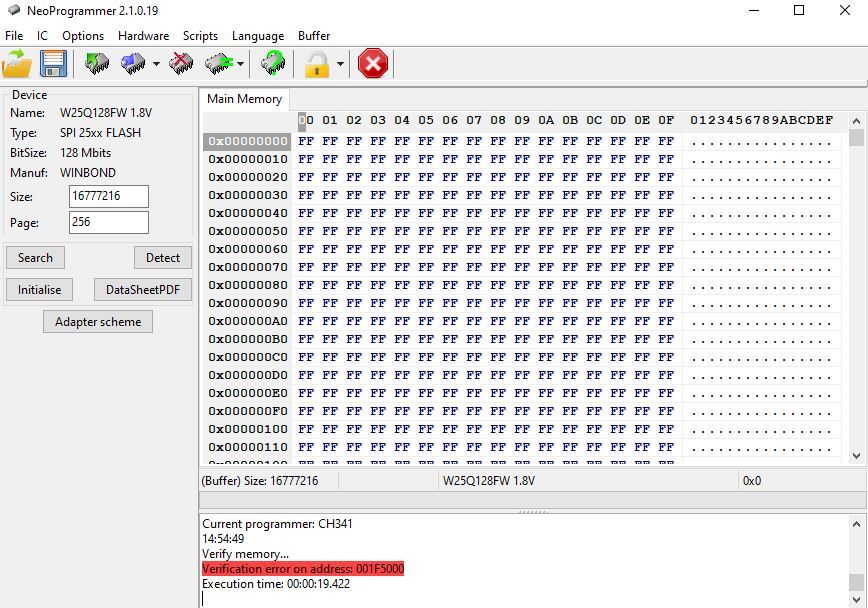

                            I USED ch341a software this time and gives an error when verifying ic i think same area " 00F69700" so both softwares give errors when verifying ic
                            now when i verify it just says this right away when i press verify
                            • irepair559
                              • Dec 2022
                              • 134
                              i tried neoProgrammer again and after many times of erase and verify it always gives me an error..
                                SMDFlea commented
                                Editing a comment
                                Replace the chip

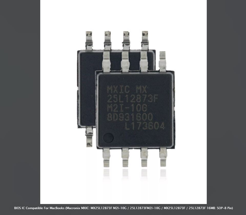

                            • irepair559
                              • Dec 2022
                              • 134
                              is any winbond ic x25x128xxxx compatible and Wheres the best place to buy them? thanks
                              is this chip compatible ? Macronix MXIC: MX25L12873F M2I-10G / 25L12873FM2I-10G / MX25L12873F / 25L12873F 16MB: SOP-8 Pin)
                              it looks the same and its 128mb ?
                              Originally posted by irepair559
                              it looks the same and its 128mb ? ?
                              YES 128mb i ordered 2 and will see...
