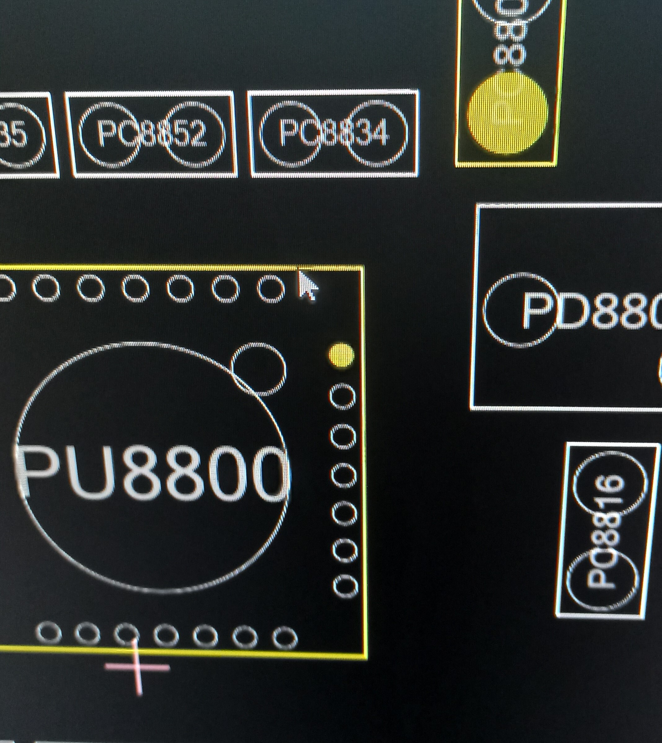

    Good evening, my asus u36sd rev2.1 always has the orange charging LED on when I have the battery inserted, without the charger inserted, without the battery I have chg_en# at 3v everything is fine but when I insert the battery I only have chg_en# to 0v when in reality it should have 3v.

            Check your diode feeding into pin #28 (Vcc) from the battery. The voltage is too low here for the battery only case.

                      • infordecima
                        • Oct 2024
                        • 9
                        • portugal
                        It goes through the pd8802 but it shouldn't be the one sending the battery voltage, maybe the pq8804?
                        The pq8804 seems to me to come from the vin (charger) and another battery pin.
                        The PD8802 pins 1 and 2 (0.46v) are connected.
                        The pr8829 is not on the board, it must come from the factory like this.
                        The second image is pin 28 vin of the load bq that will connect to pin 3 pd8802
                        Click image for larger version  Name:	IMG_20241017_174136.jpg Views:	0 Size:	108.5 KB ID:	3486021
                        Click image for larger version  Name:	IMG_20241017_174143.jpg Views:	0 Size:	56.6 KB ID:	3486022

                          Ok. Confirm that pins # 1 & # 2 on PD8802 have the same battery voltage of ~15v59 volts.
                          Then pin #3 on PD8802 should be about 0v6 lower than the input voltage so around 15v on pin #28 of the charger IC.
                          If not, then PD8802 should be replaced. Since Asus schematics are in the witness protection program, the schematics are rare. You will need to trace out this region of the circuit and post all details here. Which exact part / diode mates to pin #28 (Vcc) of the charger IC. Assuming it is PD8802 or another, the voltage should not be so low when you attach the battery on the Vcc pin.

                            pin #1 and #2 of the PD8802 have 0.46V and #3 7.48v when it should have 15v, as this pin goes to pin #28 of the load ci.
                            I'm going to replace the pd8802 to check if the #3 voltage goes up.

                              Hunt for the diode that has the battery voltage on pins 1 or 2. That is the diode of interest. It is not this one since you have a very low voltage at pins 1&2. You can remove it to see if this part is reverse leaking.
                              • infordecima
                                • Oct 2024
                                • 9
                                • portugal
                                I didn't find any diode in the charging bq power circuit, just that pd8802 is normal?
                                Now I don't know where the 7.53v from the pd8802 comes from.
                                I already changed the pd8802 and the behavior remains
                                I attach the boardviewer to help me please
