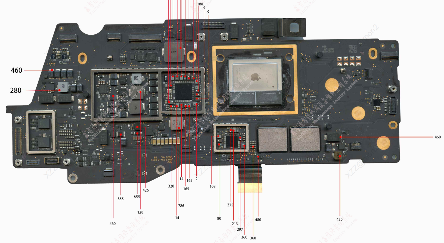

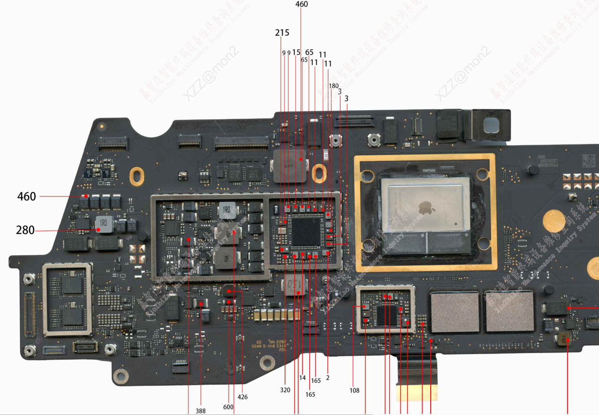

                          With no power, check the diode mode values against the attached.
