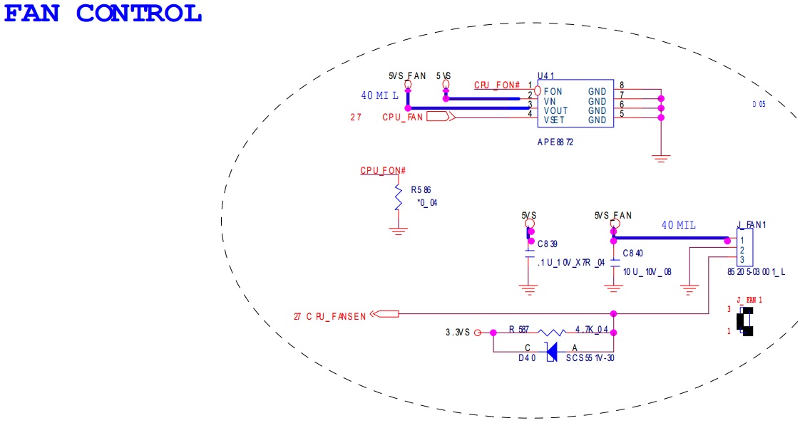

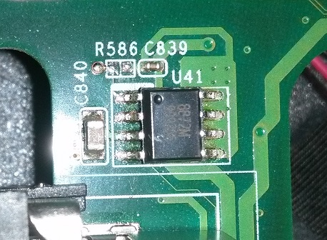

    Hello!
    I've got a laptop with fan problem. Doesnt turn.
    Here's the circuit.
    On U41 I've got :
    Pin1 - 1.44V
    Pin2 - 5.14 V
    Pin3- 0.03V
    Pin 4 - 0.01V
    On JFAN :
    pin1 - 0.02V
    pin2-GND
    pin3 - 3.25V
    U41 is the culprit?
    Didnt find any shorts.
    Thanks for your help!

          You are not measuring something allright. You can't have 5v on pin 2 of U41 and 0.02v on pin1 of JFAN and no shorts.

              https://cdn.badcaps-static.com/pdfs/...a2fa5bebc3.pdf
              Humm... I think the pin2 of U41 is Vset, and then nothing to do with pin of JFAN
              JFAN pin1 = Pin 3 U41 ( Vout = 1.6x Vset pin 4)
              I think the problem is having 0V at pin 4 Vset
              If I had 3V there the 5V would appear on pin 3 of U41.
              I've mesured on D40 3.25V

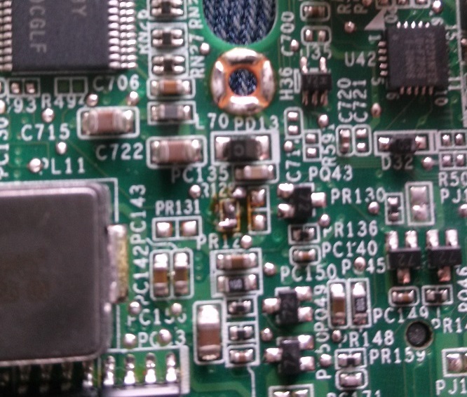

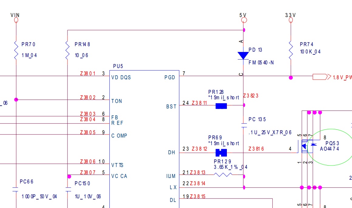

              I've also noticed that I have what seems to be a burned component (see photo attached )
              It's PR128 I think ...
              The laptop had also problems in keeping CMOS settings , but the battery is OK (2.9V)
              Where could I find a similar component to change this one? on a broken laptop rig I suppose ?

                  that looks more like soldering residue from an iron.
                    I think so too. Note that Pin 1 (/FON) will turn fan on full if pulled low, I would try that, if it starts the fan, find out why you aren't getting CPU_FAN signal to Pin 4, if it doesn't, maybe U41 is dead.

                      The shematic (picture) points it clearly that they are shorted pads and I don't think it has to do anything with the EN signal of the fan because it is to boost the voltage of a voltage regulator and from what I understand from the picture it has to do with the 1.8v regulator.
                          UPDATE
                          Ive pulled low Pin1 and the Fan started spinning immediately!
                          Mesured the resistance in R586 and I read 1170 ohms...

                            That R586 is probably OK, and I guess so is U41. They aren't going to pull it down hard with a low value resistor and lose control over the fan. Most likely CPU_FON# signal is normally pulled high and goes low when they want the fan at 100%
                            Though I don't understand what the *0_04 means on the schematic for R586.
                            Can you post the full schematic file to find out where these signals go, especially CPU_FAN?
