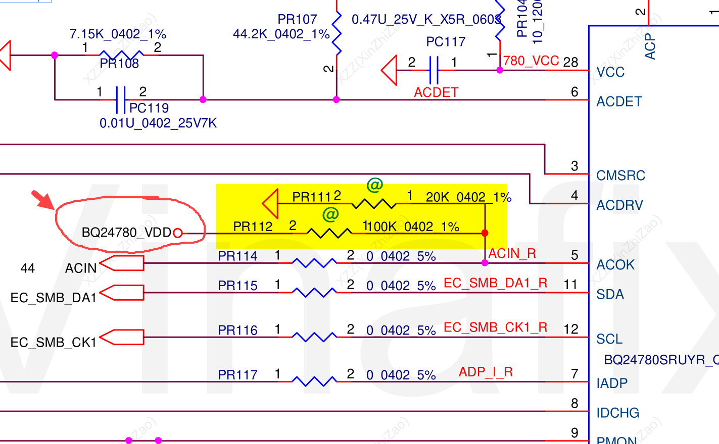

                                  Measure the voltage to ground of ACOK (pin # 5) on the charger IC (PU100).

                                    Voltage to ground of pin 5 of PU100 2.5V.
                                    Can you tell me what Batt+ and V9B+ mean?​

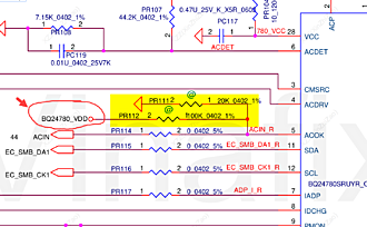

                                          See attached. Confirm if you have the 2 resistors onboard with a high side and a low side to lower the REGN voltage.
                                          Confirm if you have ~6 volts on one leg of resistor PR112.
                                          That is, with a 6 volt input, with PR112 & PR111, the ACOK voltage will be divided down.
                                          Can you confirm the resistance of PR111? PR112? Remove all power / remove the battery. Measure the resistance across each resistor to measure.
