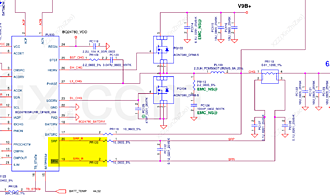

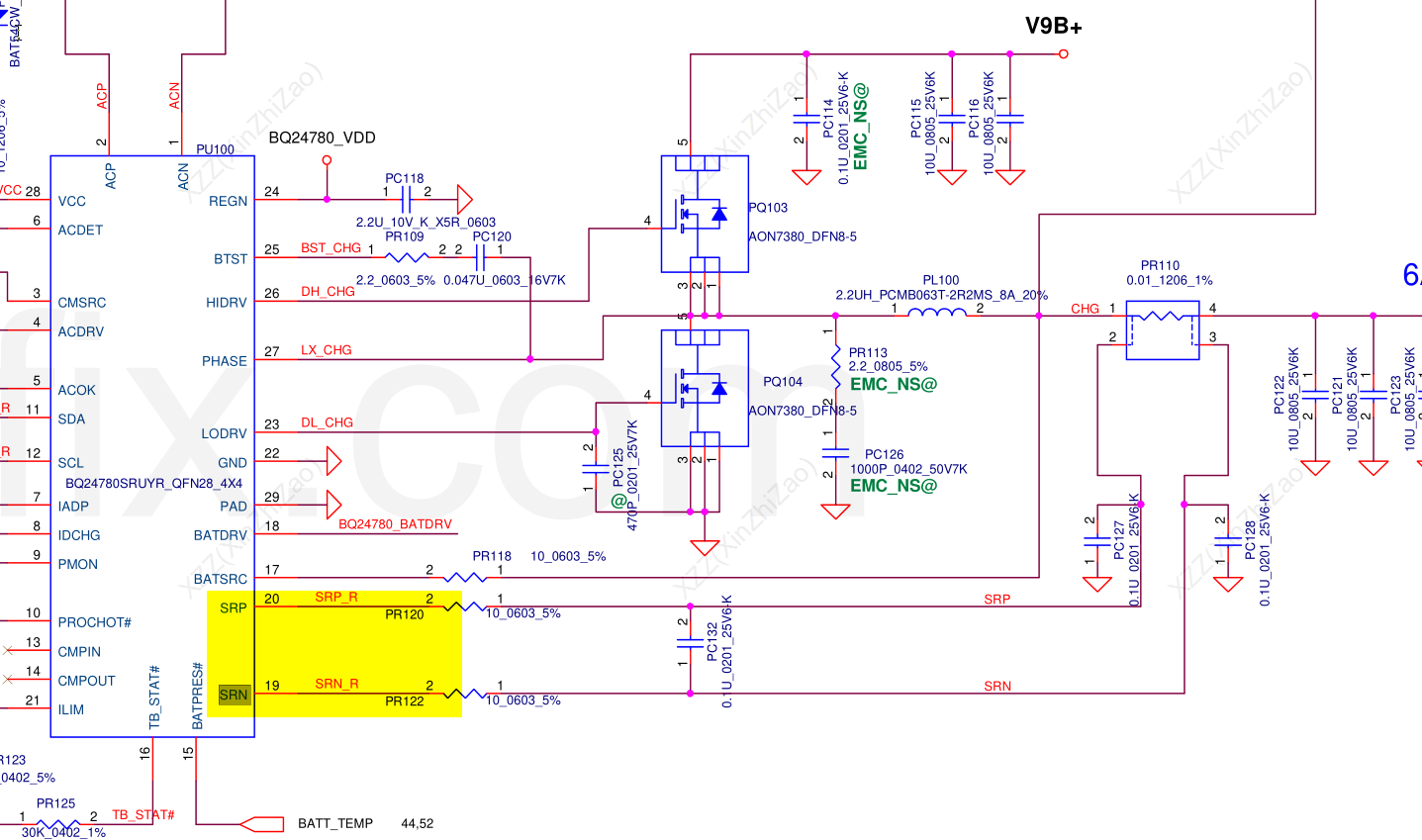

                Also interested in the resistance reading (measure directly at the charge IC) of pins 19 & 20. One probe on 19, other on pin 20 - no power / no battery during this measurement. We are checking the full path resistance of the current sense loop circuit for the battery charge circuit. This measurement should be ~20 ohms if all is ok.
                      Click image for larger version  Name:	srp_srn.png Views:	0 Size:	201.1 KB ID:	3303126
                      20Ohm

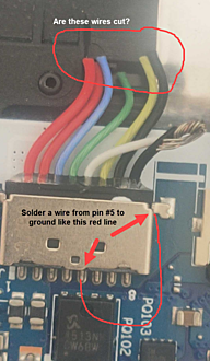

                        See attached on how to short the wire on pin # 5 of the battery connector = BATTPRES# signal.

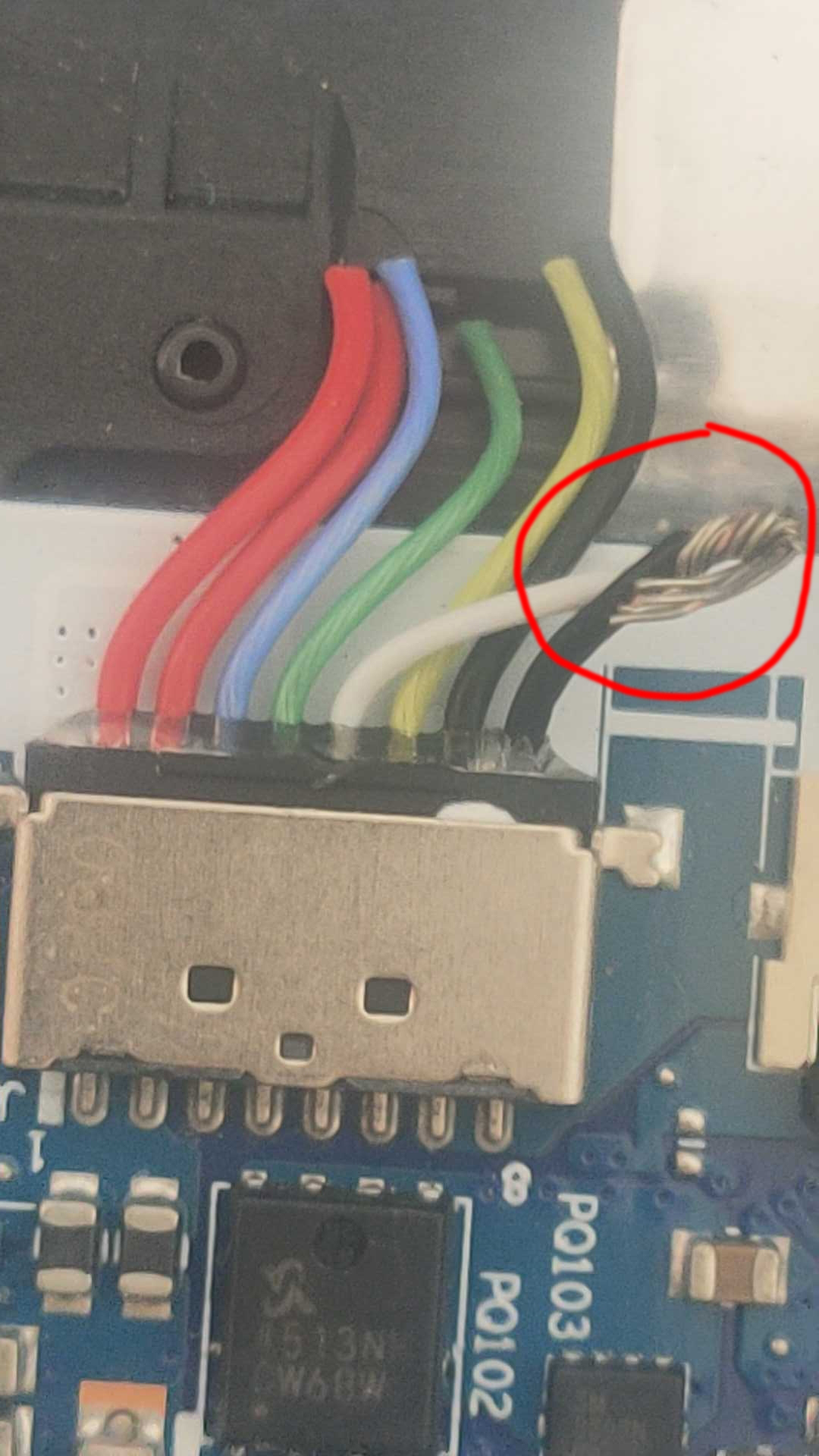

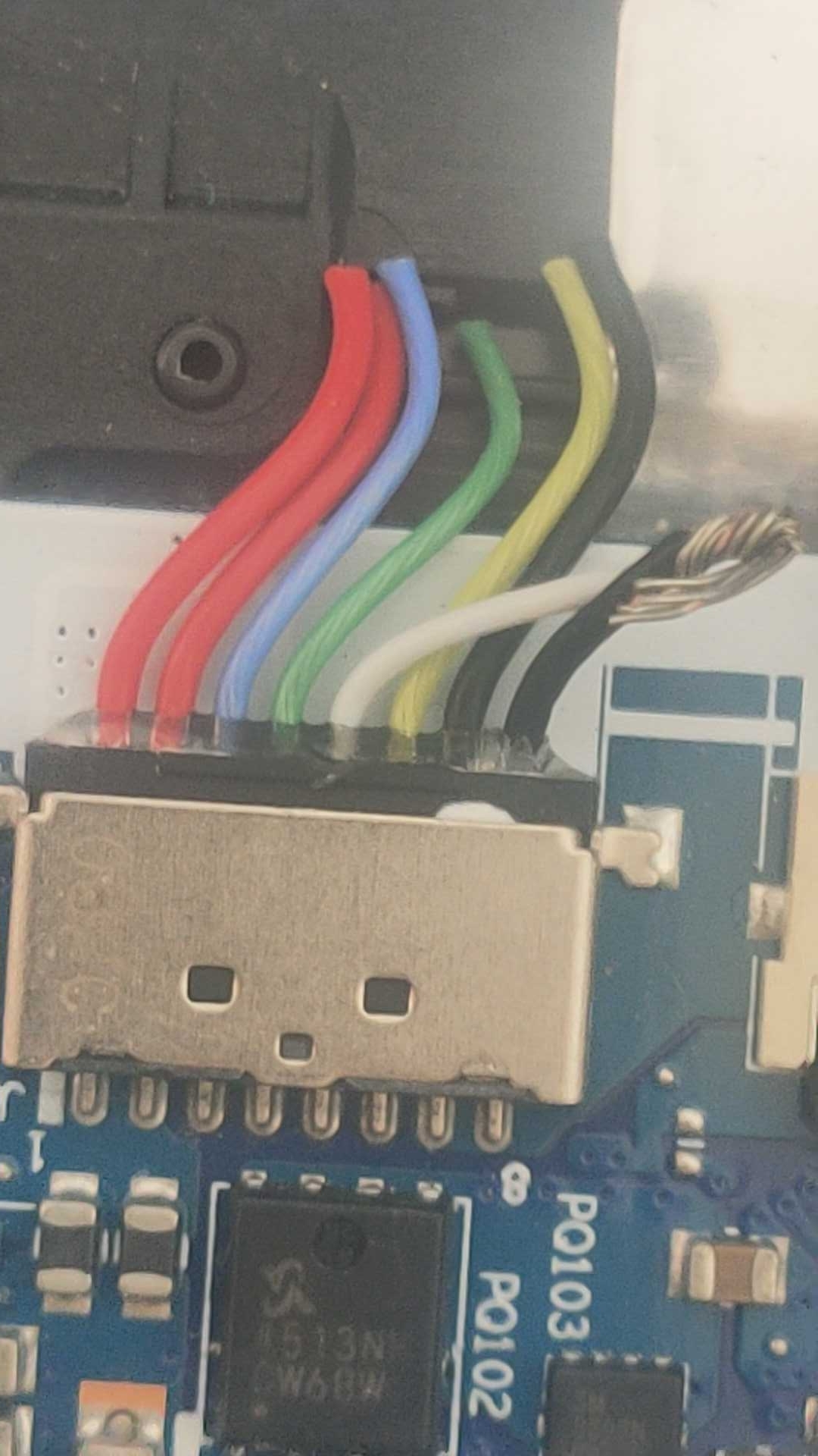

                        • Zippo978
                          • 47
                          • Italia
                          Sì, i fili sono stati tagliati, il connettore è stato preso da una vecchia batteria danneggiata e invece di saldare ho legato insieme un filo di terra e il filo del pin 5
                          I have a automatic tester

                            Ok. With the power adapter and battery connected -> carefully measure the voltage to ground at inductor PL100. This is the battery charge voltage.

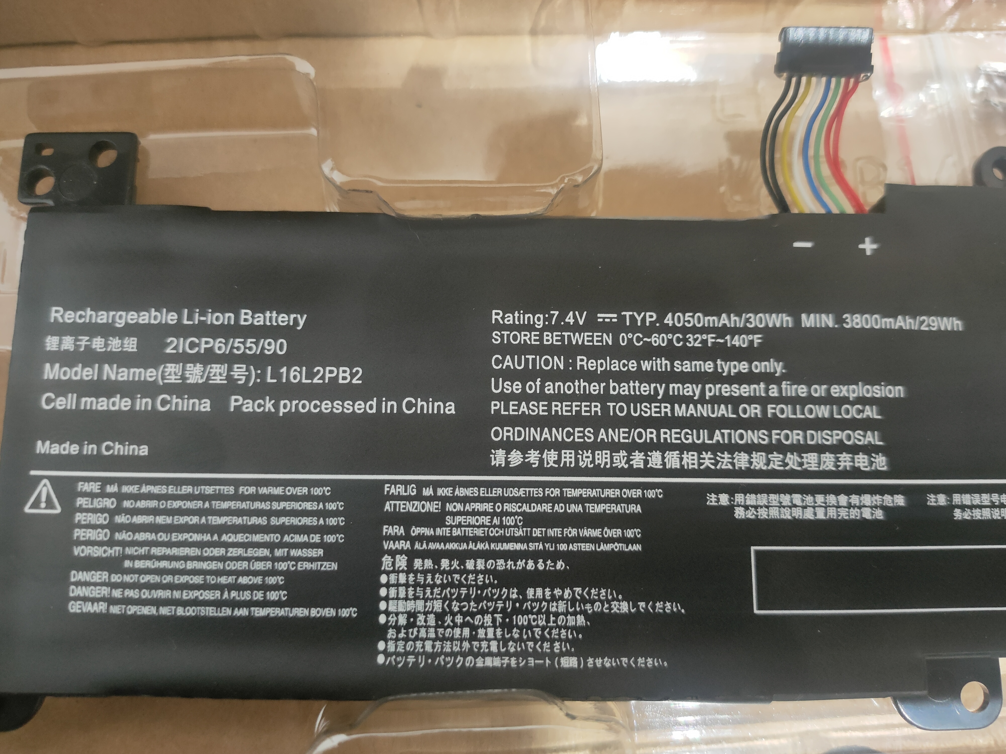

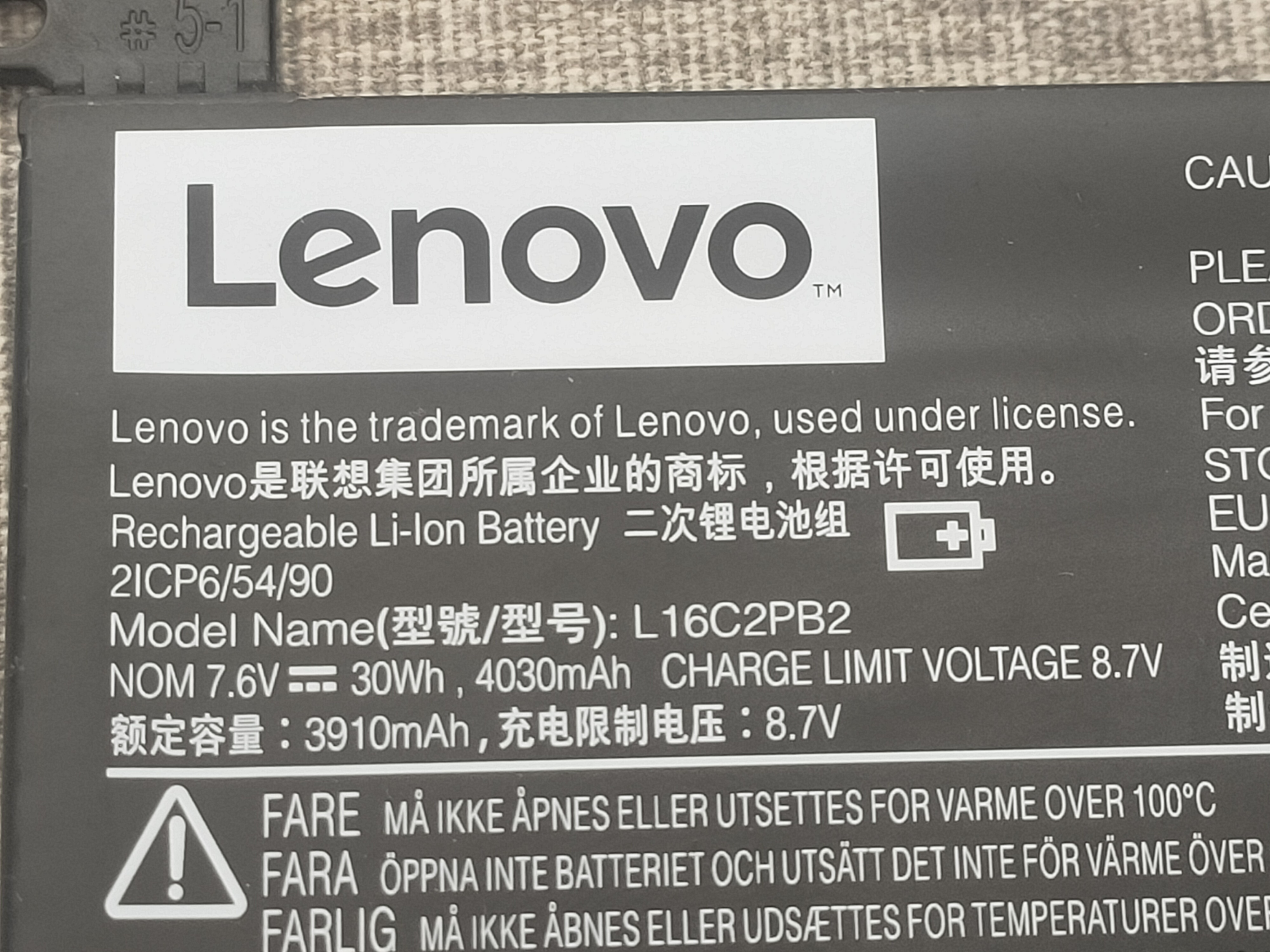

                                What are the battery pack markings for the voltage?
                                What is the voltage to ground of ILIM pin # 21 on the charger IC ? This pin defines the battery charge current.
                                • Zippo978
                                  • 47
                                  • Italia
                                  ILIM 1,182 V
                                  Bbatteria originale
                                  Compèatible
