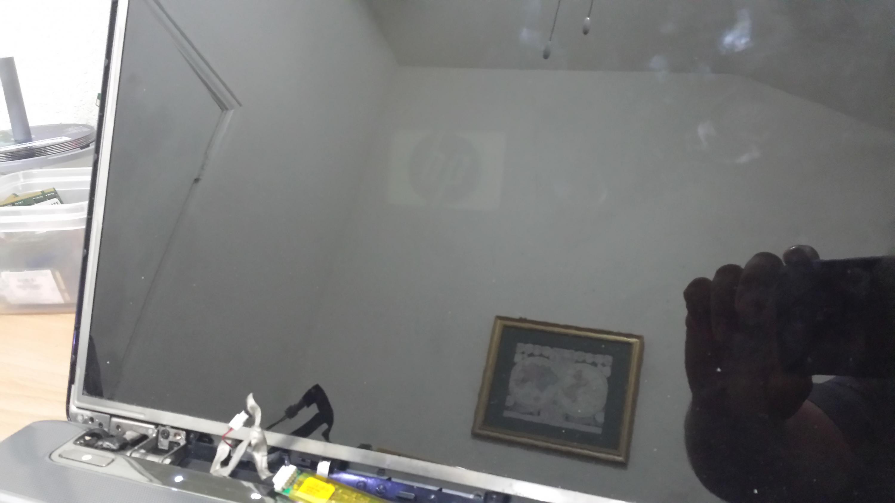

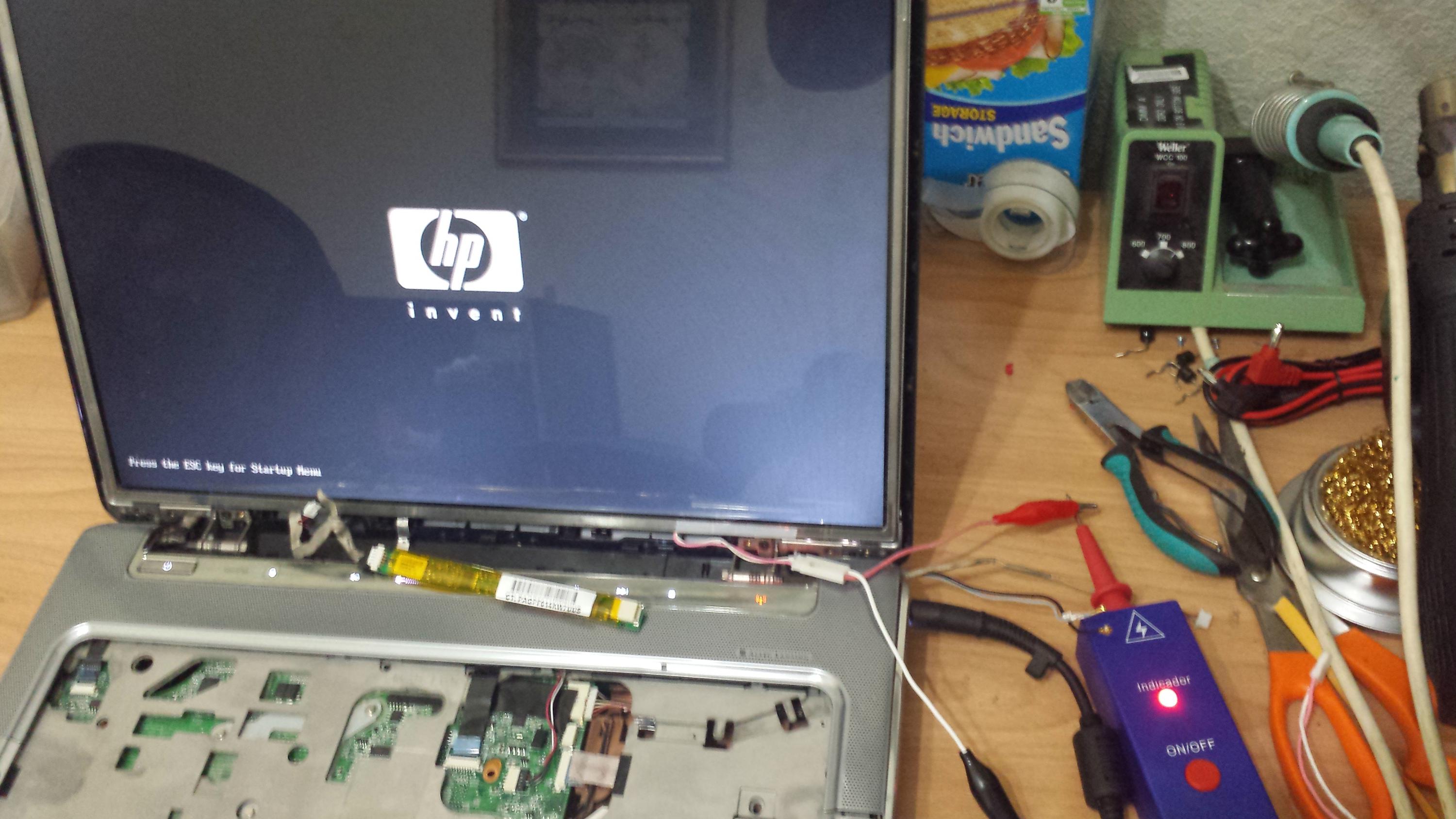

    Hello everyone.
    I need you value opinion on this.
    I have a dv5-1000 hp laptop with no backlight.
    My first was checking the inverter with my multimeter on ac mode
    suppose this need to generate some kind induction (voltage go up liitle bit), but, this doesn't work.
    So i bought used inverter but still nothing. (as023216300)
    i bought a second one , new, but still nothing.
    The second come in with different part number as0231701f3).
    The lcd backlight was tested in is good condition.
    The voltages come in into inverter are.
    1. 19.03v
    2. 14.25v
    3. 0.13v
    4. 16.17v
    two pictures are include.
    1. Lcd testing
    2. Screen very dim image
    any ideas.
    Thanks.

    Re: HP DV5-1000US inverter or lcd
    19v to run the ccfl but 3v are missing on your inverter.without 3von off inverter can not starts
    • crdz66
      • Nov 2012
      • 242
      From where can get the 3volts?
