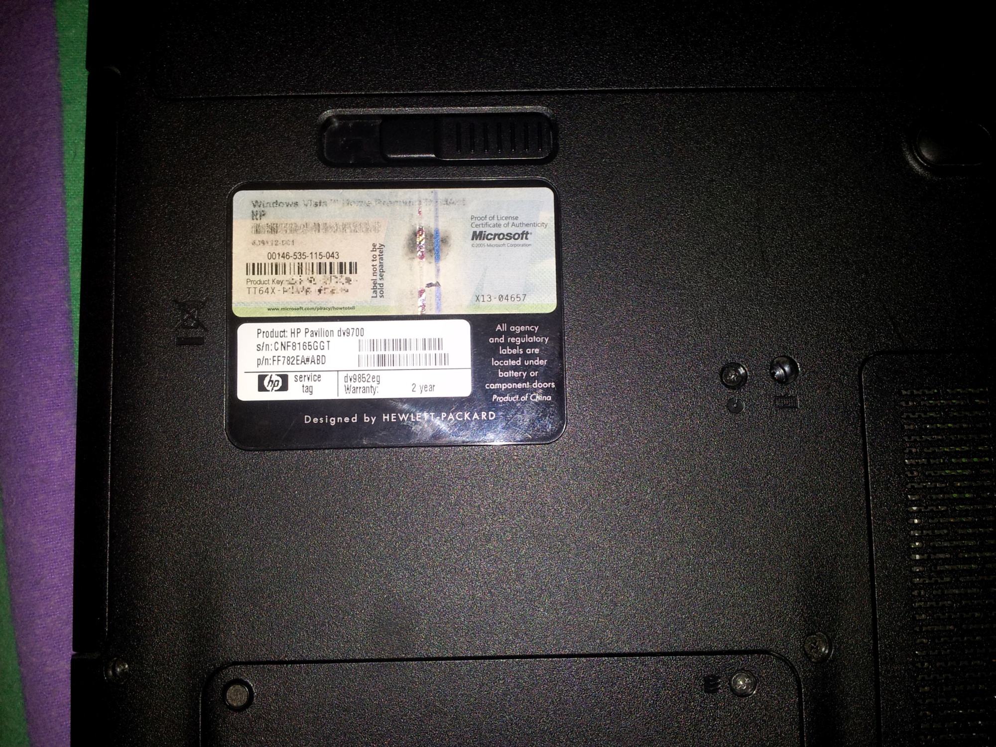

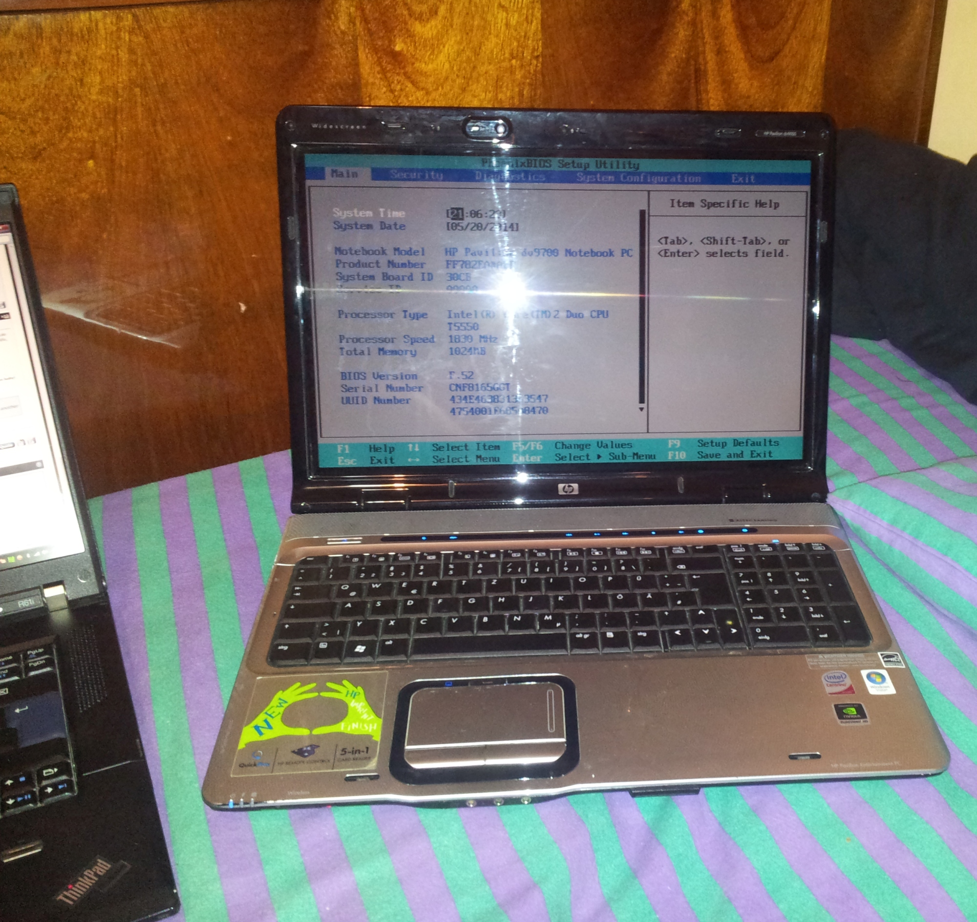

                    Got some news. Guess what i picked up today? ANOTHER DV9000... This one looks pretty darn good, and it's got all the bells and whistles one could ask for. It's got the intel board, the 8600M GPU with 256MB, and also the blu-ray drive.
                    What it didn't have: No RAM, hard drives or HDD caddies and no power adapter. Displayed garbage when i put some RAM in. I turned it on and left it belly-up for a few hours, then turned it off and back on and guess what... It works just fine now.
                    And guess what i paid for it? $12.35. Now that's a catch.

                        I just lucked out on this one. Some guy came into the shop today carrying this thing, he'd been carrying it around all day and nobody wanted to buy it. Especially since it was stripped of all parts with resale value; basically the only thing worth anything for other shops which don't do BGA rework is the screen, and there's very little market for 17" screens as those big laptops usually sit on a desk their whole life, so screens rarely break.
                        I have three 17" laptop screens, and i've had them for longer than i can remember. Nobody wants to buy them.
                        So anyway, since it was missing so many parts and also the motherboard was broken, it wasn't worth fixing for him, so he agreed to give it away for a little pocket money.

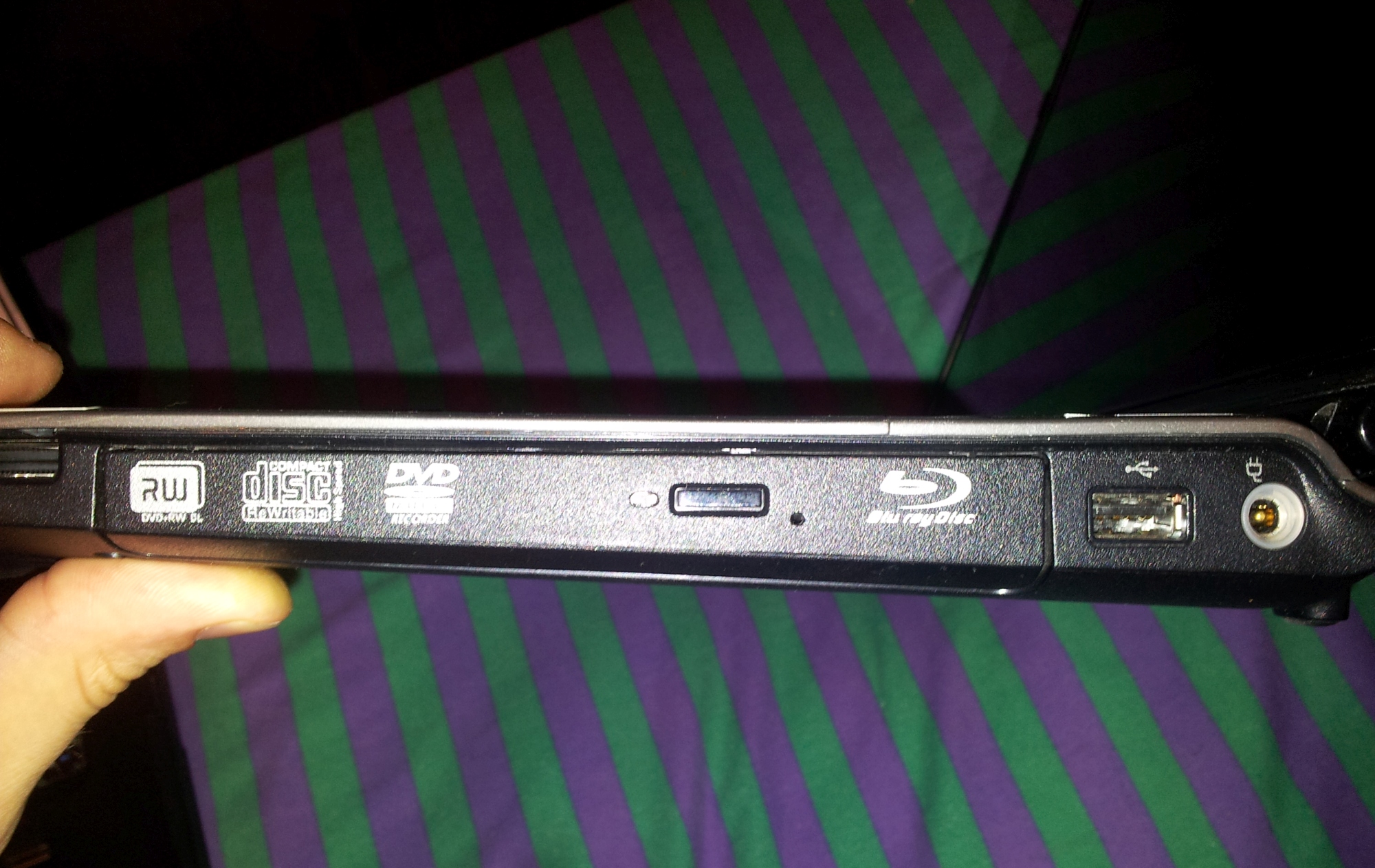

                            Wherever i can find them, locally. Last pair of 2GB DDR2 modules, currently in my Lenovo R61i, i put together from two laptops i bought for parts. They're usually in the range of $15-$20 per module (used, of course) for DDR2, and cheaper for DDR3, around $10 to $13 as the standard memory on laptops nowadays is 4GB DDR3.
                            Here's some pics. I knew i was going to need them so i bought two drive connectors for dv6000/dv9000 series last week. Now all it needs is a hard drive.

                                This happened to a couple of Acers I have here too, left them running for 10-20 minutes and they sprung into life on restart. Not a permanent fix though!?
                                  Of course it's not permanent. In fact i expected it to crap out immediately after i shut it down, but i brought it home and it still works haha... This is a good indication that the chip is only beginning to get damaged, and some "special treatment" plus some cooling mods should keep it alive for another year or so... My "special treatment" for those chips is pulling them from the board, covering everything but the die in tinfoil, and heating up the die with my hot air station up to 260C. And no it won't die or popcorn or anything if you left only the die exposed. Then reball and fit it back to the board.
                                  If the chip is not badly damaged, this will get it running for a good while. If it's totally borked, it'll at least work long enough for you to confirm the fault.
