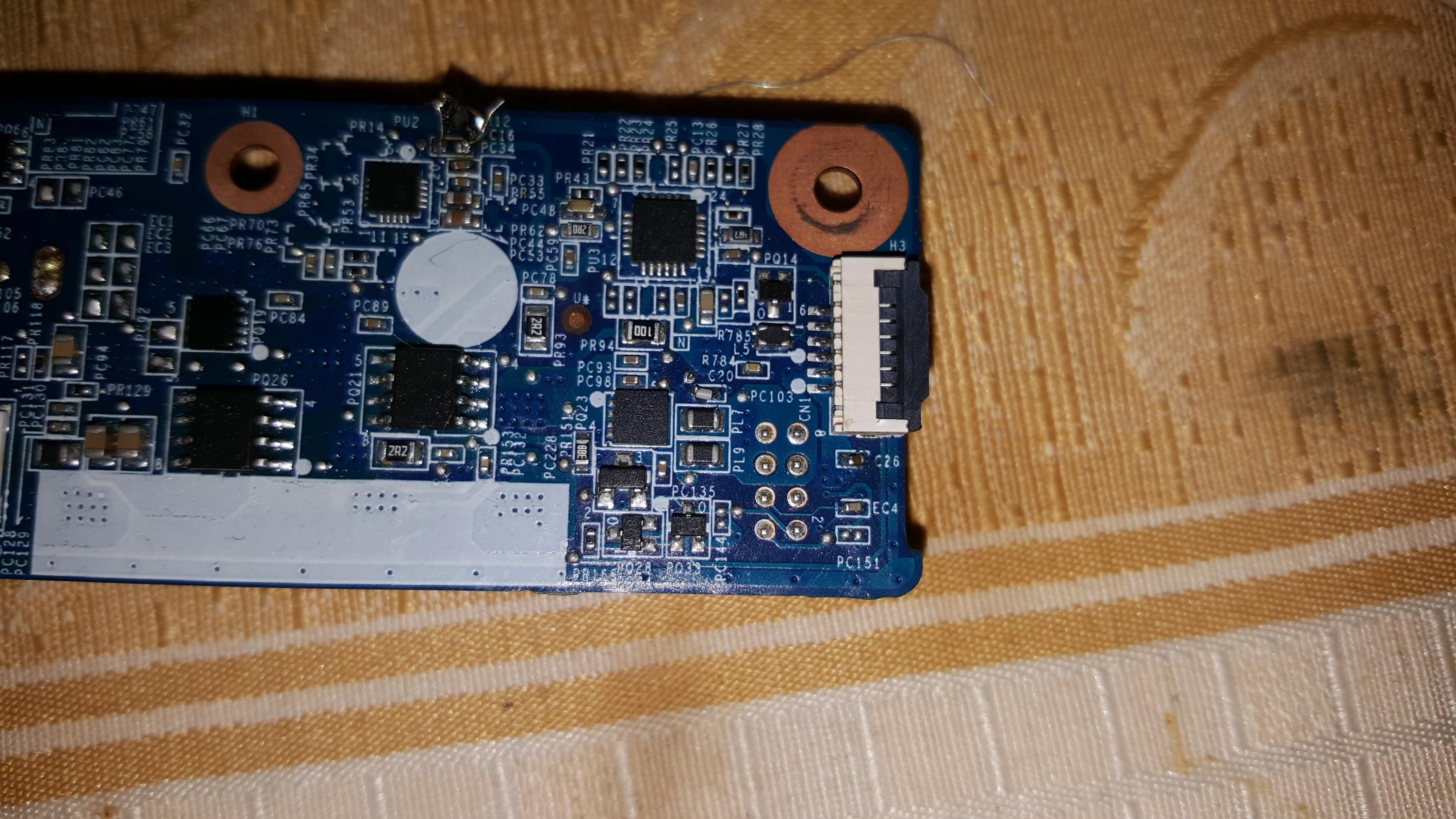

          #84
          Re: HP G6 DA0R13MB6E1 QUANTA R13 REV. E / No power, No LEDs...
          sorry for the bad welds but having the soldering iron with a big tip I can't do better ... sorry ... anyway I inserted the capacitors and a resistance with bigger dimensions not as a value but as a measure but as soon as I put the current it goes to smoke
          • KvnTM
            • May 2018
            • 434

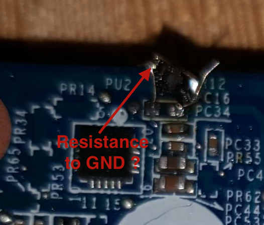

            #85
            I really hope that this is your personal laptop and please invest into a proper soldering station.
            Anyways.. Look at the image and measure resistance.

                #87
                C26 not on straight,EC4 end cap missing needs replacing,PC103 needs replacing, PC48 needs replacing . Do yourself a favour,buy another soldering iron or a smaller tip and some good quality flux, use lots of flux don`t be sparing with it.

                  #88
                  sorry you are right ... can you tell me the values of the capacitors to change in order to take them from another motherboard?

                    #89
                    c26 is not right in the sense I have to redirect it or is it upside down? ec4 do you think it is wrong and should it be changed? pc103 has already been changed but I thought the component was c20 and not pc103 putting a 220pF / 50v capacitor ... pc48 is shorted?

                        #91
                        I have done better the welds now the pubto of the resistance on the left + gnd brings me 150.5 and goes to increase I put the tester to 200k

                              #94
                              Unfortunately no
                              • KvnTM
                                • May 2018
                                • 434
                                #95
                                Unfortunately no
                                Ok..
                                Remove PC16 and try to power it up. If PR12 still smokes PU2 is most likely dead and needs to be replaced.

                                    #97
                                    ok ... i try and let you know....thanks
                                    Also measure voltage across the resistor. Put each probe on one side of PR12. Meter should be set to DC Volts.
                                    Do that while it is on of course.. Do it quick so it doesn't burn the board.

                                      #98
                                      ok ... I have to change the resistance first ... measuring before he smoked he took me with the rester in ohm 22.6 now smoking he brings me 00.1 or 00.2 so I think it must be changed ... I change it and then I measure the resistance again with volt cc
                                      • KvnTM
                                        • May 2018
                                        • 434
                                        #99
                                        Usually resistors fail open circuit. Are you sure that the resistor is 0Ohm? Desolder it and measure.

                                          #100
                                          I have just measured the resistance in volt cc without removing it and it brings me 023
