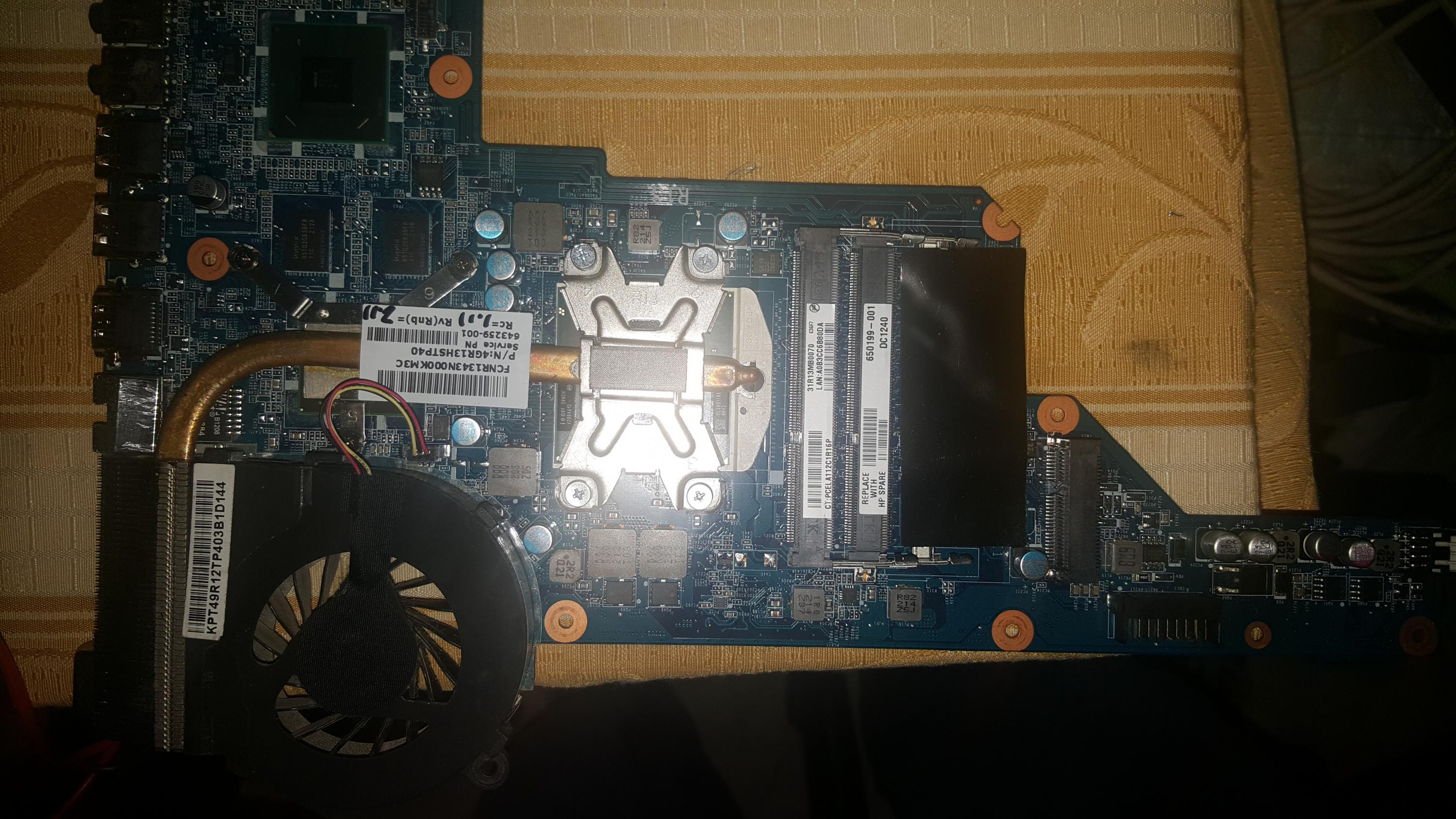

    Originally posted by antony.ag
    I have just measured the resistance in volt cc without removing it and it brings me 023
    023 what? Ohm, Volt, Amps, milli Ohm, milli Volt, .......
    You measured the resistance in volt cc? What do you mean?
    What do you mean with cc ?
    Did you mean: I measured the voltage across the resistor?
    Sorry but this is really hard to understand...

          #104
          Re: HP G6 DA0R13MB6E1 QUANTA R13 REV. E / No power, No LEDs...
          no no ... I took the values without unsoldering anything ... two seconds that I quit pc16

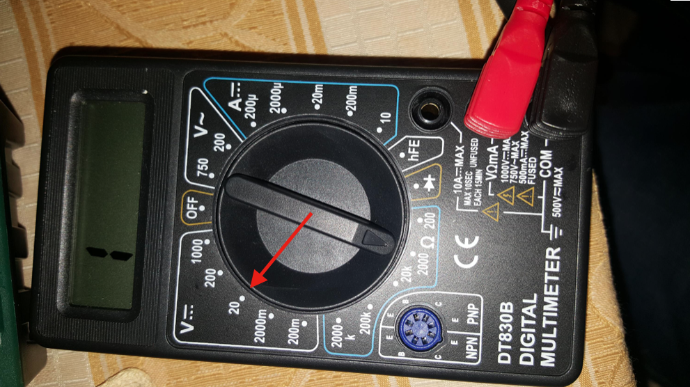

            #105
            After you removed PC16 and it still smokes set your meter like i marked in the picture and put the black probe on the left side of pr12 and the red probe on the right side of pr12. Now turn the board on and take a picture of your meter. The board has to be turned on while measuring! Do it quickly.

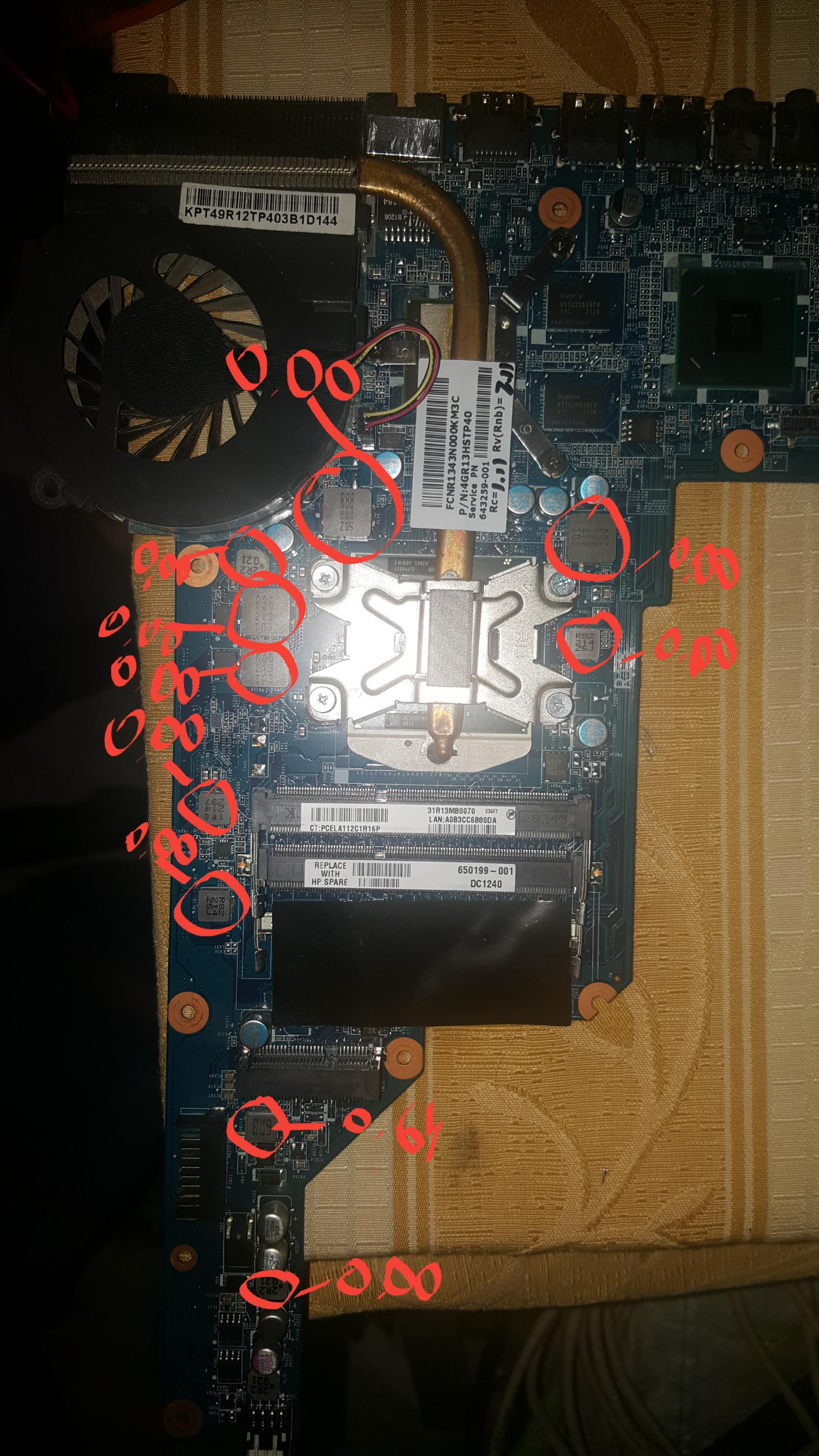

                        #111
                        nothing ... it's wrong ... now the led turns on the dc power but trying to turn it on nothing happens does not turn the fan and the pc does not turn on :-(
                        Alright.. Now you have to measure all power rails on this machine while it is on.
                        Put your black probe on gnd (a metal shield, screw hole, ..) and the red probe on one pad of the big grey squares with two contacts.
                        Do this for all big grey squares (aka Inductors). Take pictures of all points you measure and write your voltage readings into the picture so that i can understand it better.
                        The components (Inductors) that I am talking about look like this with different markings of course.
                        Put your meter to 20V DC. Like I illustrated a few posts above with the red arrow.

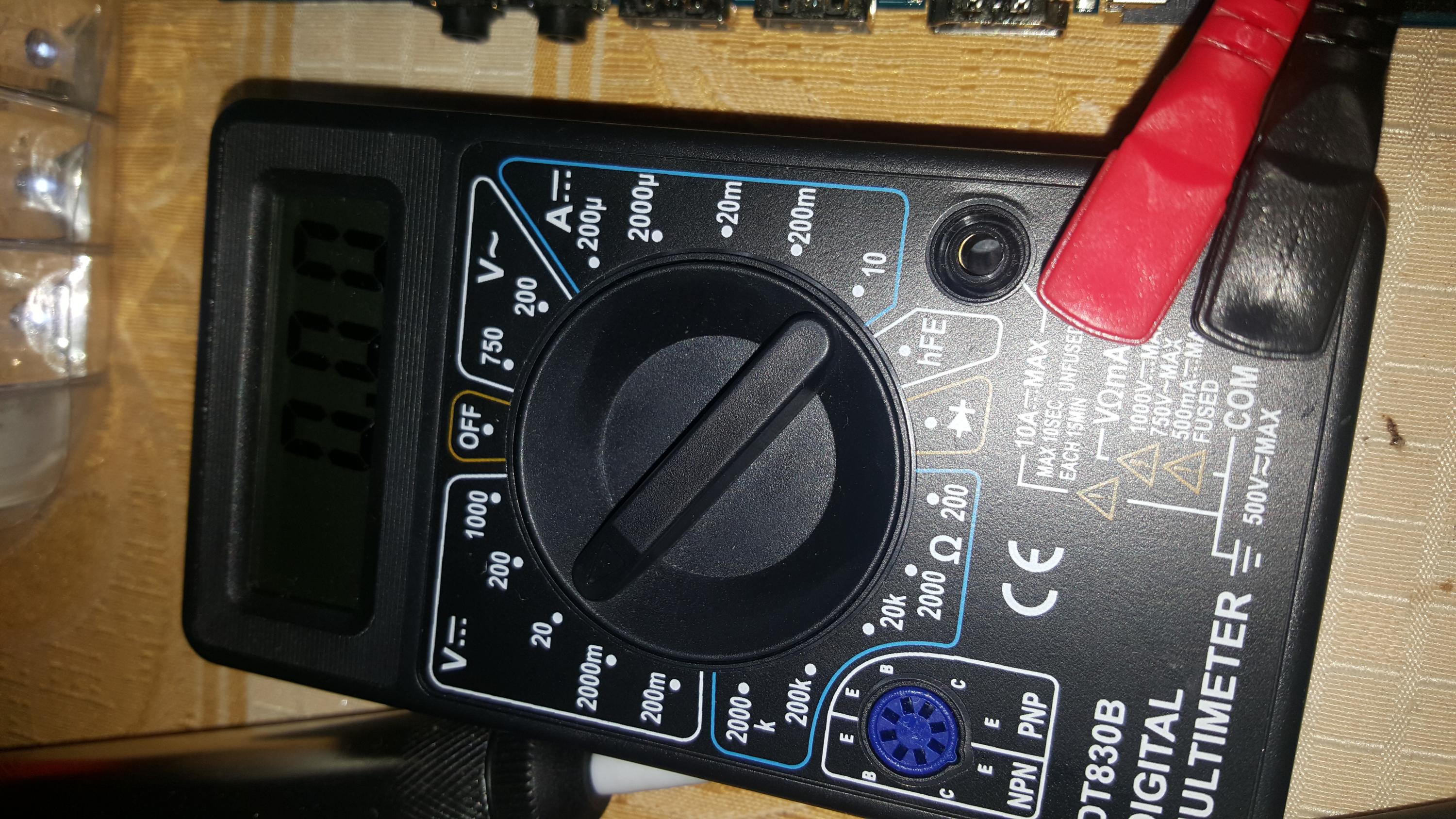

                          #112
                          I did as you told me but it gives me no value remains 0.00

                              #114
                              KvnTM sorry for the inconvenience ... I wanted to ask you how I could go on ... we solved the problem of resistance smoke and solved the problem of switching on the power led ... but the pc does not turn on ... I tried to do what you told me but it doesn't give me any value ... I have attached the photos in the previous posts ... what could I try?
                              • KvnTM
                                • May 2018
                                • 434
                                #115
                                It looks like as if you are not measuring on the actual contacts of the inductor. You obviously have to measure on the metal contacts of the part. Not on the case. They all have only two contacts. It doesn't really matter which one you measure.
                                Do this for all inductors on the board and attach the volt readings. And I mention it again: Do this while the board is on (power led on).
                                Is your meter set to 20V DC ? Like I showed in one picture before.

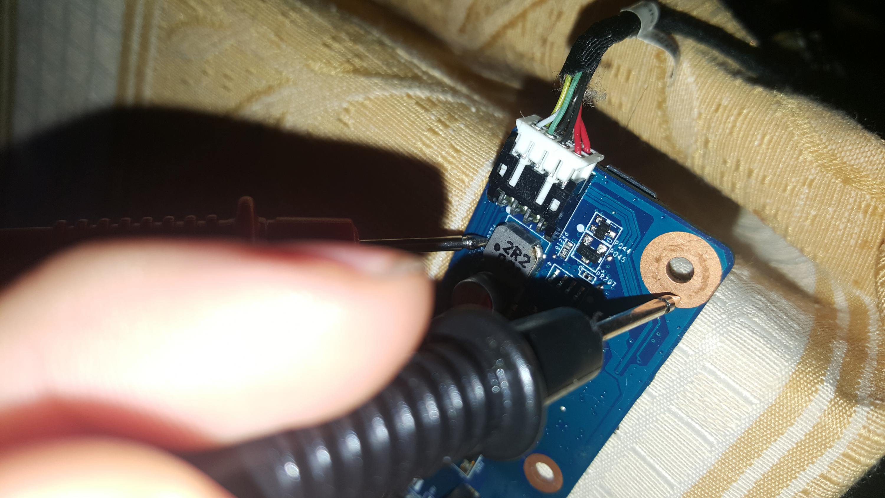

                                  #116
                                  yes I set the tester as you told me I have attached the photo and the inductor I measure it by touching with the red tip to one of the two metals of the inductor and the black on gnd or on the round of the screws ... I have also attached photos. .. I'm measuring it with the current or with the LED on

                                    #117
                                    Now do this with all inductors on the board. Would be nice if you include the part designator for each inductor. It starts with L or PL with a number after that.

                                      #118
                                      Pl19 only one component gives me a value of 0.64
