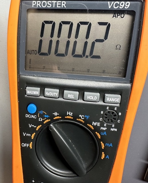

                    Can you share a pic of the front face of your meter? Wish to confirm that you are indeed in the low ohms scale. Both sides of the fuse are very low in resistance to ground.

                      No problem, hopefully this makes sense Click image for larger version

                        Very good. Make more sense with your shared pix. See the 2nd meter reading. There is a letter ‘M' which is for mega ohms and that is a lot of resistance. Like what my wife gives when I wish to buy a pricey toy. For logic boards this is good. So if you power up now, pin #1 to ground voltage should be stable and not cause any excessive heating because the heavy load of 5 ohms from the consumer side of this power rail is removed.
                        Most likely you have a shorted capacitor but is to be determined. It could be anywhere and we need to smoke it out by applying a voltage injection.
                        would you have an adjustable power supply? You will need one that can dial up 0v8 with support for 5A (amps) or more current. Amazon? Can return it if you don't need it.
                        with such a power supply, dial up 0v8 and apply onto pin #2 of the pcb pads. Start first with checking the voltage without the fuses on pin #1.
                        the power injection will cause the shorted part to heat up and eventually crack under pressure - like an interrogation.
                        ps: my analogy is bad here..but she is not reading this forum. Just know that mega ohms means no resistance to ground. Closer to 0 ohms is a short circuit and will draw heavy currents from the power supply isl9240’s mosfets.

                                    Wow. This may not have a happy ending. Can you post a pic of the meter face for the LA750 resistance measurement? So to confirm again, no power, meter in lowest resistance scale (if manual) with one meter probe on the F7000 or F7001 pin # 2 PCB pad (consumer side) and other probe on either side of LA750. The reported measurement implies that the high voltage from PPBUS_G3H has most likely travelled onto the PPSOC_S0_GPU power rail which has a typical voltage requirement of 0v9. If true, at the very least the GPU is dead. Many of the other measurements in the above list are similar.
                                    A good mosfet that is not defective will have a very high resistance as in hundreds of kohms or more. So the same comments on the other components showing a low resistance.
                                    For example, L7231 is linked to the regulator that powers the CPU. Such a low resistance means the same - the CPU is dead with such a transient.

                                      Yeah, I'm not optimistic on the outcome for this one but my silver lining is the "knowing" of what specifically has failed instead of where I normally stop, which is - the main logic board is bad. It's intriguing to dive deeper and see - well, what about the logic board is bad?
                                      Anyway, here's a shot of the meter for LA750 to F7000:2. Both sides of LA750 read the same.

                                        Yes, indeed is not good news. The high side mosfet (internal or external - varying with the regulator) has shorted and would have leaked the high voltage onto this low voltage rail which would most definitely kill the target low voltage devices.
