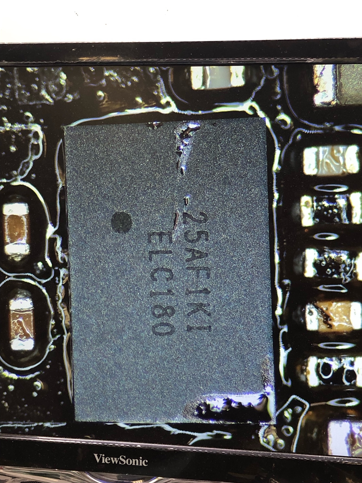

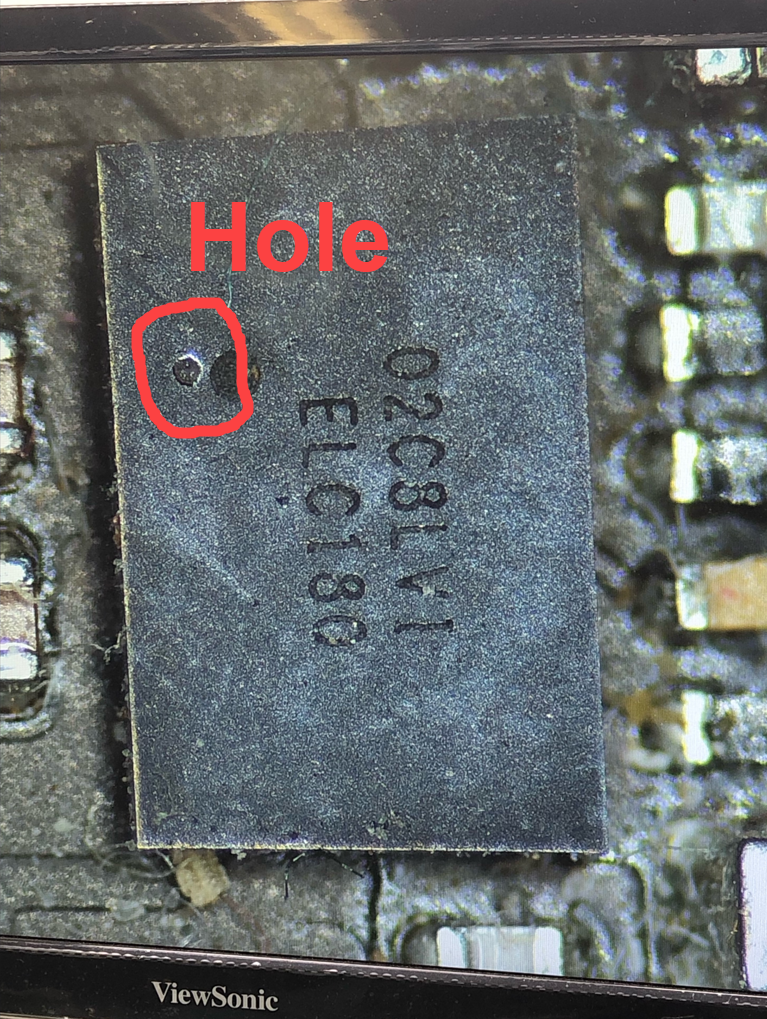

    d) Next, is the painful removal of the logic board process. Once the board was dismantled from the (abused) enclosure - observed the regulator for this SSD as follows:
    The SSD0 power rail has a normal resistance of ~57R ohms to ground. For this reason, still worth the effort to replace this common point of failure regulator from TI. Part can be sourced from Digikey / Mouser / Aliexpress (suggest in this order). Our DK package is lost in transit but expect it to arrive tomorrow(?). Will update this thread after the surgery.

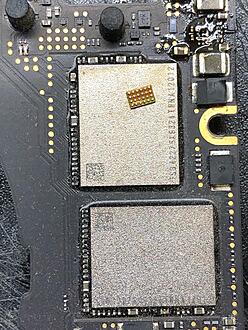

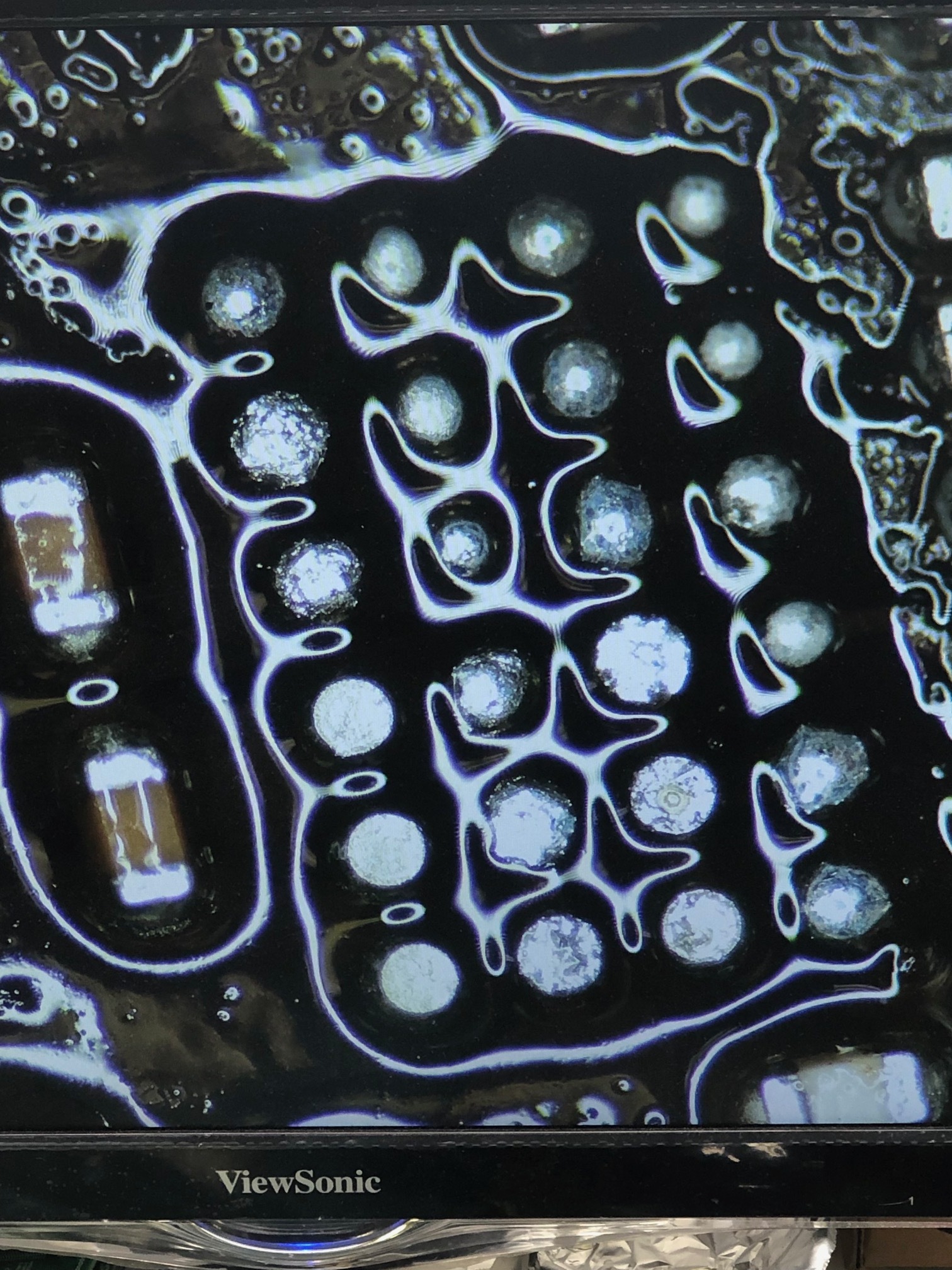

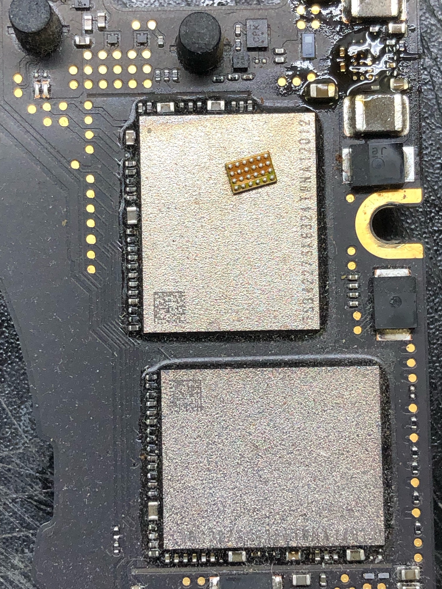

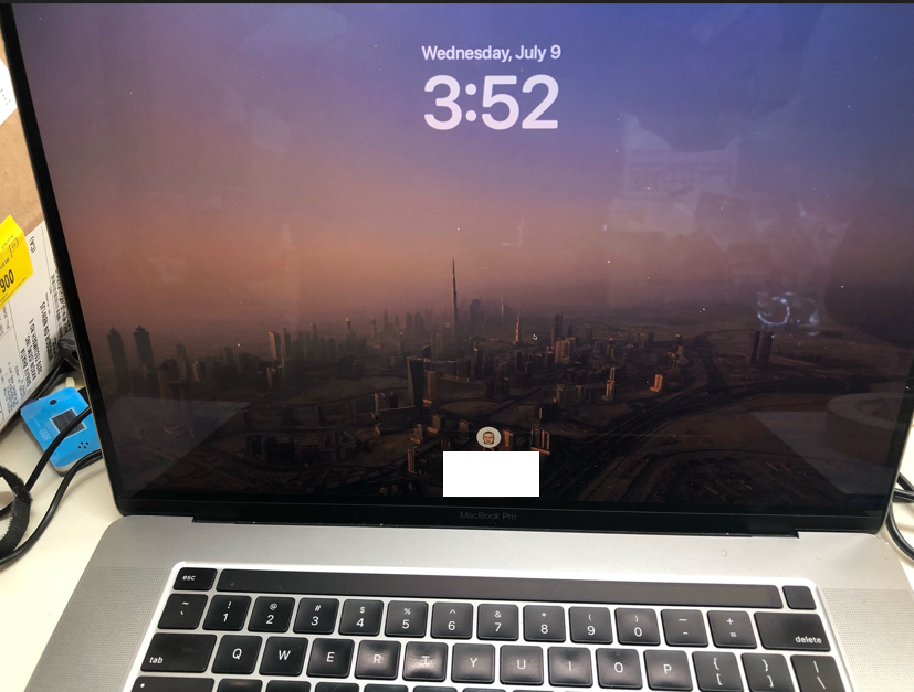

    Updated pics.
    This unit had a defective SSD0 power rail which usually means that the TPS62180 is defective. This was confirmed. However, the PPBUS_G3H rail was in the normal range and not shorted. For this reason, we proceeded to just replace the defective regulator. Unit was repaired after this replacement.
    High heat (Best 863 @ 550C dial + low air pressur @ 30) - worked very well to remove and replace this tiny WLCSP component without disturbing the nearby components.
    Summary: Do not give up on this motherboard as you may find the SSD is still alive.
