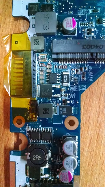

I flashed both BIOS & EC chips and I got the following readings (check attachment).
DA0AX1MB6H1 (HP G62-358CA) - Does not turn on & Adapter Led light off when plugged

I got 0V, what do you think I should test next?Comment
Re: DA0AX1MB6H1 (HP G62-358CA) - Does not turn on & Adapter Led light off when plugge
check PL11 and PL1
here is schematic (page 25)...the quieter you become the more you are able to hear...Comment

Hello, this board is Rev H, in the schematic you linked me to, the DC CN is 16, the board I'm working with is CN17.
The reading of PU6 (ISL6251A, it's only 24 pins) are:
1: 5V
3: 1.18V
4: 4.5V
6: 0V
7: 0V
14: 0V
19: 0V
27: does not exist
While testing PU6, parts around were getting hot, should I keep testing it and trace the touch?
I can't find PL11 and PL1, but I think they are the inductors I tested previously. Any ideas guys?Last edited by orientalsniper; 01-19-2014, 11:52 AM.Comment

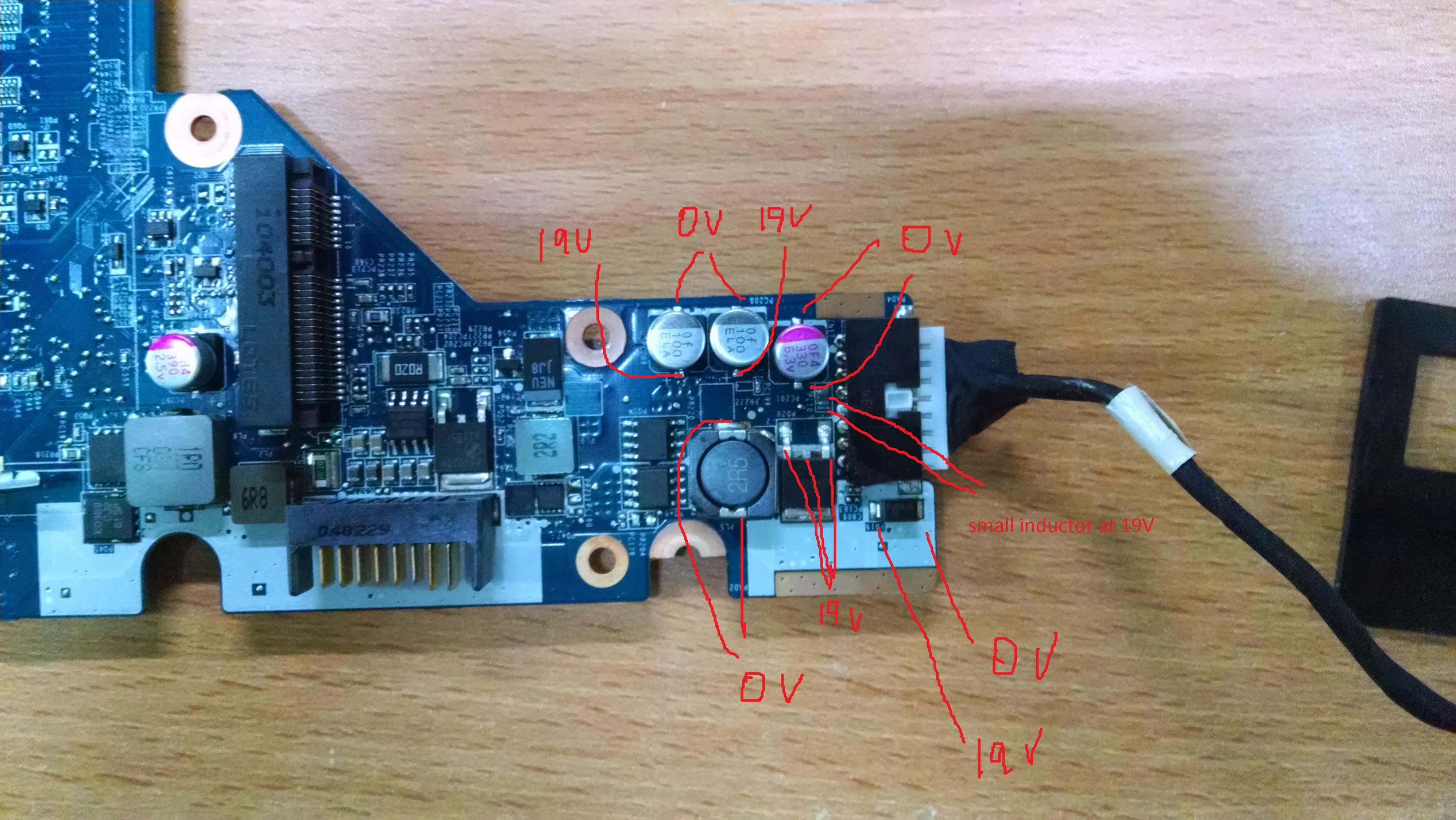

Is it normal I'm getting 28V in a capacitor (PC69)? Close to PU2 which is a G5933, not a RT8209A, according to the old revision schematic.
Every other resistor and capacitor voltages close to PU2 are jumping.
EDIT: After replugging DC cord, PC69 still gets 28V, and the rest close to PU2 are reading steady 19V, no longer jumping.Last edited by orientalsniper; 01-19-2014, 11:25 AM.Comment
I am refering to RT8206B. The 28v you mentioned is normal. If you have 28v at the gate pin of the mosfet, then you should have around 19v at PWRSRC.Comment

Hello guy, thanks for the assistance, I don't have any readings (0V) in RT8206B or the pins connectors in the battery terminal.
Edit: Also, bluestone, you should try reflashing BIOS and EC, some people reported they got it working.Comment
If you dont get any voltages at RT8206B, then focus your attention to ISL6251A pin 1, 2, 3, 8, 15, 24.Last edited by whaldsz; 01-20-2014, 06:27 PM.Comment
2: Jumping up to 0.5V
3: Jumping up to 1V
8: 2.3V
15: 5V
24:Jumping up to 18V
Can you please tell me how do you know which pins to test?Last edited by orientalsniper; 01-21-2014, 09:28 AM.Comment
