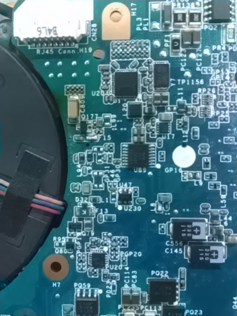

            Re: VPCCA290X (MBX-239) No backlight in LED screen
            why did you not post some macro pics?

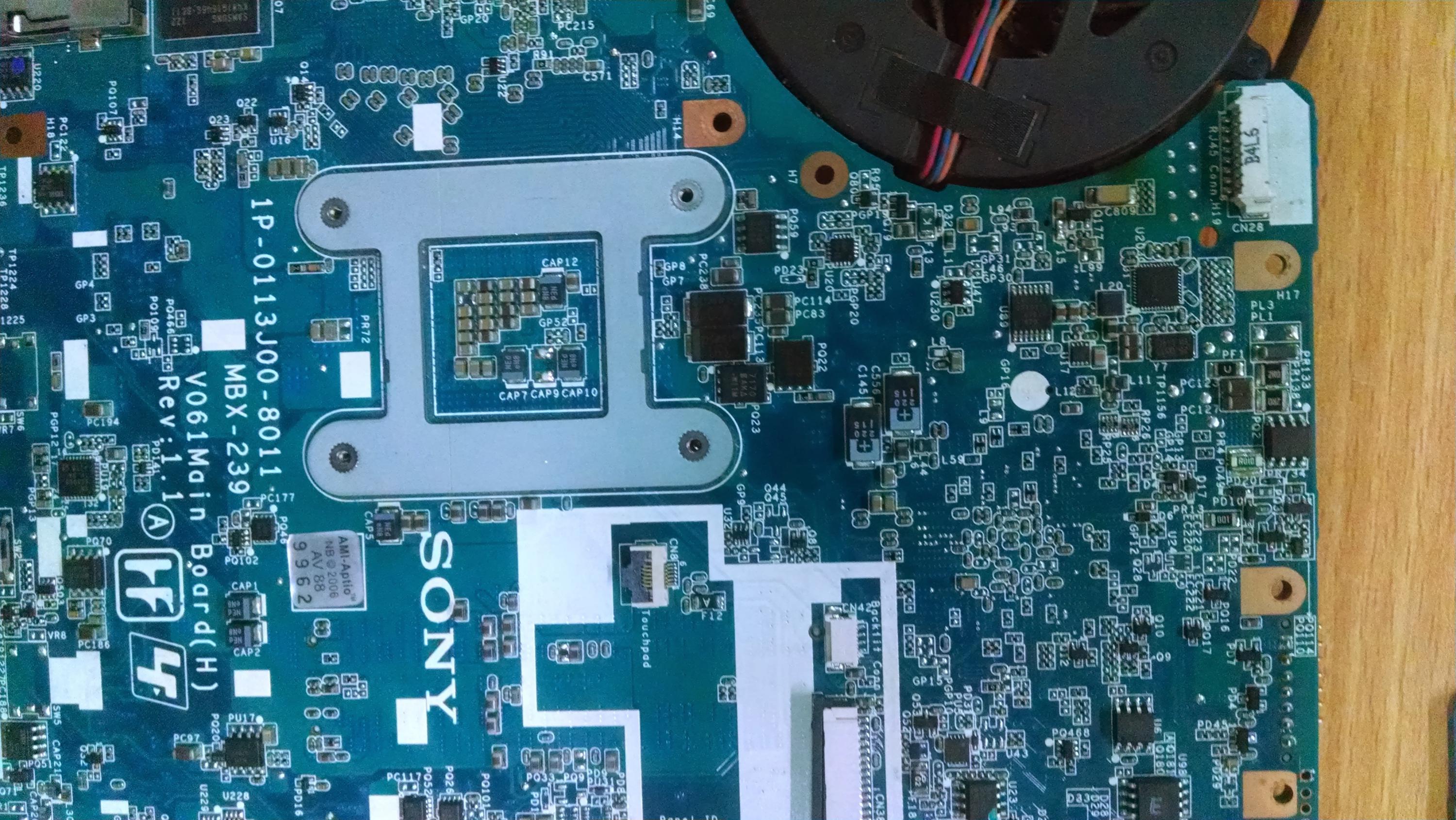

                Here you go, check attachment.
                • orientalsniper
                  • Apr 2013
                  • 459
                  I think this one looks better.
                    So I was measuring voltages to everything around that fuse and everything had a reading except that big capacitor (C809), besides finding a similar one (how can I tell besides the sizing?), how can I test that capacitor? It's seems to be a 4520.
