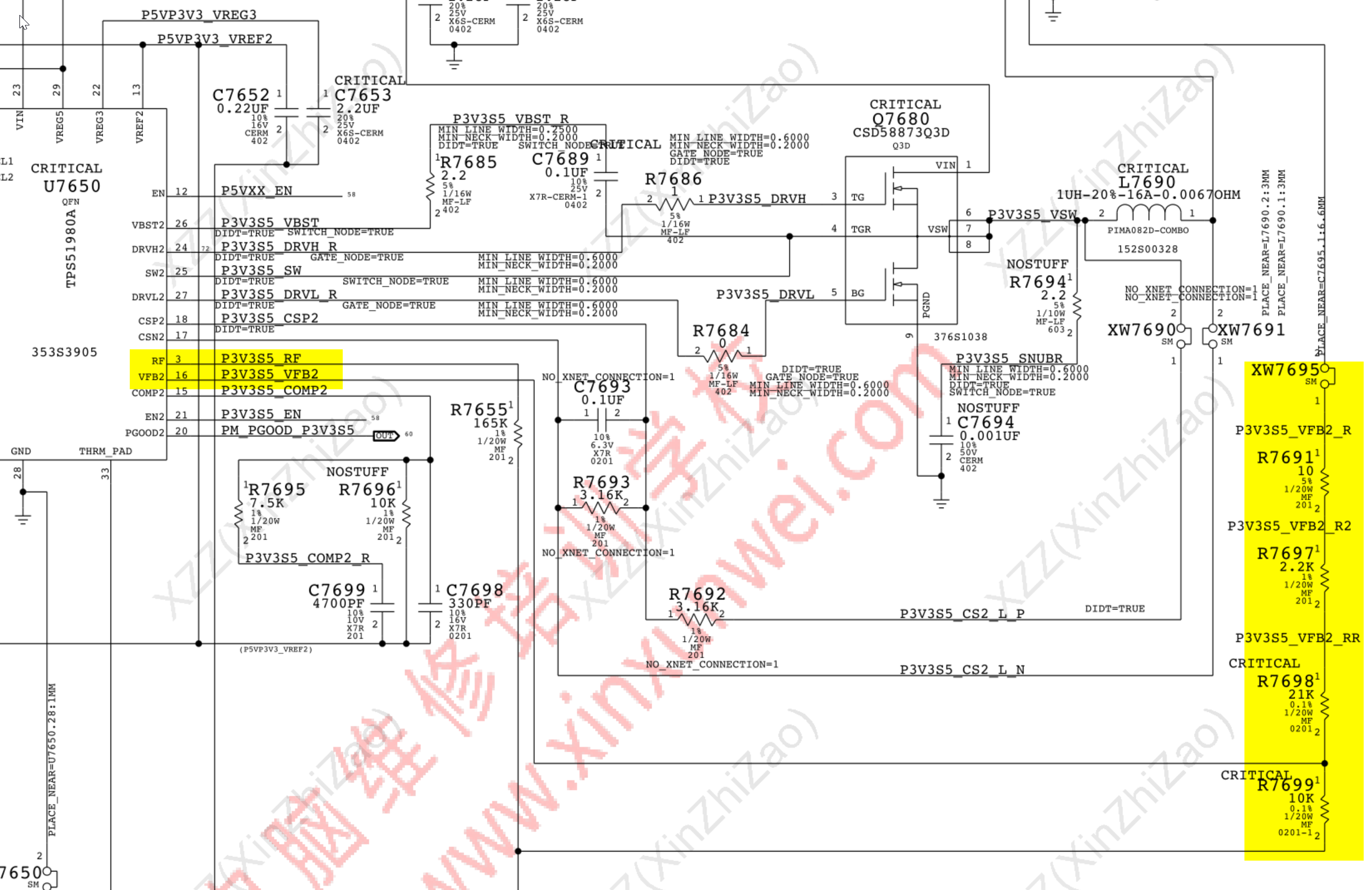

    Hi
    I need help on an Apple 820-00875-A board, it doesn't turn on and I noticed that the voltage fluctuates from 0V to 3.3V on the PP3V3_S5 line. If I inject 3.3v (with the board powering and the coil isolated from the generator) the consumption is 8 mA.

    Carefully review the voltage to ground of P3V3S5_EN @ pin 21 on U7650. What is the measurement?
    With the low current on the downstream / consumer side of the power rail, there is no short on that section.
    Remove all power. Meter in resistance mode. What is the resistance to ground @ L7690 (best to check each of the PCB pads for this component)?
    Next, meter in resistance scale. With no power to the board, measure the resistance between pins 17 & 18 on U7650. You are checking the resistance of the current loop path (CSP2 & CSN2). Post each measurement.

        The high resistance to ground on L7690 pads confirms there is no short on these rails.
        The current sense loop resistance looks to be ok since R7693 and R7692 are in parallel. Both being 3k16 => should be 1580 ohms between pins 17 & 18. As a double check, confirm the resistance between pin 18 on the IC and the PCB pad # 2 of L7690. This should be ~3k16 ohms. No power during these resistance checks.
        Interested in a few other resistance checks for this regulator.
        No power -> meter in resistance mode.
        1) One meter probe on L7690, pin #1 pcb pad (PP3V3_S5). Other meter probe @ pin 16 of U7650 (VFB2). What is the resistance ?
        2) One meter probe on L7690, pin #1 pcb pad (PP3V3_S5). Other meter probe @ pin 3 of U7650 (RF). What is the resistance ?​
        Next, confirm the voltage to ground of the enable pin of this regulator @ pin # 21 (P3V3S5_EN).
        It is possible that U7650 (TPS51980A) is defective. Louis mentions this fault often in his YT videos.

          Thanks for your help, from what I understand u7650 goes on off, the only stable voltage is pin 21 P3V3S5_EN while all the other signals fluctuate. PP5V_S4 is not present. With pad 1 of L7690 disconnected the P3V3S5_EN voltage is present so there is probably a feedback signal which fluctuates and has repercussions on the chip itself since if the chip were to go into protection it would become hot,, I don't know how correct an idea is. I see a pgood signal but it refers to PP5V_S4
          R7693 -> 3.156K
          R7692 -> 3.147K
          U7650 PIN 18
          L7690 PAD 02 PAD1 DISCONNECTED
          RES 3.156K
          U7650 PIN 18
          L7690 PAD 02 PAD1 CONNECTED
          RES 1.571K
          U7650 PIN 17
          U7650 PIN 18
          RES 1.571K
          L7690 PAD 01
          U7650 PIN 16
          RES 13K
          L7690 PAD 01
          U7650 PIN 03
          RES 180K
          L7690 PAD 01
          GND
          RES 1.6M​
