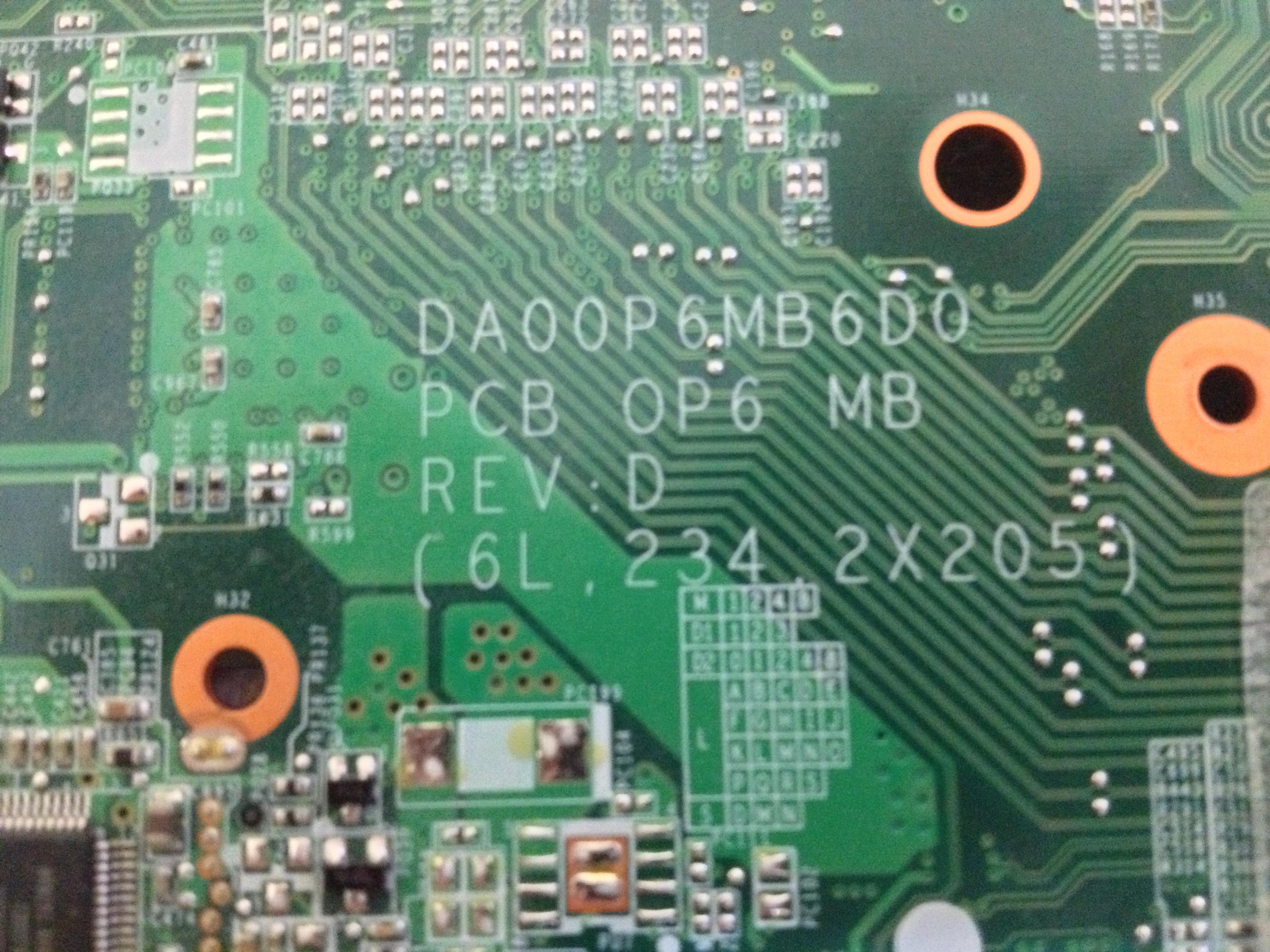

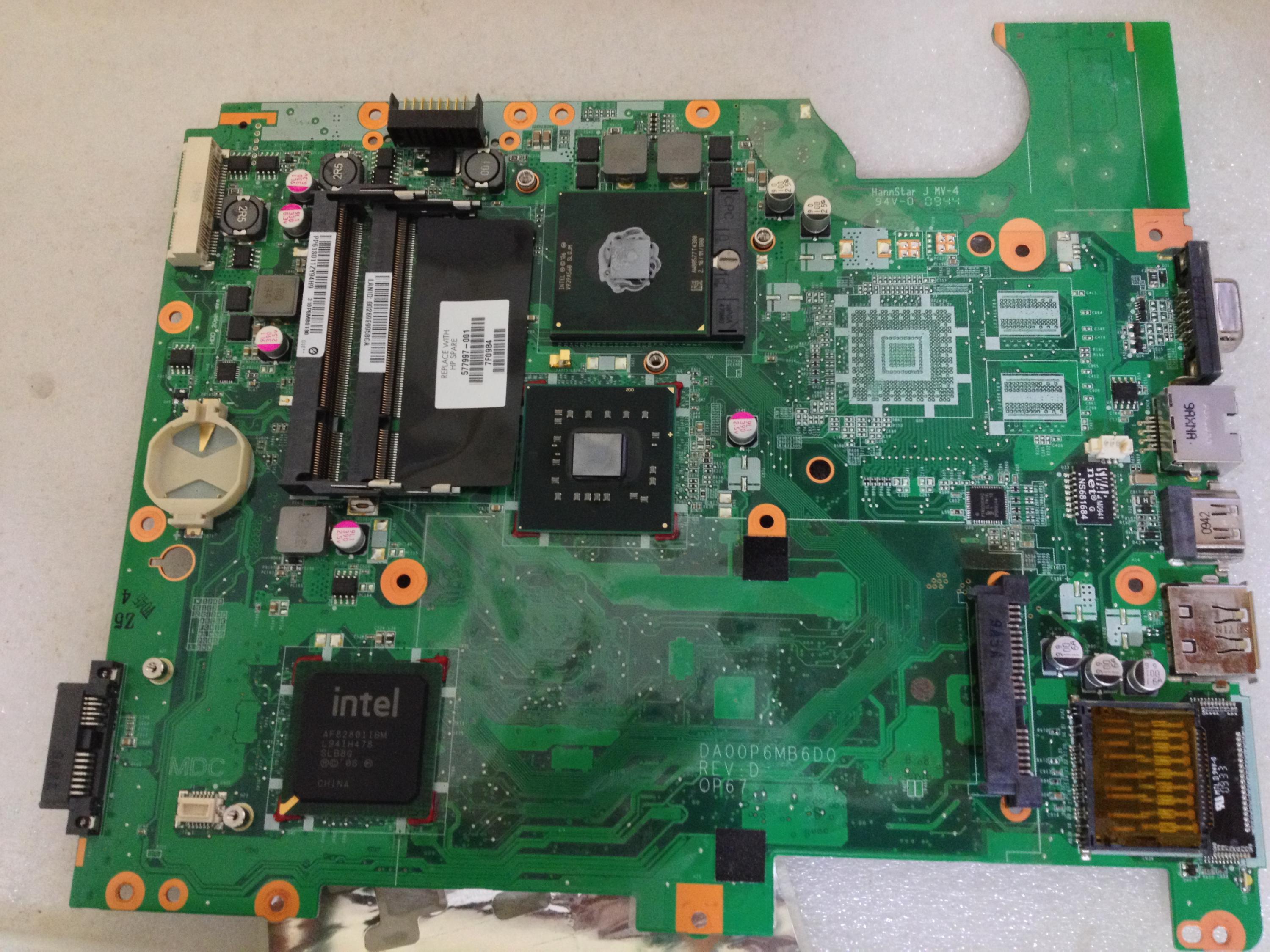

    Hey guys,

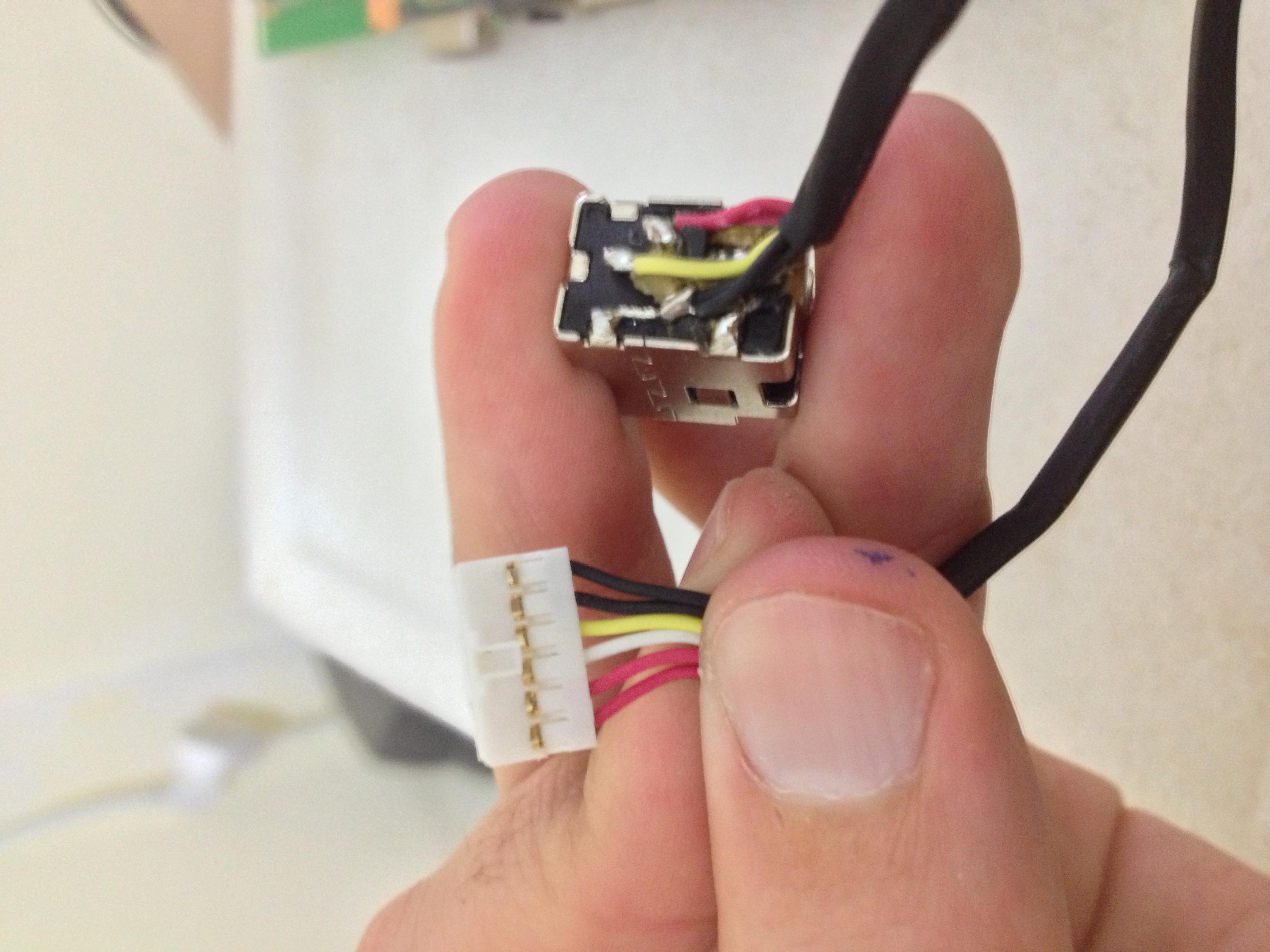

    got this laptop, with bad contacts on DC jack (didnt power at all finally)
    found some corrosion both on charger connector and dc jack (comes with harness of 6 pins).
    cleaned them both but with no power at all,
    the led on the jack wont ever light.
    tested voltages on ouput pins:
    2 blacks are shorted
    2 reds are shorted
    between yellow to black 18.22v
    between yellow to red 17.55v
    between yellow to white 15.95v
    the specs on charger shows 18.5v 3.5a
    so i figured the charger and harness are OK,
    when the harness is connected got almost nothing on the outputs.

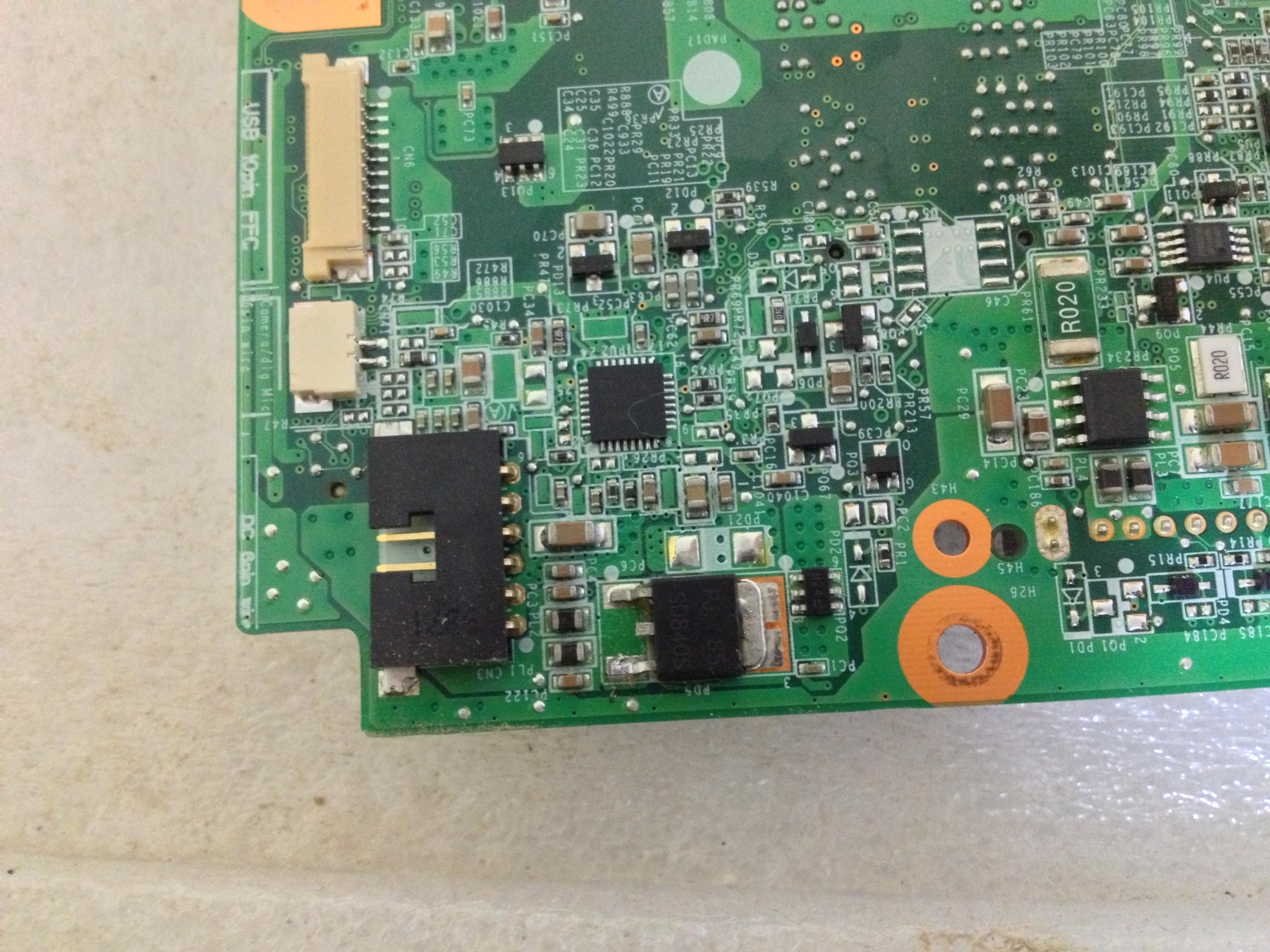

    i saw this chip confused to be mosfet SD840S
    but by the datasheet its a 2 diode form.
    tested between too legs got short,
    lifted one leg but still got short bewteen pads,
    now between two legs got nothing, so im gussing its fine.
    im pretty cluless right now. so any help will be very appriciated.
    Shai.

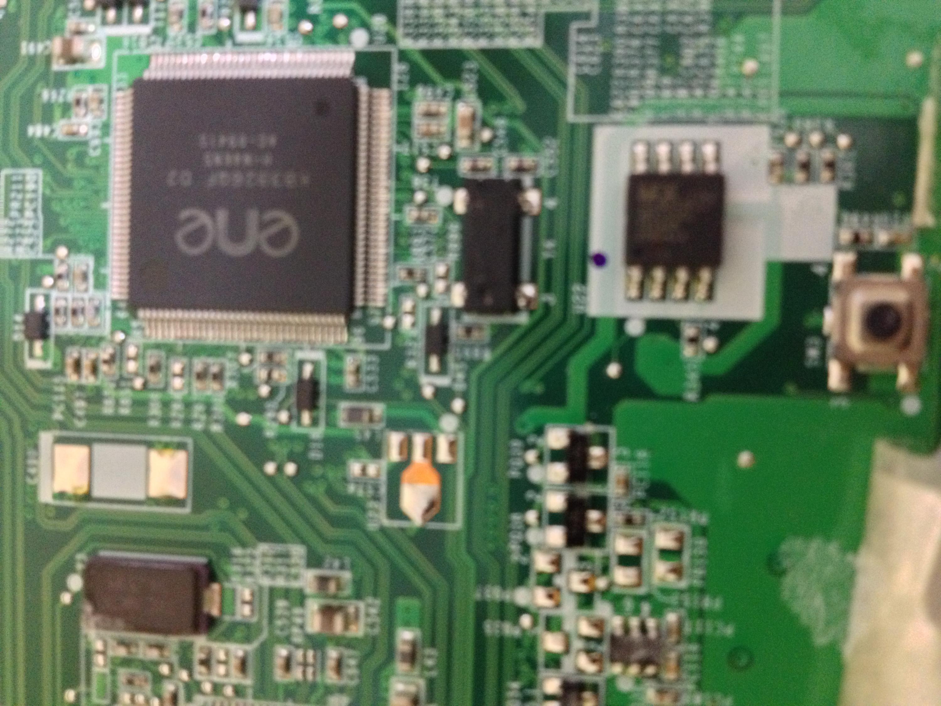

    unsolder the bios and see if the light from the power jack its restored.
    the board its like g61 like a mirror.
    i ahd a problem like that and usually 90% got bios problem.
    don`t ask me why but i manage to find the problems here on the forum.
      Re: CQ61-310EJ No Power
      hey dj_ricoh,
      thanks for the reply,
      i tried removing the bios chip
      but still got no power dc jack led didn't came on.
      any more ideas before ordering a replacement board?
        download schematic of this mobo first and check signals on bios and ene chip to confirm if its bios issue.

          i ruled out the bios chip, i still got a short between 2 pads of the sd804s
          and a major voltage drop when the bios chip was out.
          im gussing something else failed,
          using a schematic would help, il try to find one but so far no luck...

                  im starting to think that the charger is BAD,
                  between outer circle (-) and center pin(+) i get 17.52v
                  between inner circle (-) and center pin(+) i get 17.35v
                  between outer circle (-) and inner circle(+) i get 0.076v
                  is this reasonable?
                  i got today a hp probook with charging problems
                  (wont charge the baterry, replaced to new original battery but won't charge)
                  it has a universal charger
                  between outer circle and center pin i get 0
                  between outer circle (-) and inner circle(+) i get 19.37v
                  so i tested the CQ61 with the universal adaptor there is a light for 3 secs on dc jack.
                  i think that both of them are faulty.
                  please HELP!
                    The outer circle is GND
                    Inner circle is +V
                    Center pin is ID (when not connected shows about +V, when connected to mainboard, should be 7-8 V)
                    When ID voltage is less, machine won't turn on.
                    You can emulate a smart adapter by connecting a resistor of ~200kOhm from V+ to ID pin.

                        usually i`ll start with bios.
                        i`ll see tomorrow if i got a dump file so you can reprogram and test it.
