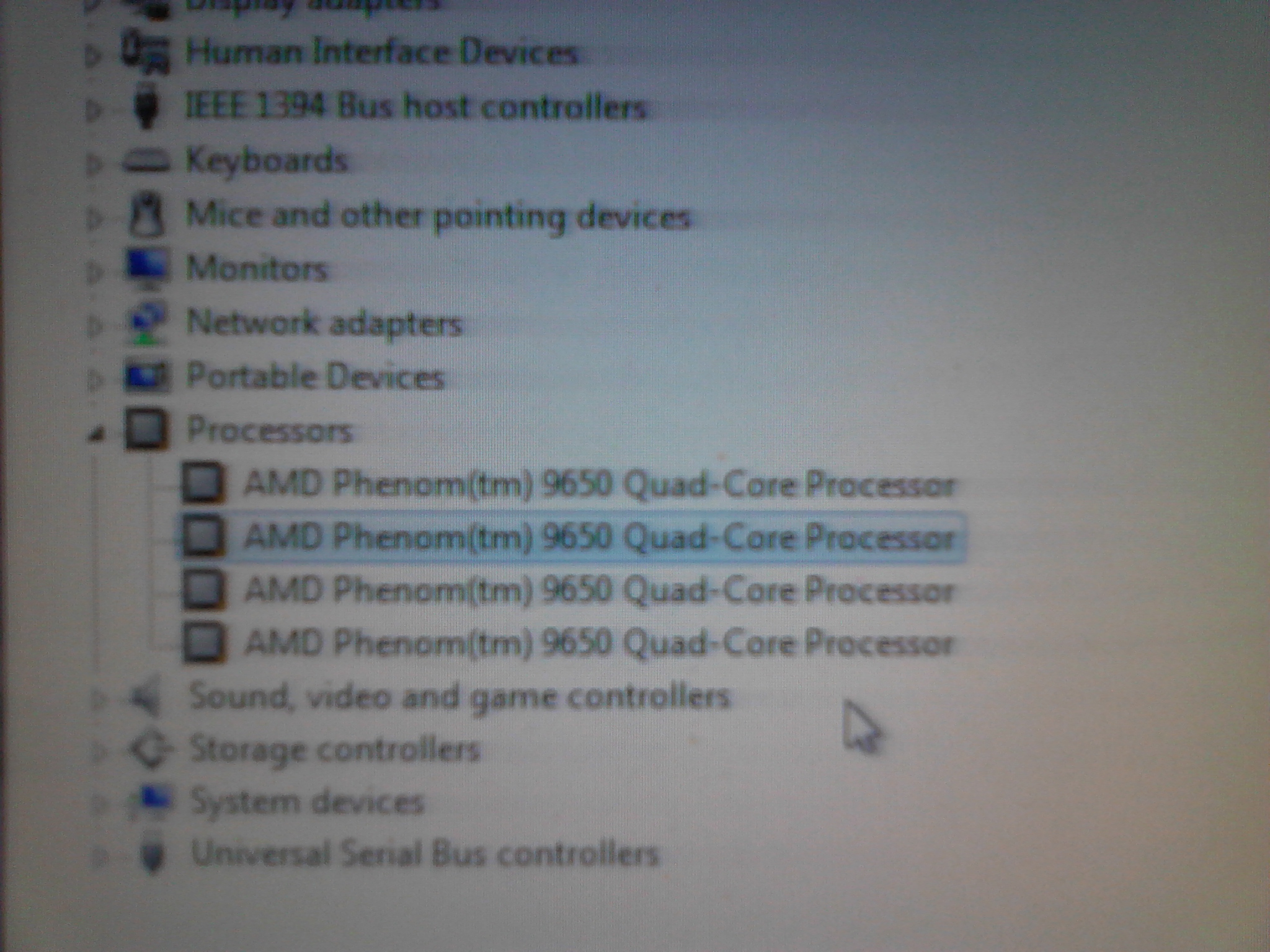

                      Re: How to replace nec/tokin OE128 in laptop motherboard?
                      Every notebook that has a Tokin cap has core2duo or x2 and CPU or dual core CPU.
                      In device manager on CPU section you need to disable on core.
                      Sry for the bad quality the tablet got a c***p camera

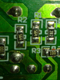

                                    I found some old PCBs. From where I found a capacitor. There is only written 330. I dont know how to find that it is 330uF and 2.5v because there is no written uF and voltages on it. And it is different in shape from above pic of innocentforeign.
                                    Please mention me.
                                    I attach the pic of it.
                                    • spleenharvester
                                      • Mar 2010
                                      • 921
                                      Originally posted by subXT
                                      If you mean the solder strips left from the NEC/Tokin cap, I managed to peel these off the PCB solder pads using a small sharp flat blade jeweller’s screwdriver. Prior to attempting this I removed as much solder as I could with a solder wick.
                                      I’ve only done one of these 0E128 repairs so I may have struck an easy one.
                                      Lucky haha! I wouldn't want to risk doing that though in case it lifted the PCB with it.
                                      Originally posted by hitmen
                                      Thanks all.
                                      Please mention me.
                                      [IMG]http://i.imgur.com/wkwZKxS.jpg[IMG]
                                      Nah that's not the right one matey I guarantee you. Buy yourself a cheap faulty HP 6735s motherboard or something similar with the tantalum caps shown earlier in the thread attached. Plenty of Socket S1G1/S1G2/C2D boards have 4 of these right by the CPU socket. If you're stuck for the money to buy new caps, you can just lift these ones off.
