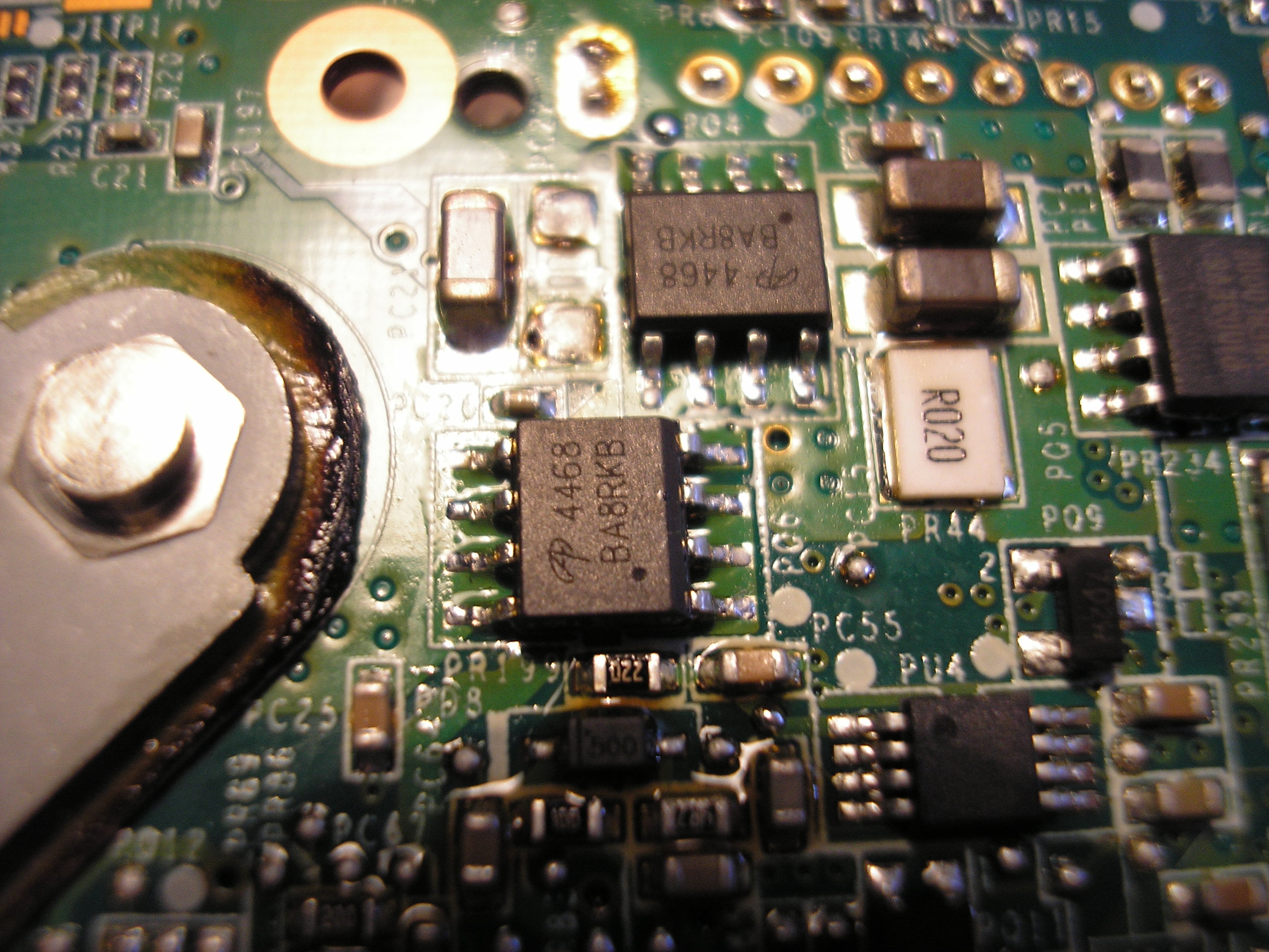

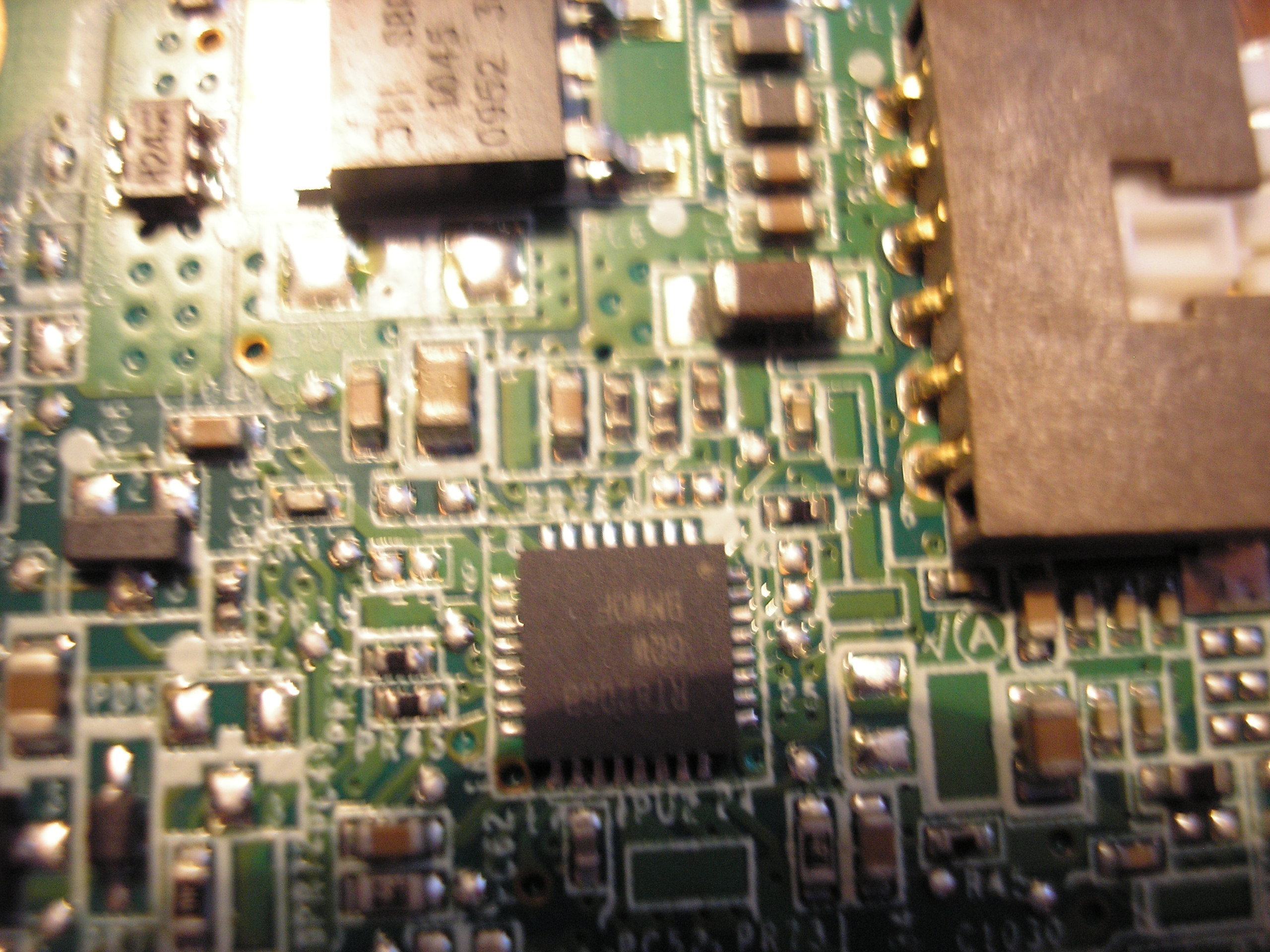

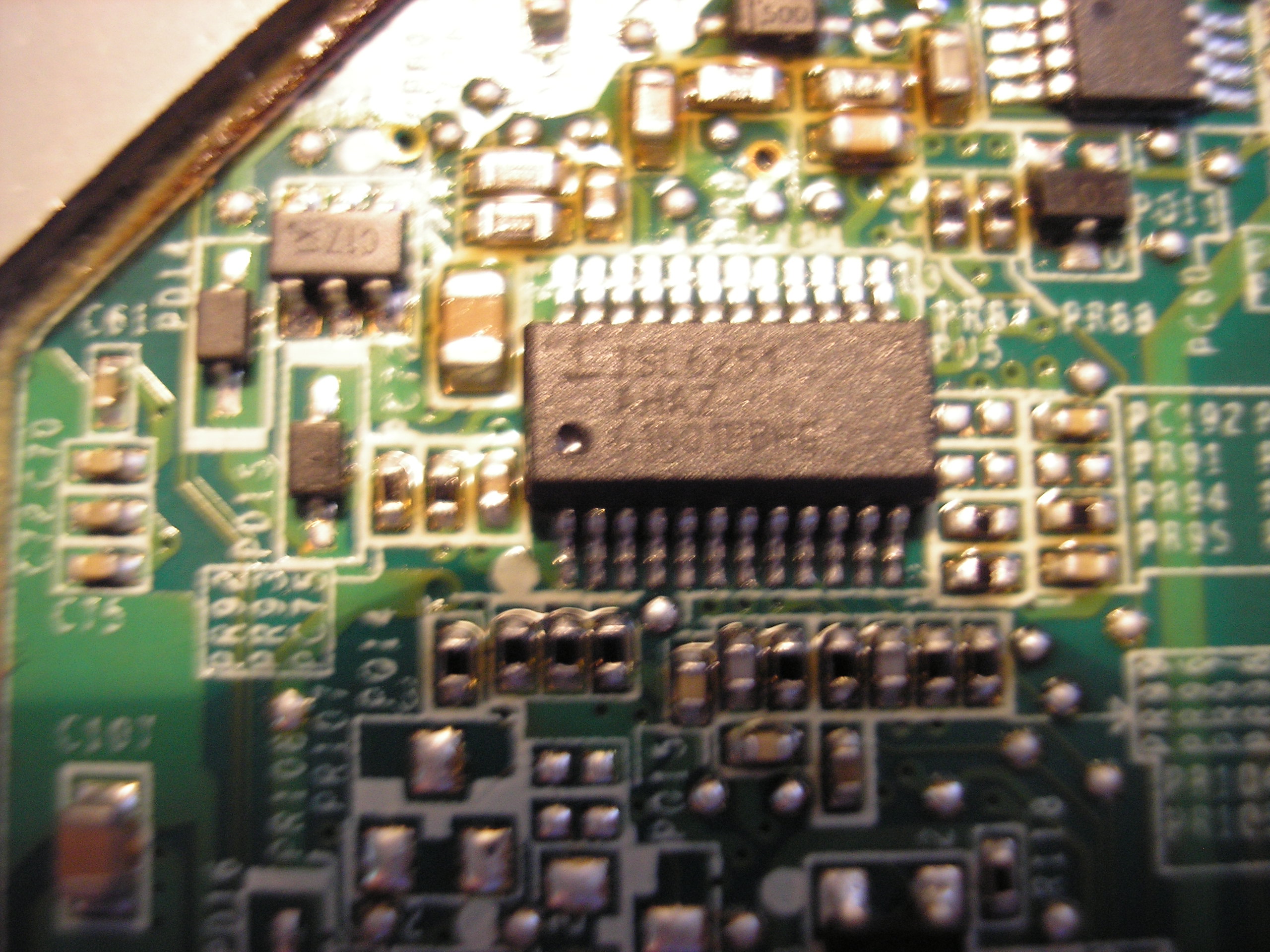

    Hi guys..
    The power light of this notebook goes out after 5 seconds.
    Already replaced ISL6251 and PQ6/PQ4 fet´s..
    I´m out of ideias.. Anyone helps?
    Thanks in advance

      Re: Hp G61 Power Light goes off after 5 seconds
      I didnt reflowed the GPU yet.. But i can do a reball..
      But there´s another issue..
      With the ac adapter plugged in i get 0.63v on pin1 of pq4/pq6, but if i plug the adapter off and measure again very quickly i get 5v dropping to 0 very slowly...
      That´s odd isn´t it? :/
                        I have solved this problem before and it was a bios problem, try to flash the bios using the usb method if it doesn't work then you should replace your bios chip.
                        • rmps
                          • Oct 2009
                          • 82
                          It was in fact the bios chip. Replaced and it works fine.
                          Problem solved!
