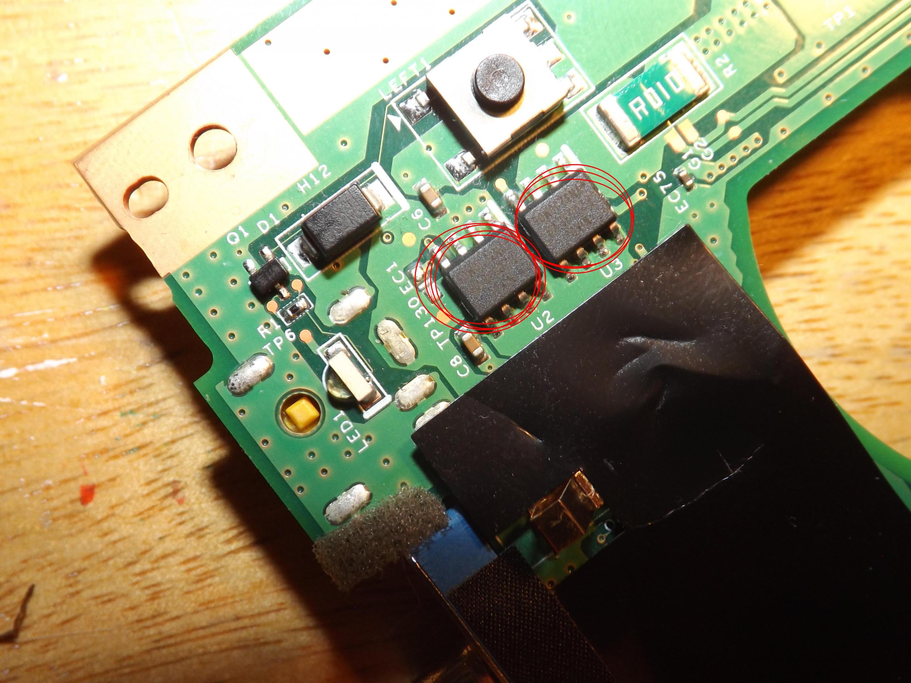

                  here is a picture as requested
                  the 2 red ringed ic are getting very hot when power supply is added
                  board is empty nothing attached like cpu , memory nothing
                  there marked u2 and u3 dose anyone have any idea what there used for and can this ic cause a short ..... i.e flashing power supply on and off
                  think there called mosfet but have no idea as cant see the print on the ic
                  anyone have a idea what thay are called and will that cause this problem

                    They look like mosfets - we will need to know the part number off them to check.
                    The smaller black rectangular component at D1 is a diode and q1 looks like a small switching transistor ( What is its part number)
                    The diode you can test - NO Power to the board meter on ohms 2000 test with leads on one way and record the result then swap the leads over and record the result.
                    If your meter has Diode test you can do the same test using that - tell us which you have done. I am shutting off now but its soon evening in the US.

                      Re: acer 2920 blinking power source
                      ok when are you back online as i really need to get this sorted
                      is on the mofsets
                      p2003evg

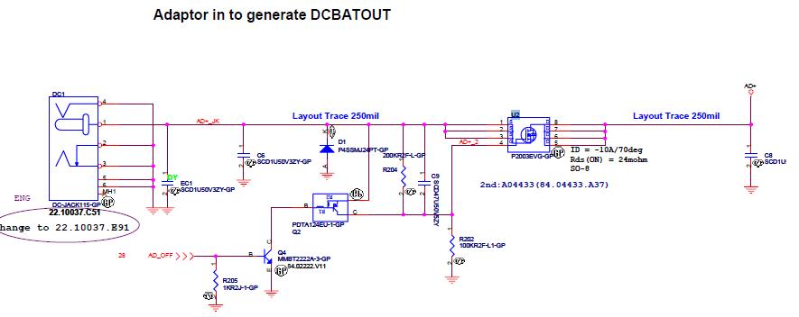

                          i found this too is a schematic for my noard is anyone can help me out
                            but i see U2 in there but no U3 would i have to repace both of these as thay both are getting very hot

                                  • england
                                  ok as advised i removed U2 and now there power getting in to the board 19v so i just need to replace that any idea where i can get one or can i get one from a old laptop as there no stock based in the uk

                                    hello
                                    that U2 its a P-Channel transistor 30v from that schematics you putt here.
                                    but the schematics did not show the u3.
                                    you can search the web for similar transistor from another motherboard and replace it but you need to put the same.
