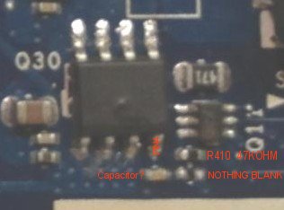

            I think the 200K is not 200K but 260K, but you already found the 47K resistor which is more important, it is the resistor at the bottom right of Q30 by pin 4 that you found, right?

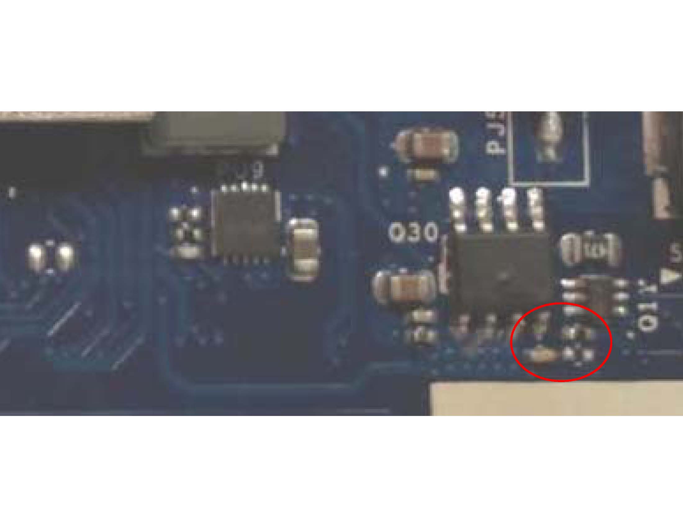

              Re: Toshiba A665 blown MOSFET
              In the picture, It's the black component to the right of PIN4 Q30 and just below PIN3 of Q11
              If I understand correctly, I just need to replace the Q11 at this point, correct?

                #67
                These resistors in circle, right?

                    Bud: I attached a picture of the R410 resistor area. Below the resistor it's a blank (nothing there, just two solder points). The item to the left is what appears to be a cap.

                      That is good that it is 47K, you are safe to install new Q11. We are almost done!
