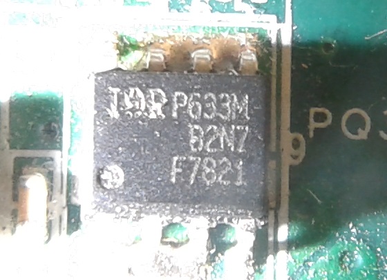

                        This was the only post about this model so I am sending my request here.
                        First of all, does someone know where I can get the schematics for this laptop? Latitude D520
                        Moreover, this is the part I need to clarify what exactly is in order to buy and replace it. I am attaching a photo.
                        Thanks in advance all!

                          Originally posted by mpikou
                          Greetings,
                          looks like this could be the one, https://cdn.badcaps-static.com/pdfs/...88cf177dc8.pdf
                          they have them on ebay
