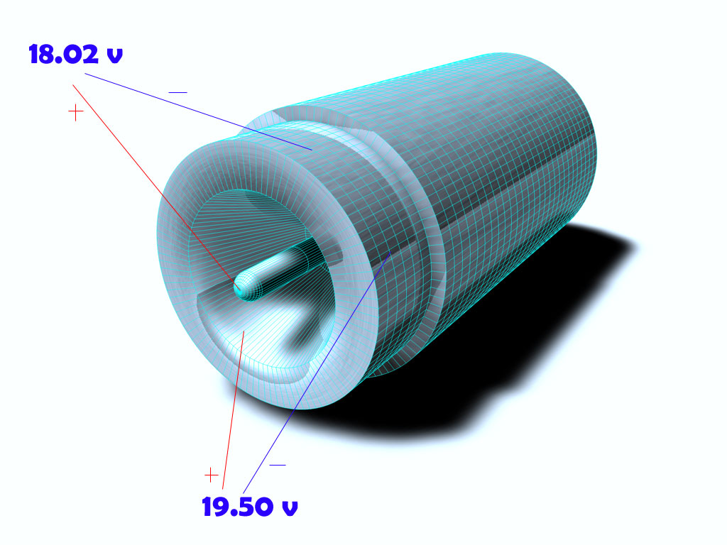

            Hi. I use multimeter and check voltage on connector voltage on little pin and inside wall of connector both has a + outside is - and on inside + got 19.50 v on little pin + got a 18.02 v
            Like on picture attached, is possible to that 1 volt diference cause this defect ?

                  Re: HP 6735s power plug blinking blue
                  You can't test these just with a DMM. That center pin carries a serial signal to the mainboard. This will not register on a DMM, only on a scope. In fact, that light you see is directly controlled by this signal. The power management IC reads info from this serial pin then turns on your 3v standby rail ONLY if it gets a valid reading (at least, that is how most newer HP laptops work). Its from this 3v rail where you get that blue light. Now, in saying all this, your problem is still probably motherboard related but its nice to rule out the little things first.

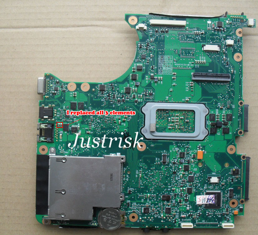

                      Hi. I use another AC power adapter and come up both lights beside power connector on board, but laptop is dead again. I spot two element was heating app. over 100c and I remove both, then start heating one beside this two, and I change all 3 elements from similar motherboard, and again not work it all.
                        Also, placing any sort of voltage on the center pin above 3-5V is a bad idea. If this is similar to the Dell design there is a 1-wire serial EEPROM between the center pin and ground (they should really be called "2-wire"). Those are not designed to withstand voltages above 5v.
                        I see two diodes there. Use the schematic and look up the right part number. "similar" may not be good enough. I suspect there is something shorted beyond the power circuitry.
