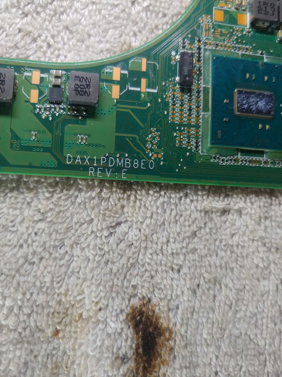

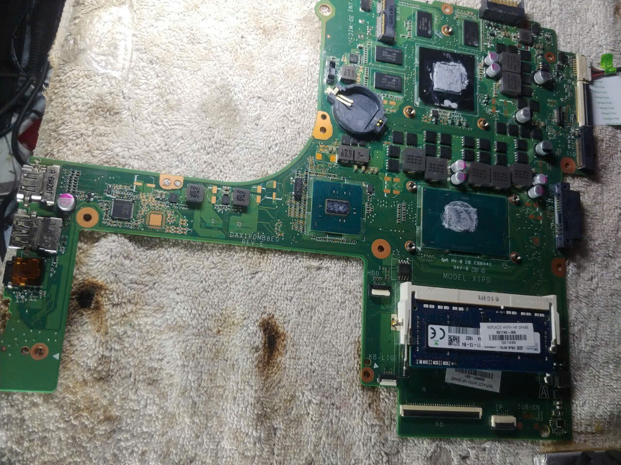

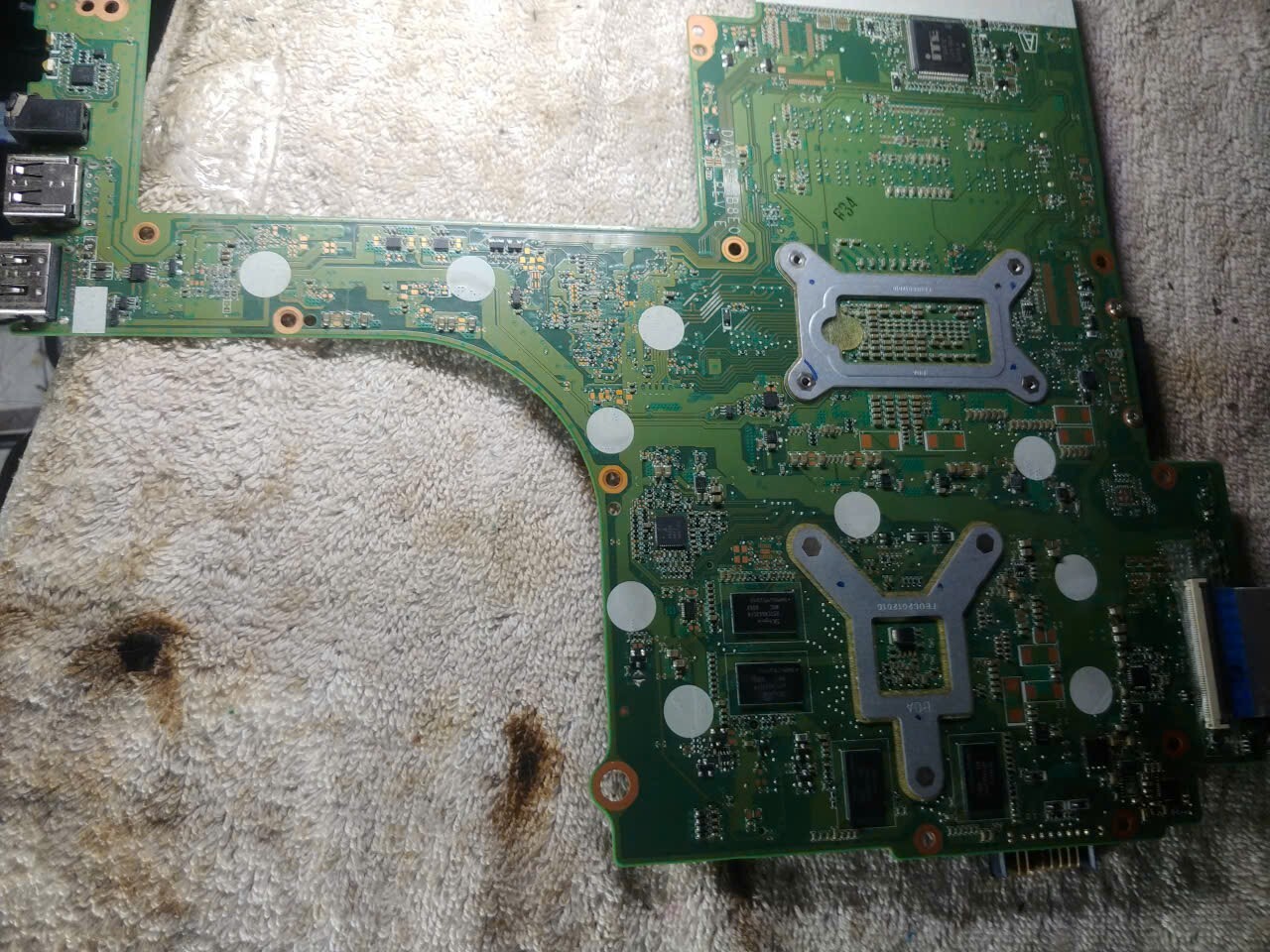

    When I press the power button, nothing happens. All I can see is the power button blinking and never stopping.
    Here’s everything I’ve tried:
    -Removed the battery
    -Changed the power adapter
    -Replaced the CMOS battery
    -Changed the RAM.
    But my laptop is still blinking. However, in the morning after I wake up, the laptop will turn on.
    Here is my spec:
    -i5 6300hq
    -Gtx 950m
    -Hp pavilion gaming 15-ak030tx Laptop DAX1PDMB8E0 Rev E
    Now, I'm trying to fix the motherboard using the schematic I found
    If anyone can help me figure out what the problem is, I would be very grateful!

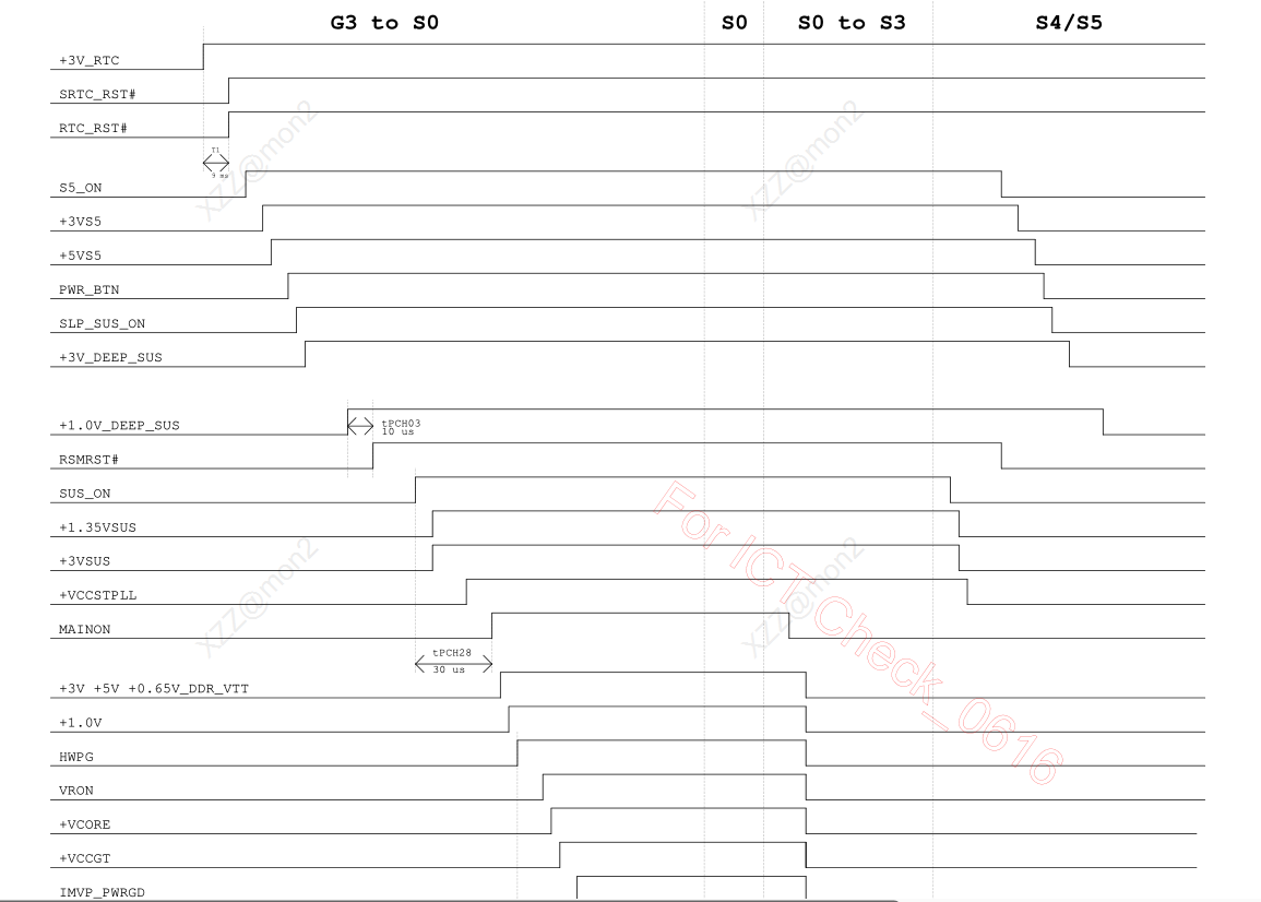

    Review the power on sequence chart on page #51 of the schematics:

      Im checking, but do you think the problem is my bios?

        Update:"I've checked everything but still can't figure out what’s causing the problem.
        I'm waiting until tomorrow when it can be turned on so I can check and find out what's wrong
