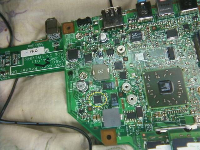

    So anyways, the laptop still doesnt boot up, but when I plug it in, 2 components on the mainboard get very very hot. its so hot you cant touch it for more than a second. The first component is: ISL6236. here is some info on that:

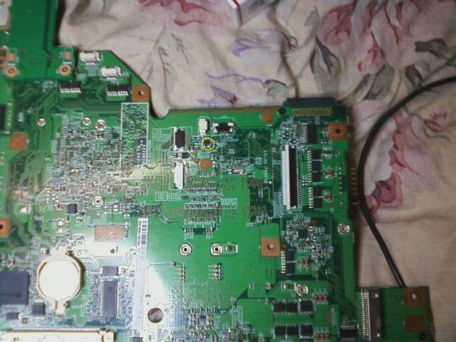

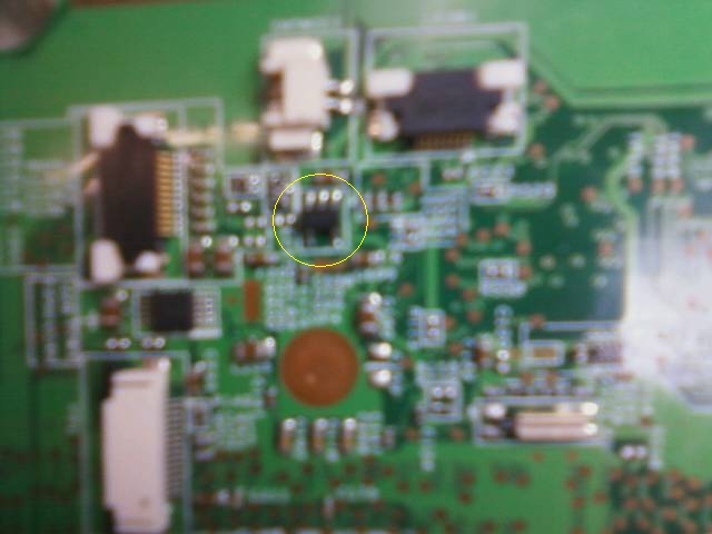

    The next hot component:
    If you flip the mainboard over, and look underneith the RAM sockets (the RAM sockets are on the other side of the PCB), there is a very small black component, that has 5 pins, 3 on one side, 2 on the other. It too gets very hot, and I guess makes sense since its right under the RAM sockets. I thought maybe this component being hot and bad was maybe sending feedback to that second RAM socket, and maybe thats what burnt that RAM stick. So I put the good 1GB stick in that socket, but it didnt burn it, so maybe it was the current from the wrong wire of that LCD ribbon cable. I dont know what component this is (maybe EC or U), but its labeled 909YU, or 909VU.

    here is a pic if the ISL 6236(circled in yellow). Im sorry the quality is so bad, My camera isnt the greatest
      Re: Im an idiot, and so can you
      Do you have the motherboard part number? Maybe I can find a schematic. The burning hot ISL6236 suggests there's a shorted part somewhere else.
      About your hard drive: It's unlikely you'll be able to fix that one yourself; not even data recovery people normally do board-level repairs on hard drives. That's the main CPU which is overheating, probably because something else shorted out.

                    Im curious how these 2 parts, ISL6236, and the other IC get so hot just with the power plugged on. Its bugging me because something should be preventing current like that until I press the power button. As soon as I plug it in they get hot. That would indicate a bad resistor, correct?
                      That means the standby circuit is drawing excessive current. The ISL6236 has a builtin linear regulator that outputs on the LDO pin with only 100mA maximum current. You can see from the schematic that 5V_AUX_S5 is connected to that. There are not that many parts powered from 5V_AUX_S5, but there is also 3D3V_AUX_S5 which powers the embedded controller. The other 5-pin part getting hot might be the 3.3V LDO (page 39 of schematic), which then suggests the short is in the 3.3V aux circuit.

                                      On page 39, that IC is listed as U51. On my laptop U51 and all listed resistors in the circuit are physically missing from the PCB. The solder pads are there, the white slkscreen labels are there (it says U51 next to the 5 solder pads where the chip should be. Same for the included circuit resistors).
                                      Maybe this means just means that was a part of a revision change not reflected on this schematic??
                                      Also, the IC getting hot is labelled U73, which isnt even in the schematic (I ran search in pdf, pulled up matches for U12, U13, U74 etc, but no matches for U73)
                                      Anyways, the hot IC (U73) is located in between the connectors for the keyboard, touchpad, and fingerprint, int mic, and LED. (Directly underneath the Winbond WPC 8763LDG). Whats very suspicious is that the blank U51 is actually right next to that Winbond (same side, bottom left).
                                      Can you please help me sort this out? Is the aux 3.3v power used for those devices (keyboard, touchpad, mic, LED)? If so, maybe U51 is U73...
