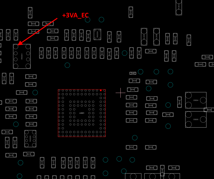

                      SMB0_DAT_BAT_CON has 3.3V so does SMB0_DAT_CLK_CON
                      PCH's to GND has 68 to 70 Ohms
                      the +3VA_EC pin shown on the arrow also has 3.3V​

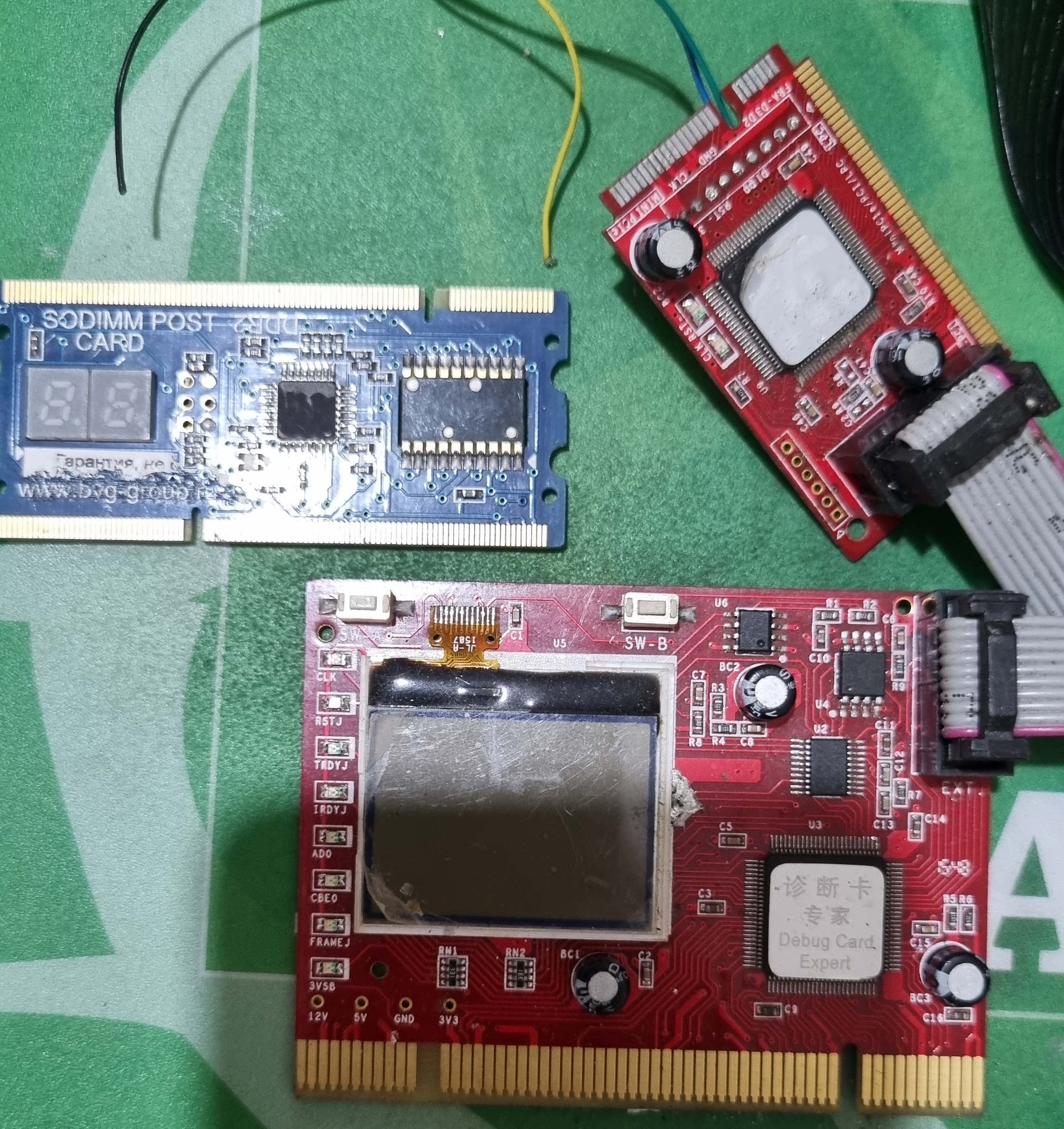

                                Could you recommend me a good / the right device for using the debug port?
                                Would this one work for that? (seems like it works on the RAM slot instead of using the dedicated port.
                                • jasko_jacker
                                  • Oct 2014
                                  • 1140
                                  • italy
                                  if you need it for Asus systems, there is a DDR2/3 card (which can also be connected to the DDR4 via cables) and now also DDR4 which uses the RAM port, see www.bvg-group.ru (I don't know if they still exist) while to use the jdebug port there are many devices that are fine but you have to solder the cables or create a connector. they are only useful if the bios works and hangs on a specific code they are not like a jtag system
