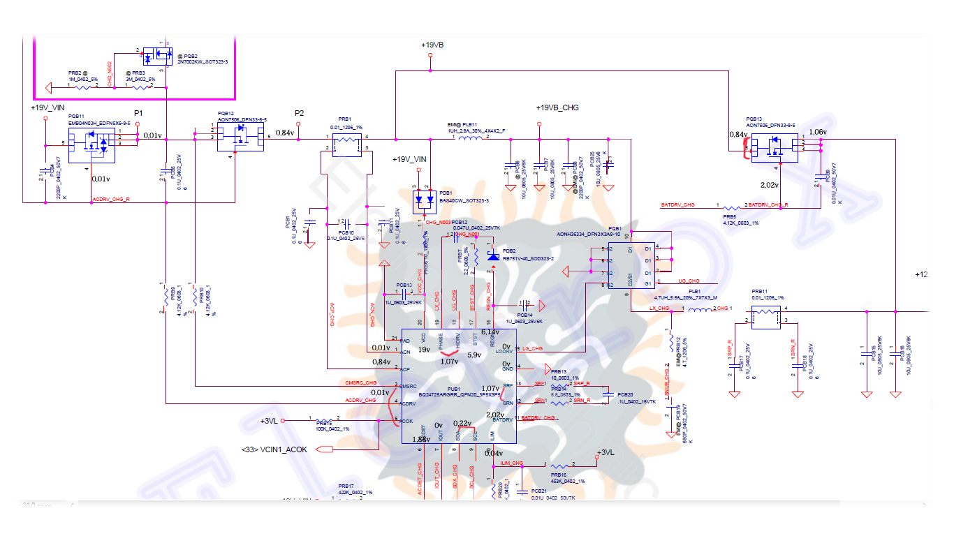

            Hi everyone,
            I'm facing the same problem.
            The motherboard model is:
            CSL50/CSL52 LA-E791P
            REV:2.0
            2017-07-18
            I joined an image to the post with taken measurements ( The multimeter that I use is not perfect so excuse me for any mistake ).
            I'm using the schematic from this post
            https://www.badcaps.net/forum/attach...3&d=1634195060
            • mon2
              • Dec 2019
              • 14240
              Re: LA-E791P works in battery only

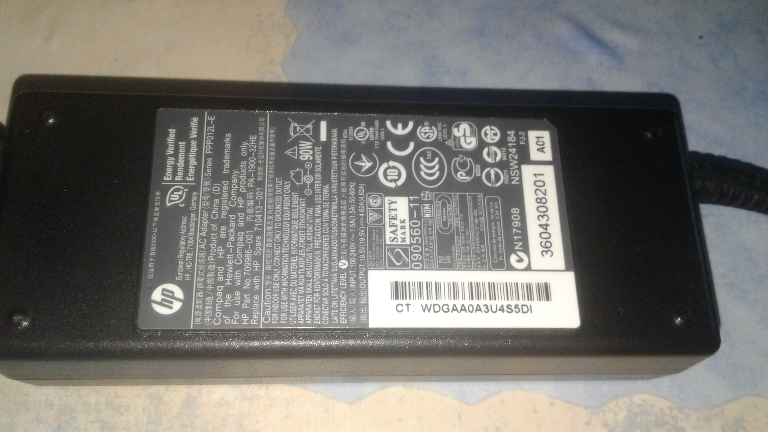

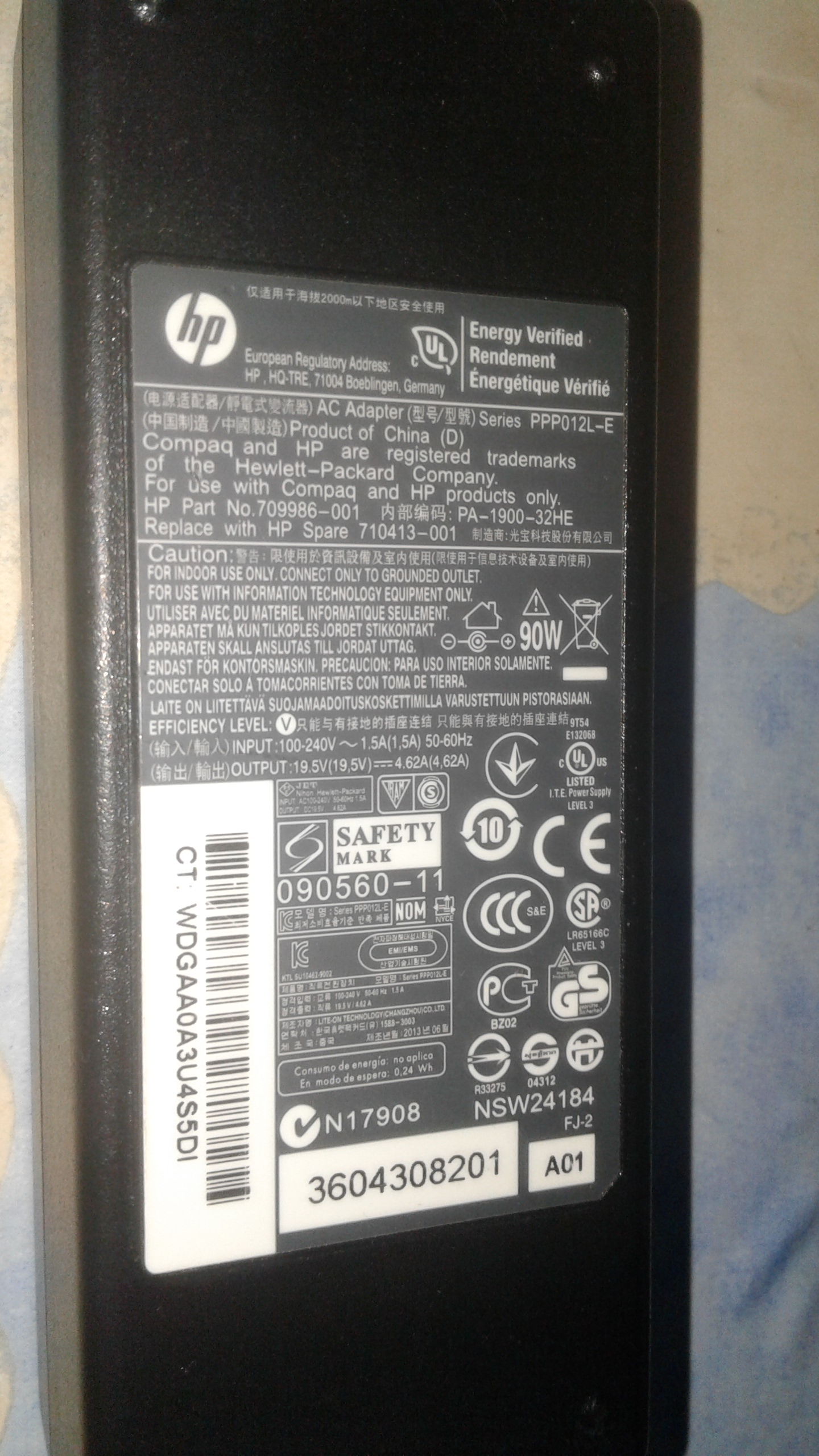

              ACDET voltage is too low. Are you using the official power adapter? Rated with enough power for this model?
              Review the datasheet for the charger ic and the details needed for the ACDET pin.

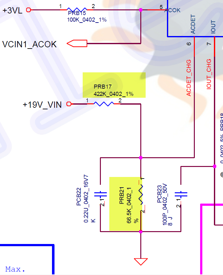

                According to datasheet
                • 0: AC Adapter is not present (ACDET < 2.4V) <default @ POR>
                • 1: AC Adapter is present (ACDET > 2.4V), no deglitch time, read only
                I attached two images for the power adapter that I use.
                Can the two resistors R1 430k and R2 66.5k be the problem and need to be replaced ?

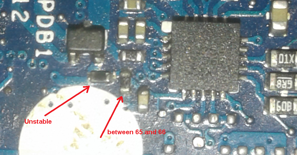

                  Remove all power. Meter in resistance mode. Carefully measure the resistance of these 2 resistors. Post the measurements.
                  • ramzi2019
                    • Apr 2019
                    • 56
                    • tunisia
                    Thanks for your time.
                    I attached an image with the suspected resistors and measurements.
                    I think the R1 430k resistor need to be replaced???
                    • mon2
                      • Dec 2019
                      • 14240

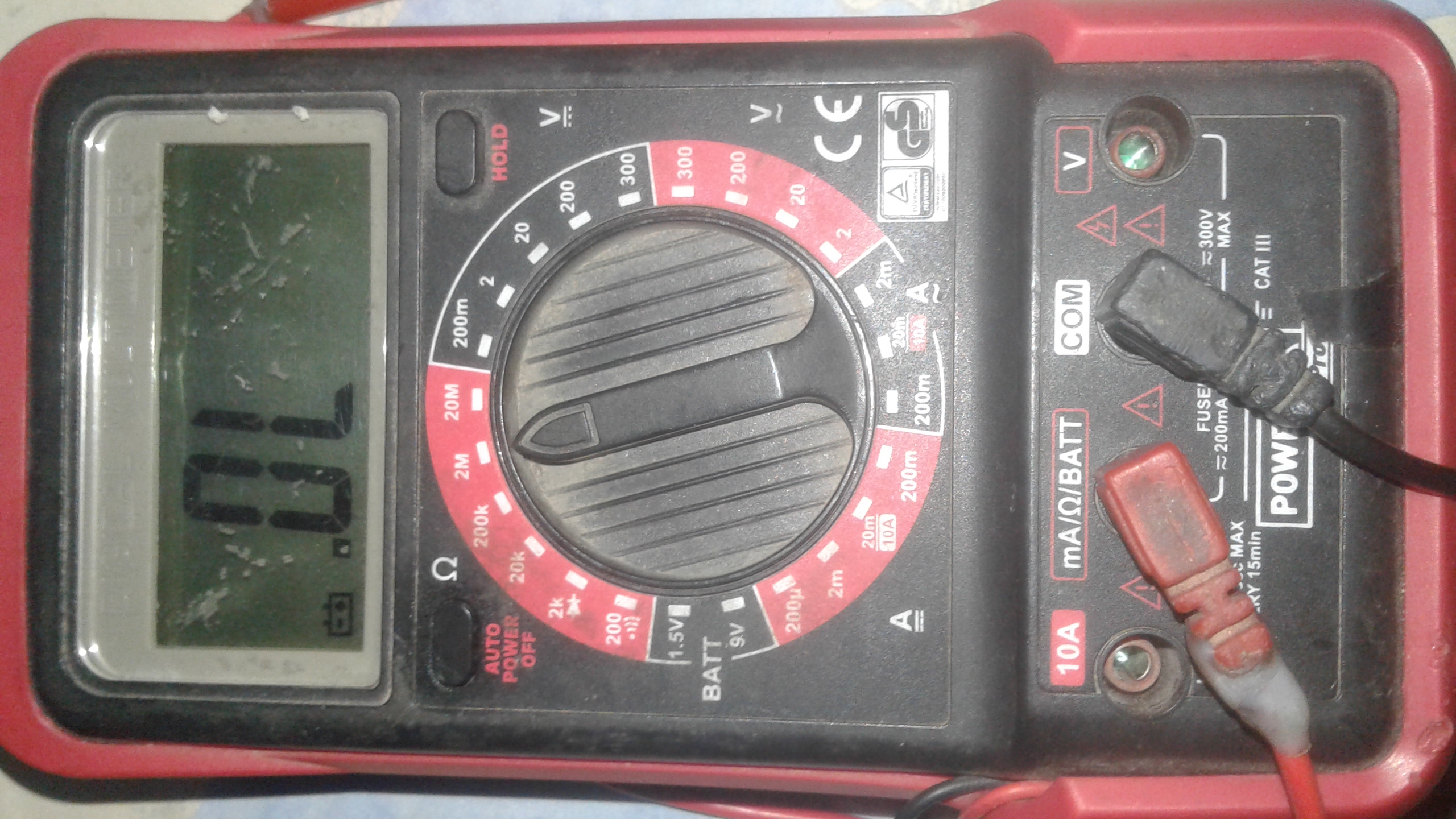

                      Can you post a pic of your meter setting for these resistance checks?
                      • ramzi2019
                        • Apr 2019
                        • 56
                        • tunisia
                        This is a picture of my settings.
                        • mon2
                          • Dec 2019
                          • 14240
                          Use the 2M meter scale for R1 checking.
                          Use the 200k meter scale for the R2 66.5k checking.
                          Post the measurements again. It is possible that these parts are reporting a bad reading as they are soldered onboard but for the very low cost of resistors, suggest to replace both of them.
                          The resistors should be 1% tolerance and the same physical size as the original. Will check against the schematic and offer suggestions.
                          Do you have a local supplier for surface mount parts? Or you can buy through Digikey / Mouser or Aliexpress? Suggest Digikey if possible - perhaps RS Electronics in Europe.
                          The parts are 0402 in SMD size and 1% tolerance.
                          Be sure to purchase the same values as shown in the attached schematic. Purchase spares as they are easy to lose even with good motor skills and tweezers.

                            Thanks a lot for your help.
                            Because of multiple attempts to get a good measurement of R1, I destroyed it.
                            In any case, I will try to get another similar one from old motherboards because there are no nearby suppliers and purchasing from the internet is very complicated in my country.
                            I will inform you of the results as soon as possible.

                              Ok. NP. From my little knowledge, I think our olive oil is sourced from your region. Very tasty.
                              These 2 resistors are not critical in their values but should be 0402 in size so you can solder them in place.
                              These 2 parts are building a resistor based voltage divider. So the values can vary but you must use a calculator to understand the target voltage.
                              See here:
                              https://www.digikey.ca/en/resources/...oltage-divider
                              Use 19 volts as the Vin and then apply the resistor values that you own or find on the donor boards.
                              The trick is to exceed the ACDET trigger voltage (ie. 2v7). So in the end, the R1 and R2 values can vary but the goal is to meet and exceed the threshold value.
                              Do post back before proceeding if there is any doubt.
