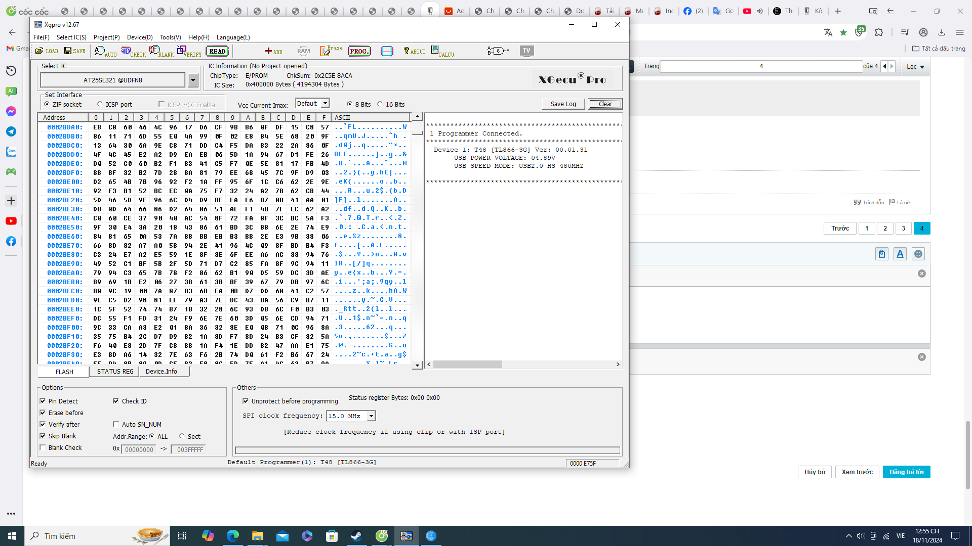

                                          #80
                                          HI MuertoGB
                                          ​I finally got the adapters and built the pyramid! But my programmer does not detect the chips automatically and I still get an error! Please help me determine the chip settings!
