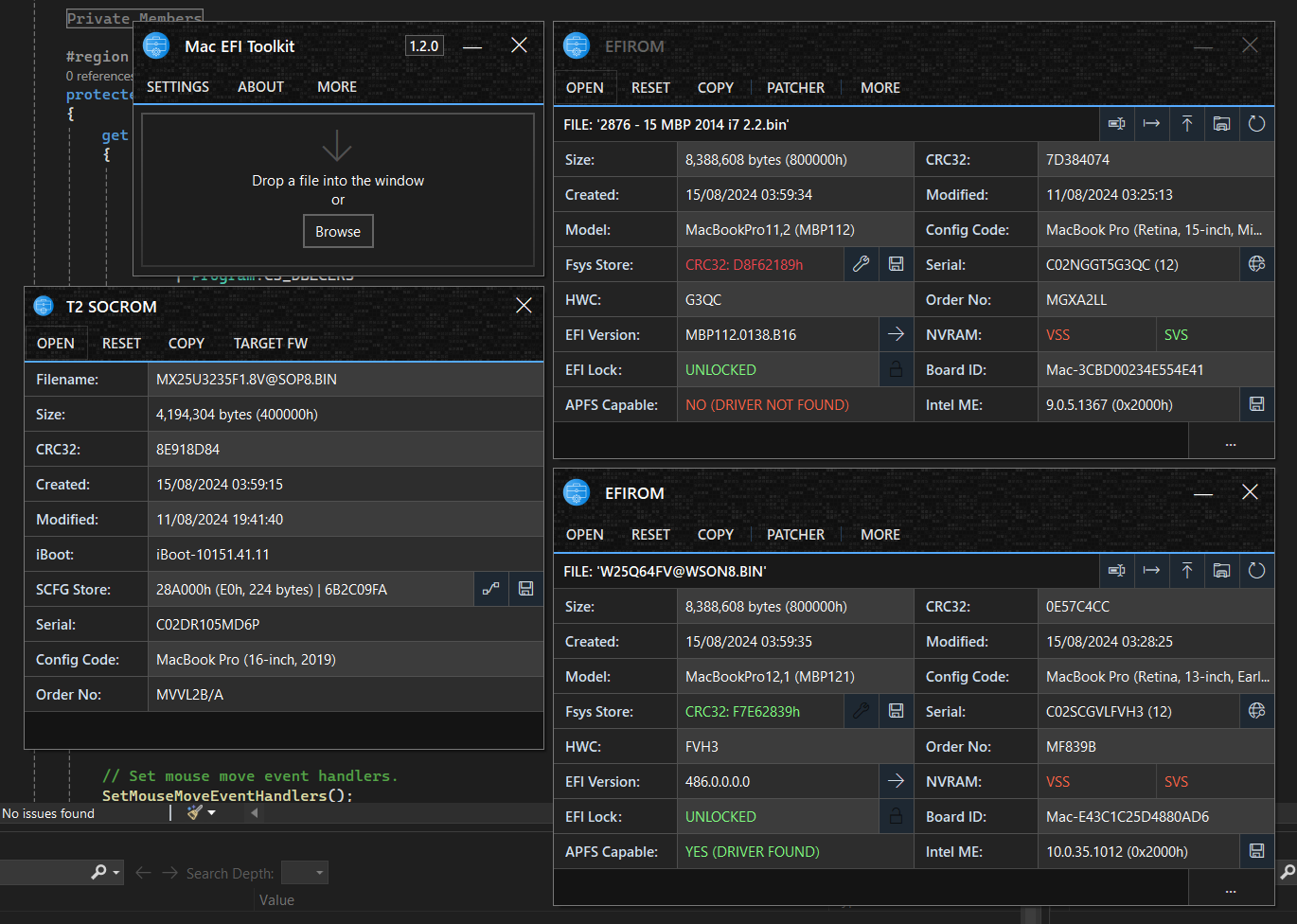

      Apologies for the delay in updates, but development has finally resumed. I've resolved the NVRAM reset issue. In addition to correctly resetting the header, I discovered a bug introduced in version 1.1.4 where the NVRAM store type (VSS, SVS) was not properly assigned. This has now been fixed.
      Additionally, I'm introducing a new T2ROM window, where you'll be able to view the iBoot version, serial number, and export/transfer the Scfg serial store (Intel only, image attached).
      Looking ahead, after the release of version 1.2, the next update will focus on separating EFI and T2-related tools. A new startup window will be introduced to detect the ROM type via drag-and-drop functionality, etc. However, for the time being, the T2 UI will be open over the main window as a tool window, as I'm working with limited time per release cycle.

                              I can't figure out how to change the serial number! Or is this program not able to do this?
                                #55
                                This is rather vague. What version are you running, are you trying to edit an EFIROM, or SOCROM? Yes, the application does edit serial numbers.

                                    EFIROM is for macbook without t2, SOCROM is for chips with t2? Am I in the right direction? And the program can only edit socrom?!
                                      #58
                                      Click image for larger version  Name:	2024-11-11 162759.png Views:	0 Size:	36.3 KB ID:	3504872
                                      Mostly correct. T2 Macs still have an EFI, but it's in the NAND and inaccessible. The program can edit serial for Intel based T2 SOCROM, and EFIROM => Click "Patch" and select "Change Serial Number", the application will then replace the SSN and allow you to save the patched firmware.
