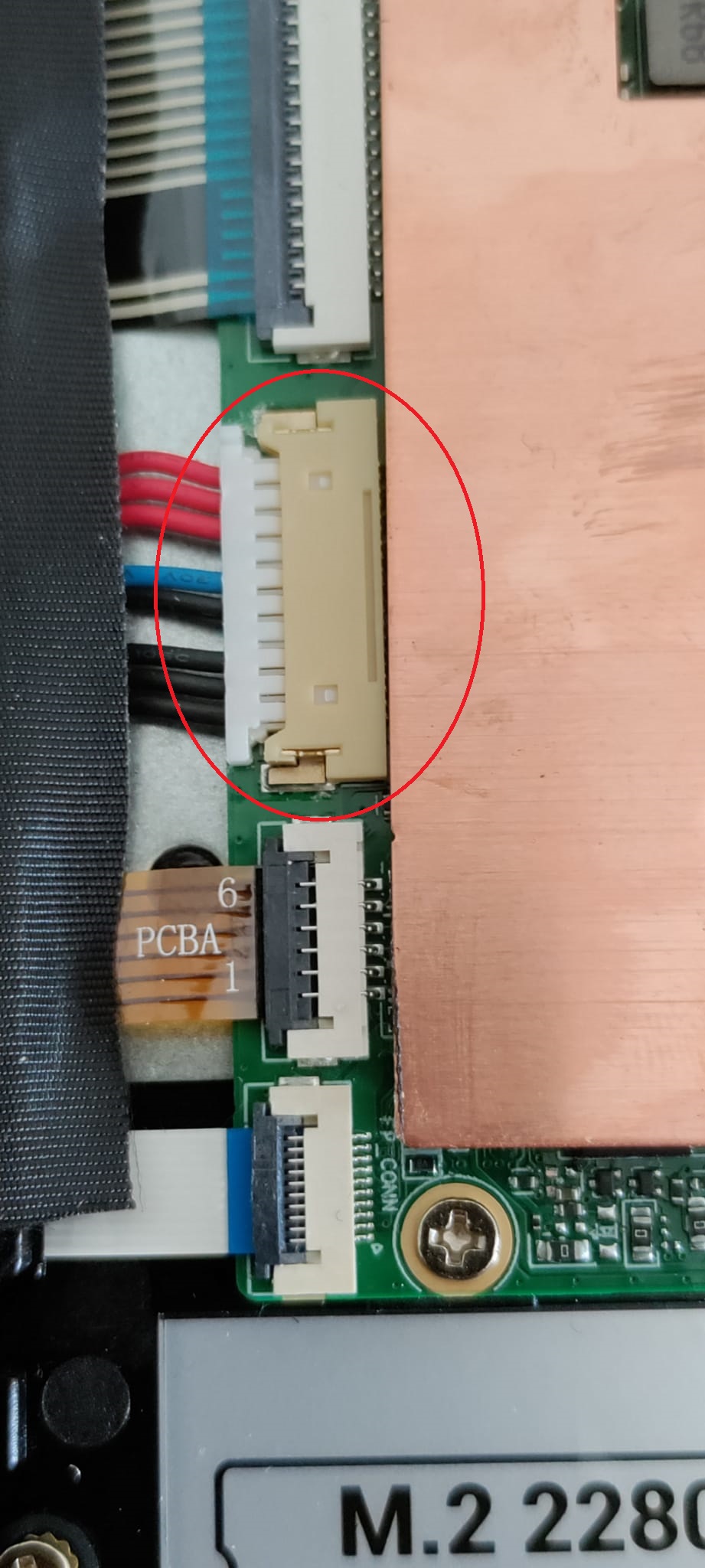

    Unowhy Y13 . I have to unplug the battery connector before flashing the bios. But I can't remove this connector and I pulled hard but it doesn't disconnect. I'm afraid to break it. Is there a special way to remove it? THANKS

    pictures please

      This is the photo.I can't disconnect it. Thank you

        Re: Help Unowhy Y13 Remove battery connector
        You have to pull see the arrow direction
          I pulled several times according to the arrows and sometimes very hard at the risk of tearing it from the motherboard, but it does not come off. there must be a locking system. It's stupid but I don't see how to disconnect it.

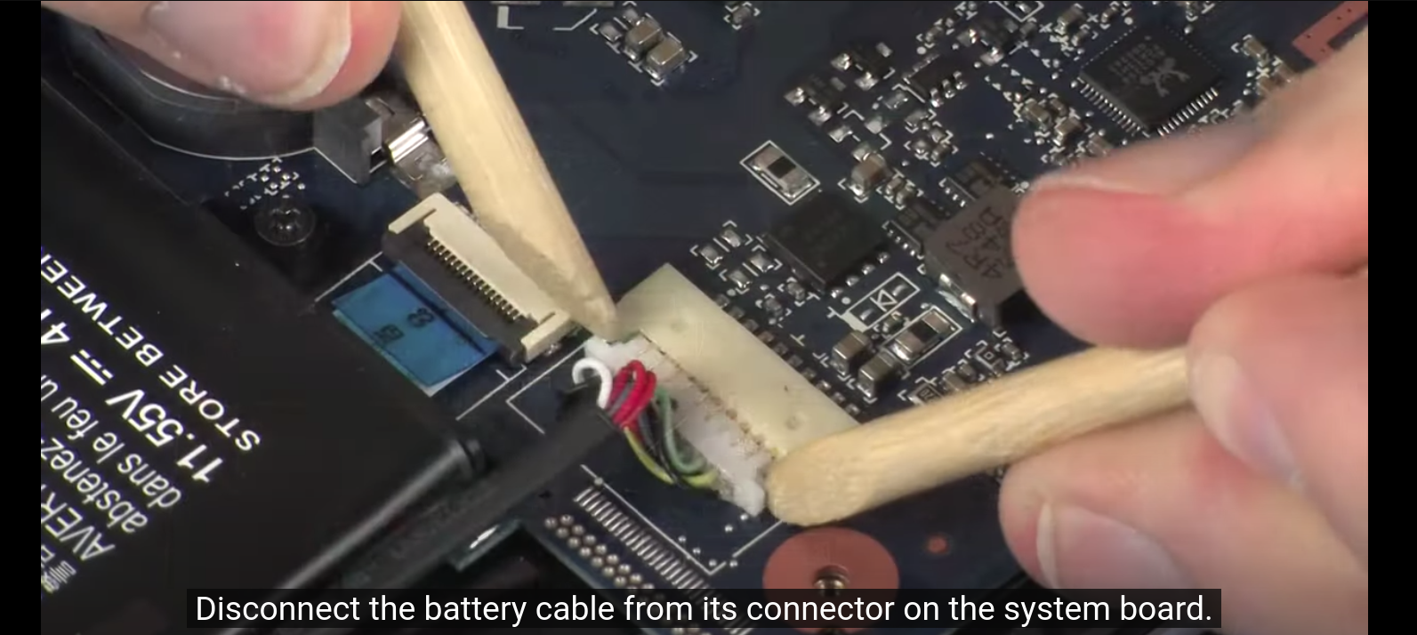

              For sure there is no lock, look at this video:
              https://www.youtube.com/watch?v=wQ-q3Ct9go4
              • petehall347
                • Jan 2015
                • 4430
                • United Kingdom
                like this
                  Thank you for your help. Problem solved
