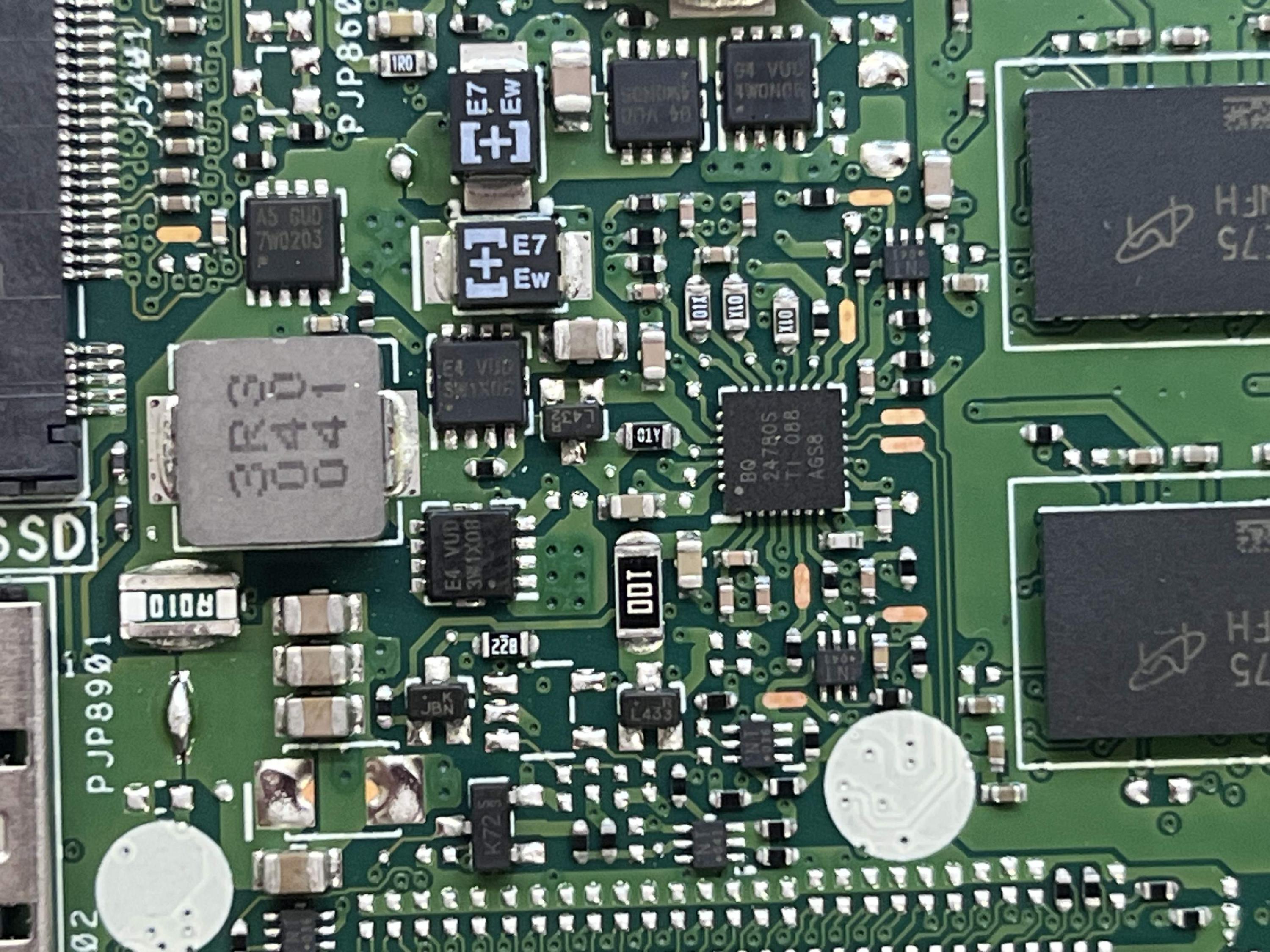

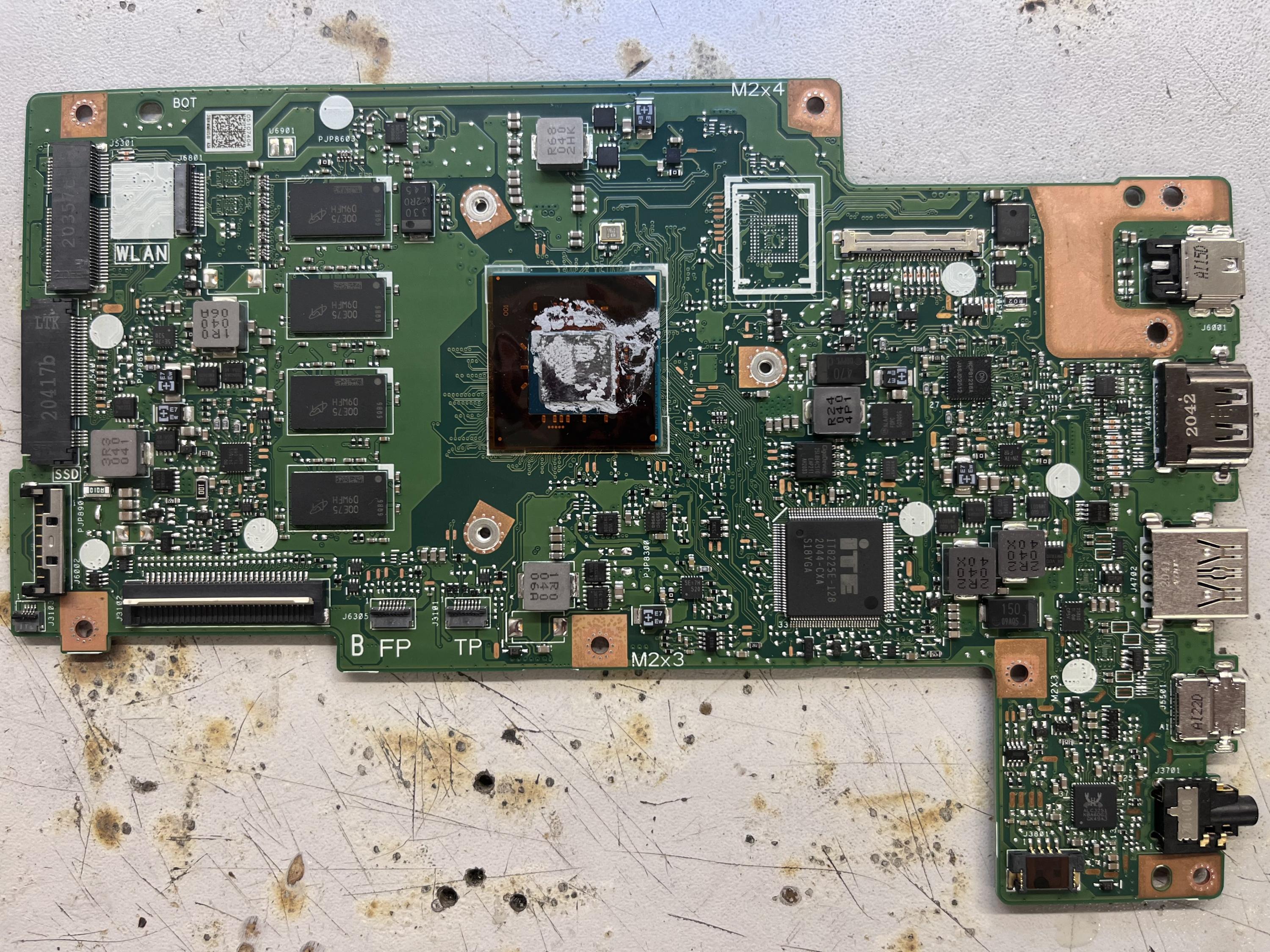

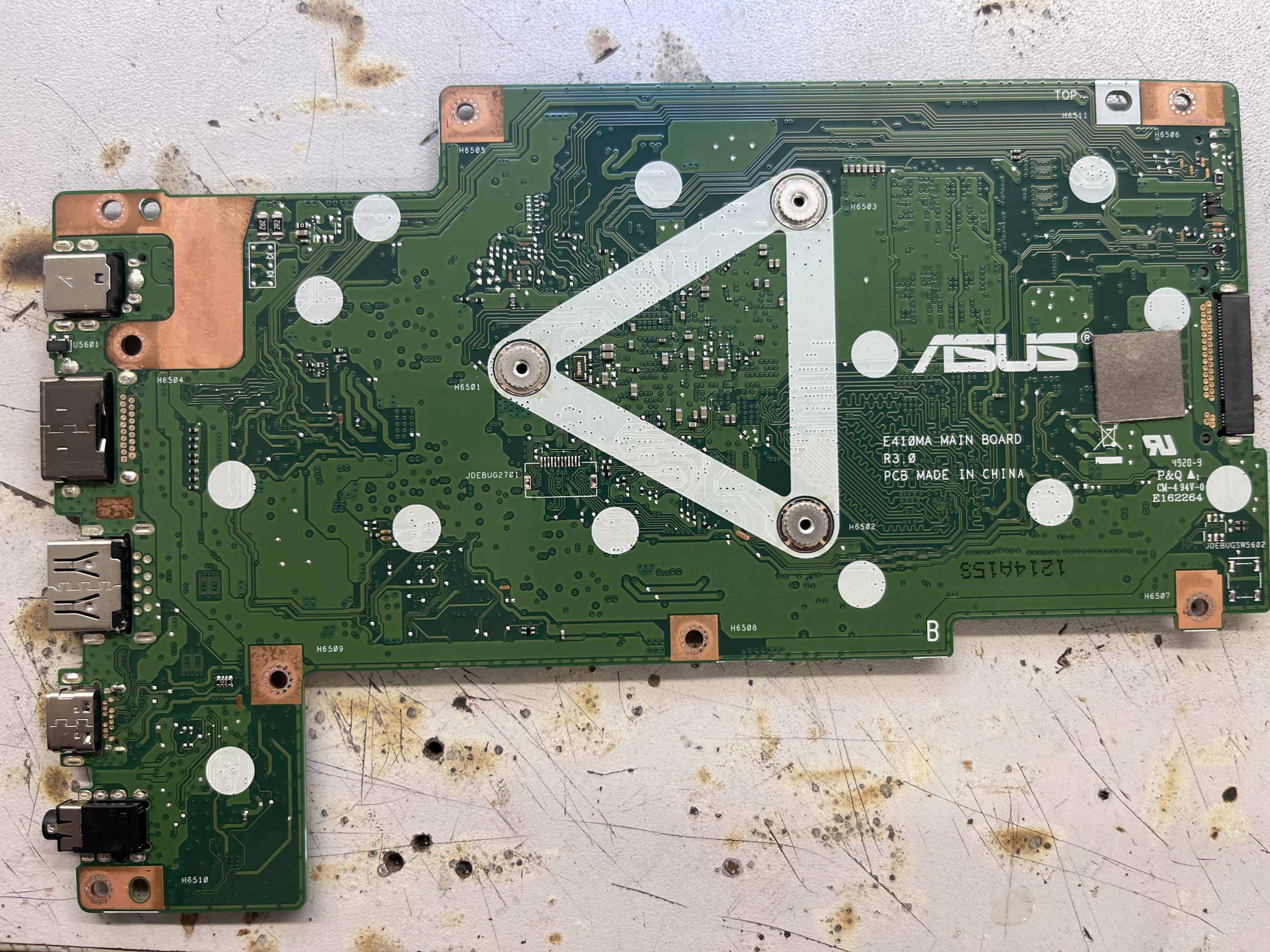

    Hello friends,
    I have this laptop with a not charging battery. This is the 3rd same laptop with exact same problem so there must be some manufacturing design problem. Windows says 0% (plugged in) and percentage doesnt increase. I tried with new battery and also with new BQ24780S charging IC. Laptop works only on DC power, after unplug immediately shut down.
    I measure BQ24780S with and withou battery and here are the results :
    without battery / with battery
    1 19.28 19.28
    2 19.25 19,25
    3 18.80 18.75
    4 24.71 24.26
    5 5.98 5.67
    6 2.63 2.62
    7 0 0
    8 0 0
    9 0 0
    10 5.1 0
    11 3.3 3.3
    12 3.3 3.3
    13 0.3 0.32
    14 6 6
    15 0 0
    16 3.4 3.4
    17 0.23 0.23
    18 0.26 0.26
    19 0.23 0.23
    20 0.23 0.2
    21 1.16 1.16
    22 0 0
    23 0 0
    24 6 6
    25 5.9 5.9
    26 0.23 0.23
    27 0.23 0.23
    28 18.97 18.97

    Re: Asus E410M not charging battery
    Measure the voltage to ground of each pin on the battery connector while the battery is connected. Do attach the power adapter as well.
    Post each measurement.

                Locate a sot23 (3 pin) dual diode near the charger IC. This dual diode will select either the adapter or battery voltage to power the charger IC (VCC pin).
                At this time, this dual diode maybe defective.
                Post pics of the area if not sure. Then remove all power. Meter in diode mode. Measure with red probe on the dual diode side with 2 pins = anode (+).
                Black probe on the side with the single pin, cathode(-).
                The diode should conduct. Repeat with red probe on the other pin. Should conduct.
                Reverse the meter probes. Should block for each test with OL.
                Confirm this. The battery voltage should reach this dual diode and pass the voltage onto pin. #28 when the adapter is removed.
