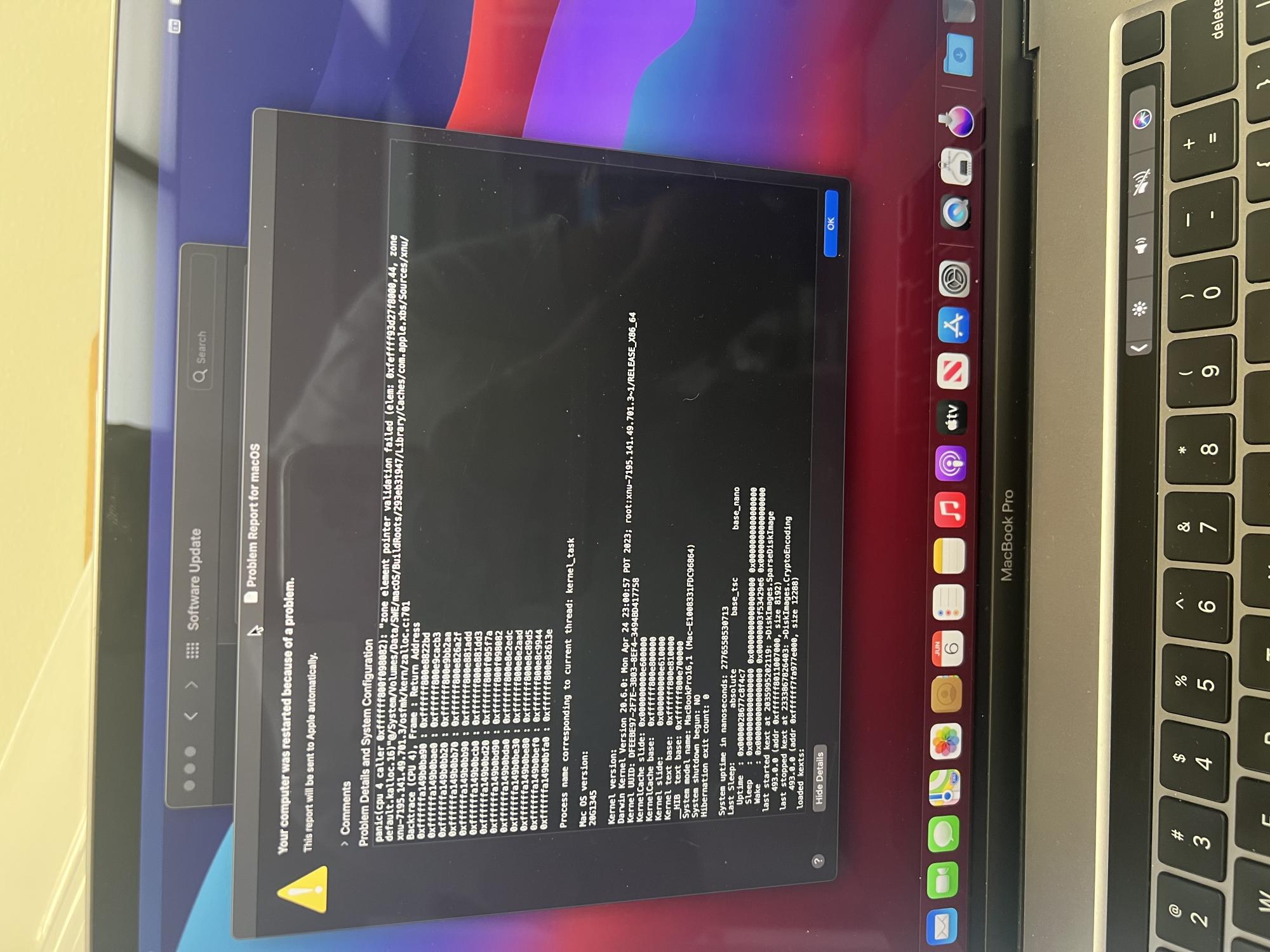

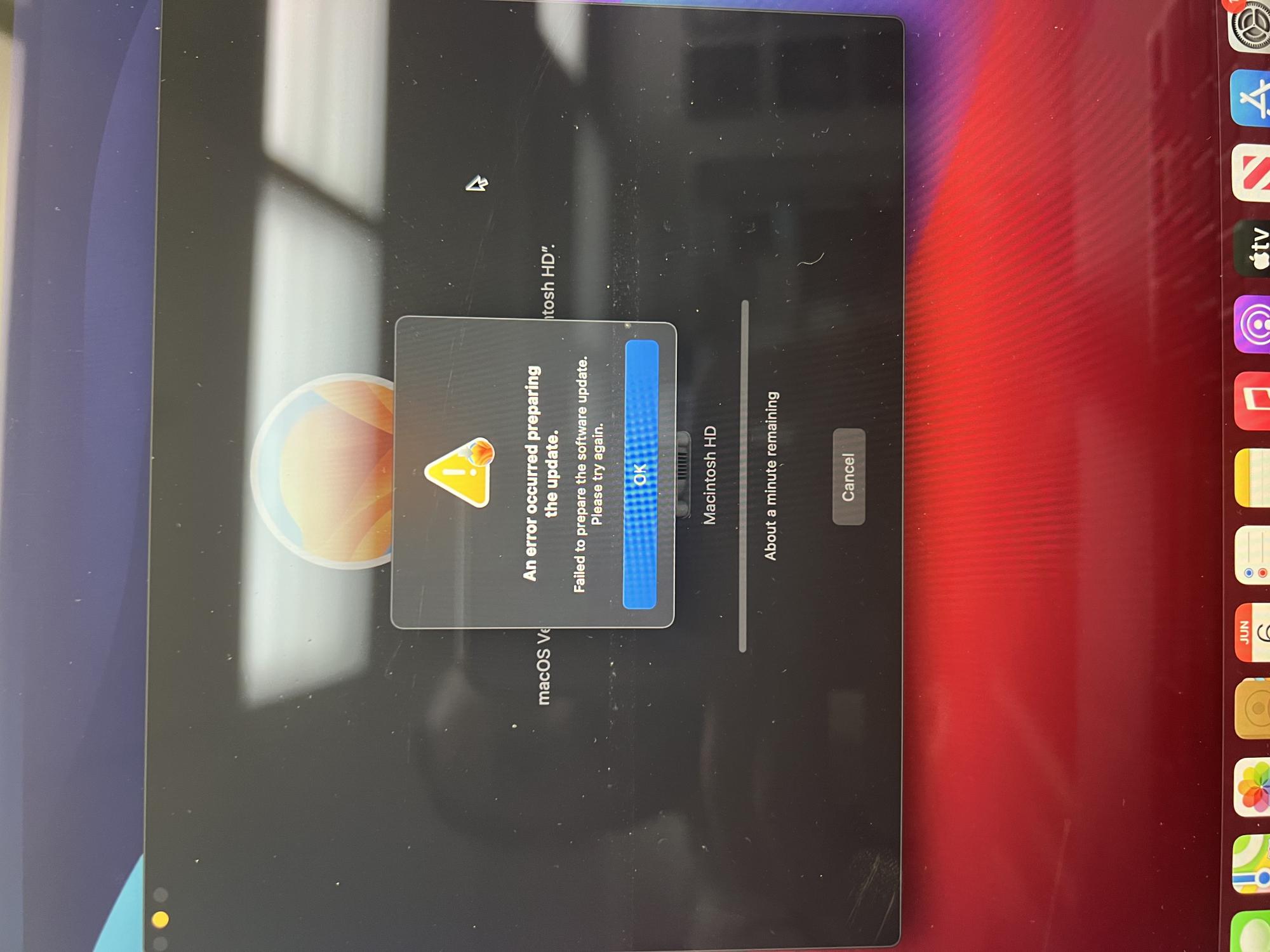

                              Re: MacBook Pro 16” 2019 Boots installs os Catalina but won't install Ventura or lowe
                              Update:
                              Board installed MacOS Big Sur after a security update but however it crashes when trying to install Monterey or Ventura.. currently now on Big Sur without issue. However I did replicate a kernel panic. Picture attached.
                              Update: tried installing Ventura. This is the error.
                              Pic attached
                              Going to try safe mode install….
                              Edit:
                              Safe mood install failed.
