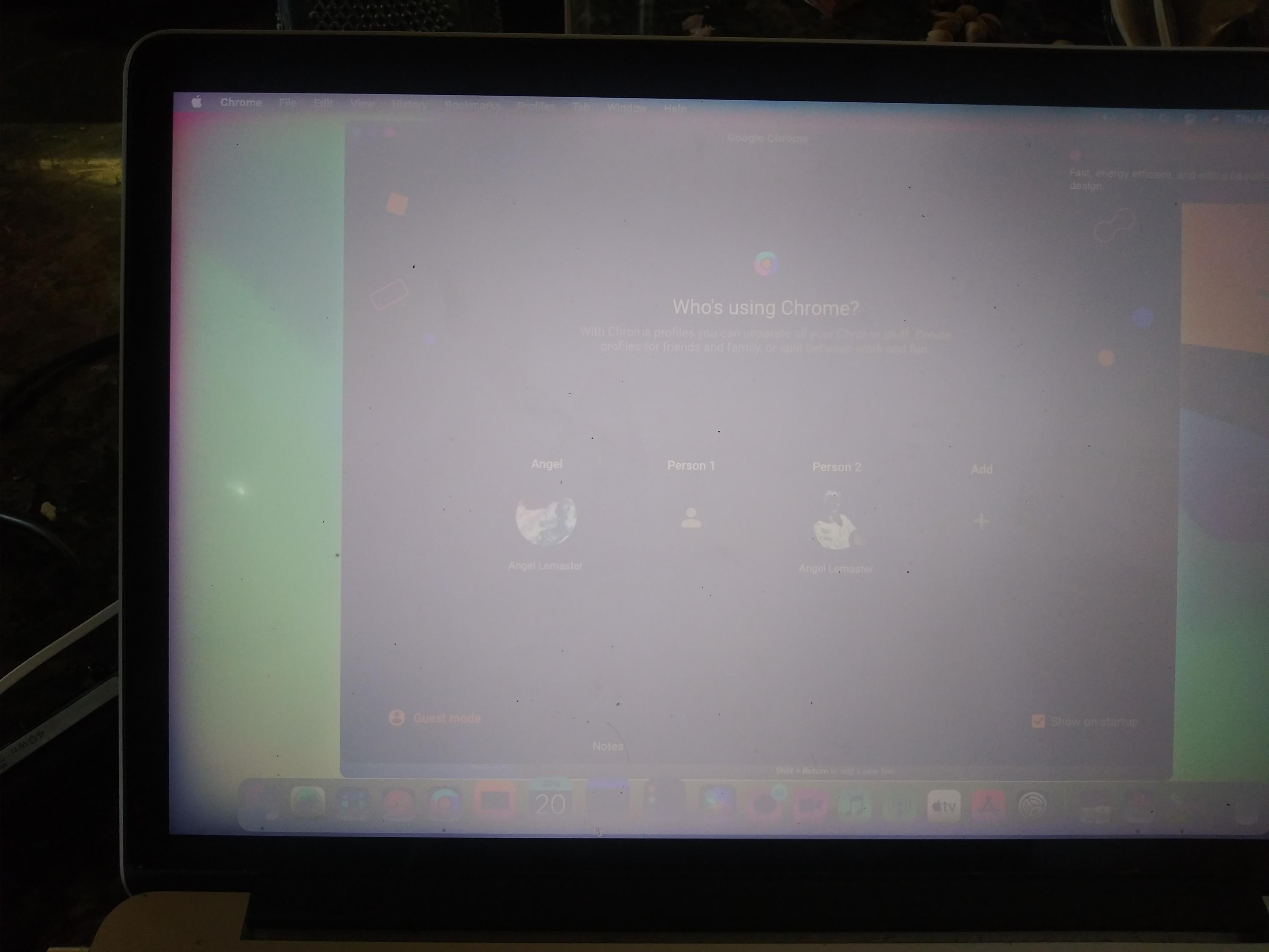

    Macbook Pro 1398 LCD damage?
    any chance this could be caused by anything other than a damaged LCD panel? replacement panels are quite expensive...going for about 200...for a used part no less! in this picture you cant see it but when i first turned it on it was flickering pretty bad as well. the flickering was like between having ok looking color and then totally solarized like in the picture. it eventually stabilized into this.

    did you check on external screen?

      Re: Macbook Pro 1398 LCD damage?
      Screen for mine. Sanity check is to run it to an external monitor via Thunderbolt to HDMI adaptor.
      Great machines this series but a lot are consigned to parts only on eBay due to defective screens.
            Originally posted by triplefour
            of course apple couldnt just put a hdmi plug on the laptop like normal people :[
            A1398 chassis does have an HDMI port. Also without HDMI port you can also use a mini-DisplayPort (which is a standard used by some other laptops as well) to HDMI adapter.
                youre right. it does have a HDMI port after all. i should have looked before believing that. i was able to use keyboard shortcut cmd + f1 to output to external monitor, where the picture looks fine.
                does this tell us the mainboard is most likely fine? or is there still something that could be damaged on the mainboard that would affect only the built in screen?
                it would be awful to spend 200$ on a used screen only to realize it was the mainboard causing the issue the whole time!
                also if its something on the mainboard, i could do a component level repair, im thinking a lot easier than trying to repair something on the screen itself.
                relating this to my knowledge of tv repair, it looks like the kind of graphic problem you could get from a failed Timing Control board...which i would assume is some small board buried in the panel assembely.

                    my screen is doing a similar thing but not as fast. more random when it snaps back to regular color...and then eventually it doesnt. ill try take video of it and put on youtube soon.

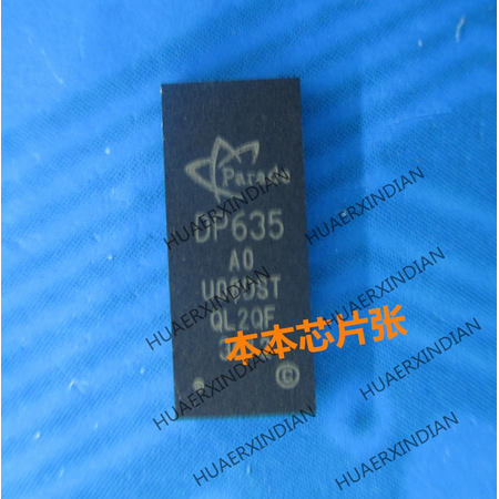

                        inspected lcd t-con. all voltage present , but noticed one big bga getting hot. it was "parade ao dp635".
                        removed and ordered a new one from china. when it will arrive ill post back if monitor come back to a normal working condition.

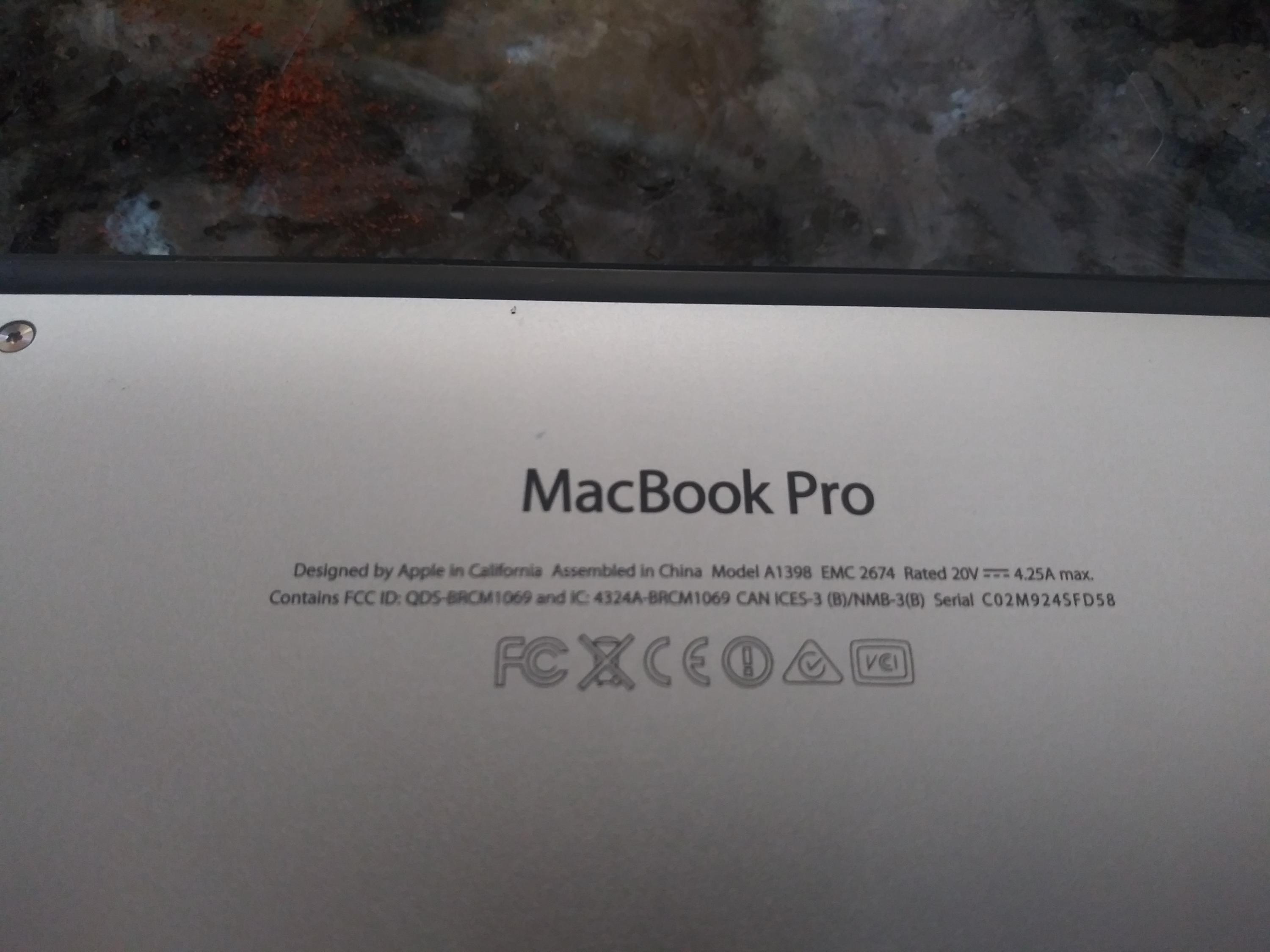

                              ok i finally got the correct bit to take out the bottom screws and reveal the logic board. i see a sticker saying C024084001EFJTCAF but a google search gets me nothing there.
                              serial on the bottom of the case is C02M924SFD58 and according to this site i found http://www.chipmunk.nl/cgi-fast/applemodel.cgi
                              it says its a late 2013 model.
                              anyone know a good source for a replacement screen?
                              and how to tell for sure what the part number i need is?
                              edit: i found a better site for looking up serial numbers. also cross referenced with what i find in system information on the mac itself. quite sure this is the exact model:
                              Apple MacBook Pro "Core i7" 2.6 15" Late 2013 (IG)
                              https://everymac.com/systems/apple/m...lay-specs.html

                                  I was going to say the same thing. Easy test if external shows the same we have a board issue on hand and his screen is good.

                                    update: changed the dp635 with another one i got from aliexpress. new chip get hot too and problem remain the same as in the video i posted erlier. i will inspect this problem more the next days, but seems like another component get hot in the tcon board on the lcd.

                                      serial:C02M924SFD58
                                      MacBookPro11,2 (Late 2013)
                                      the seller of this item assures me it is compatible but i dont know if i want to gamble with a "D" grade screen

                                      • reformatt
                                        • Feb 2020
                                        • 1419
                                        https://logi.wiki/index.php/MacBook_..._Compatibility
                                        The 2015 model is the one that is unique, but 2013/14 are interchangeable. Motherboards for 2013/14 are 820-3787. 2015 are 820-00138, 820-00163, 820-00426. If the board number isn't visible, it's usually hidden under a black sticker somewhere.
                                        I think the difference is LVDS and EDP IIRC.
