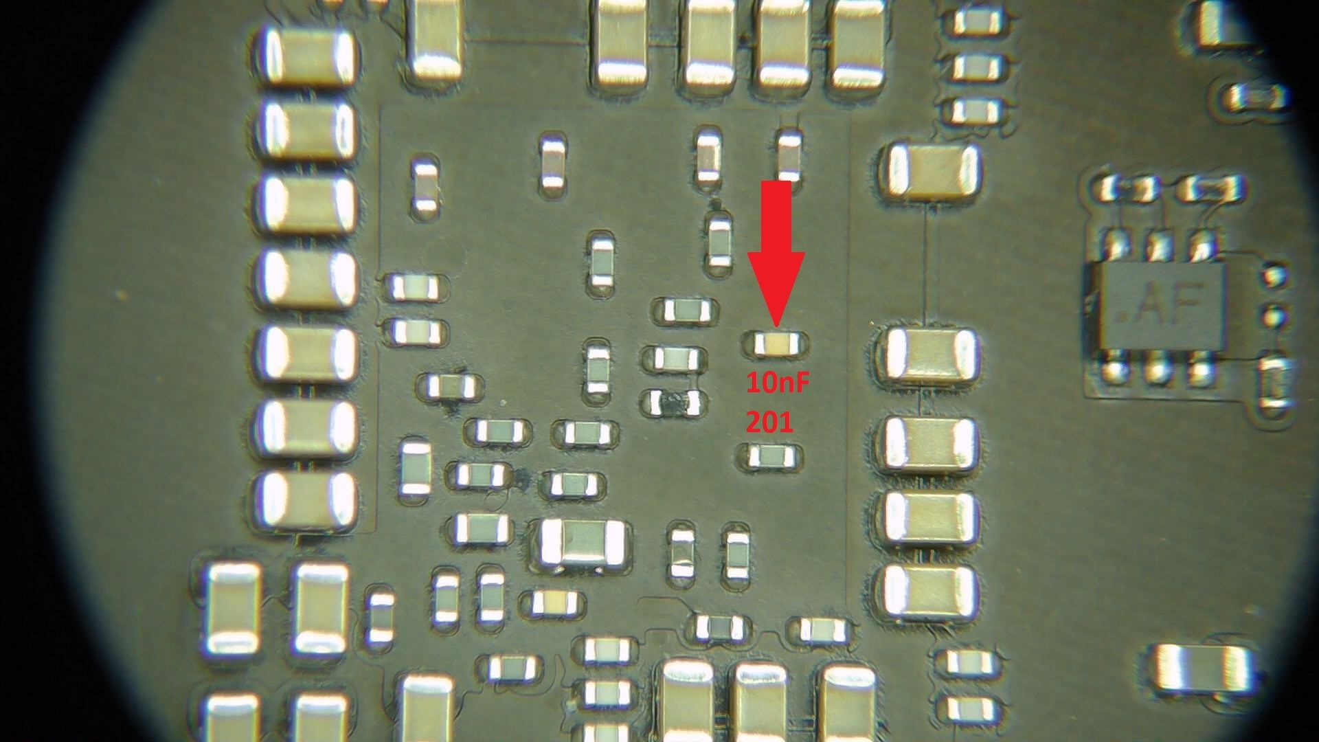

    Hi guys,
    I have a MacBook Pro M4 16" A3403 on the table with water damage. I allready found the problem within a bad cap. As far as my researh went, I couldn't find the schematics and boardview for this MacBook model. They seem not to be released now. So my question is if anybody has a working A3403 on the table and could tell me, which specification this capasator has?
    I attached a photo of the missing cap. It's on the bottom side of the logicbard.
    I am very thankful for your replys.

    I'm a little late to your question but in case you still need this, it measures as 10nF
