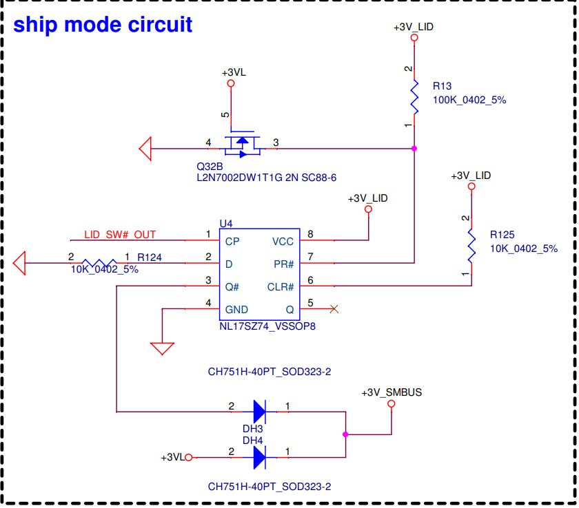

    I have an hp envy 13 -d023tu, the battery was unfortunately plugged in reverse way +ve to -ve pin and -ve to positive pin, it blew up the chip named NL17SZ74_VSSOP8 in the schematics. All volts are present, charging port lights white when in charger mode and orange when battery and charger are connected but it does not power on. I ordered what i think is the same chip, labelled MHH, after replacing it still doesn't power on. What might be the challenge?

    Post or link the schematic.

      Here
      https://www.badcaps.net/forum/showth...809#post835809

        Re: Hp envy - ase30 c482p power on
        Review the voltages on the charger IC @ PUB1.
        Interested in the voltage to ground of:
        pin # 1 - ACIN
        pin #30 - ASGATE = used to enable the DCin mosfets
        pin #18 - DCIN
        pin #29 - CMSRC
