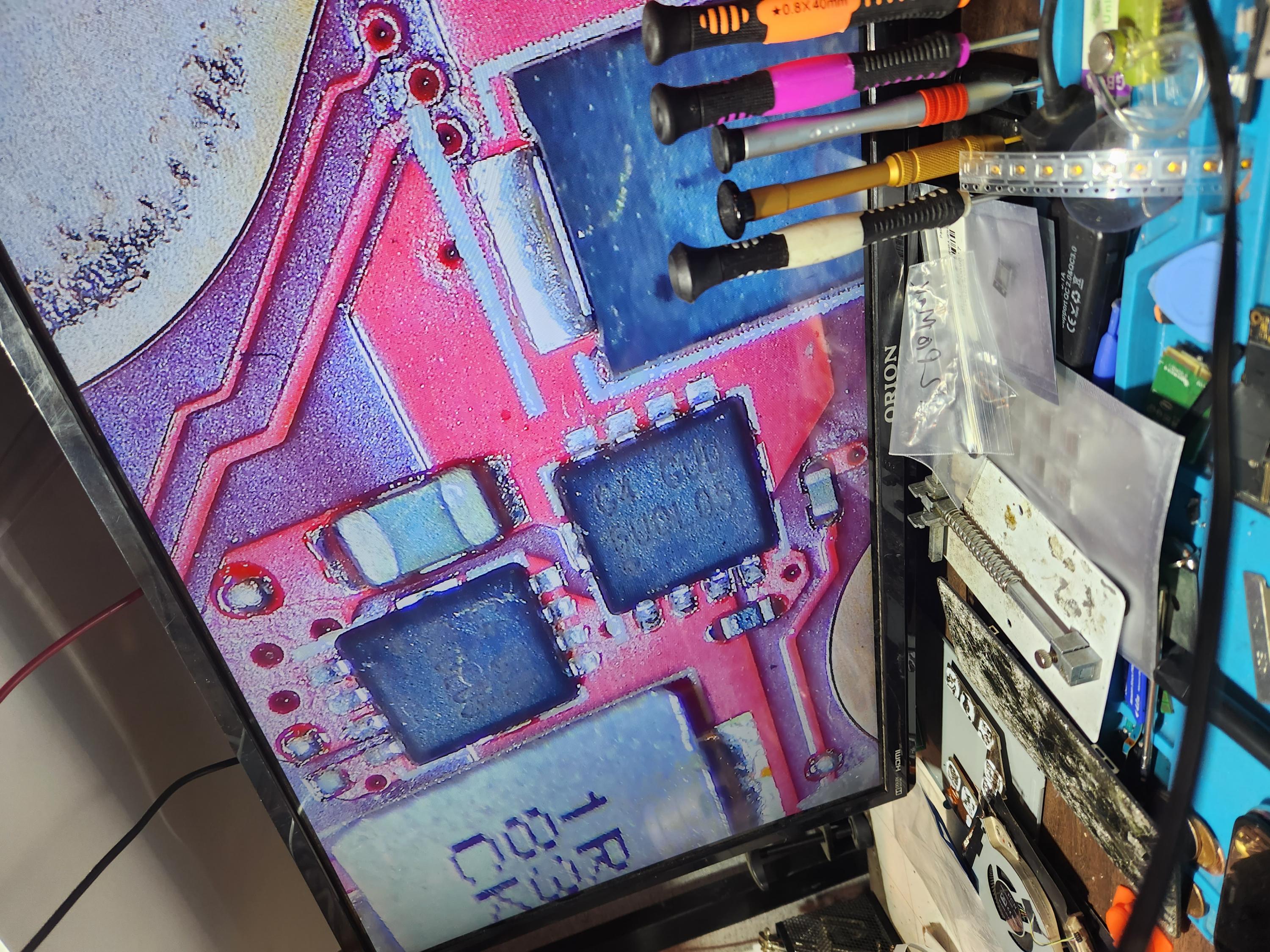

      Re: Asus Rog Laptop new battery still 0% Biard issue?
      What do you think ?

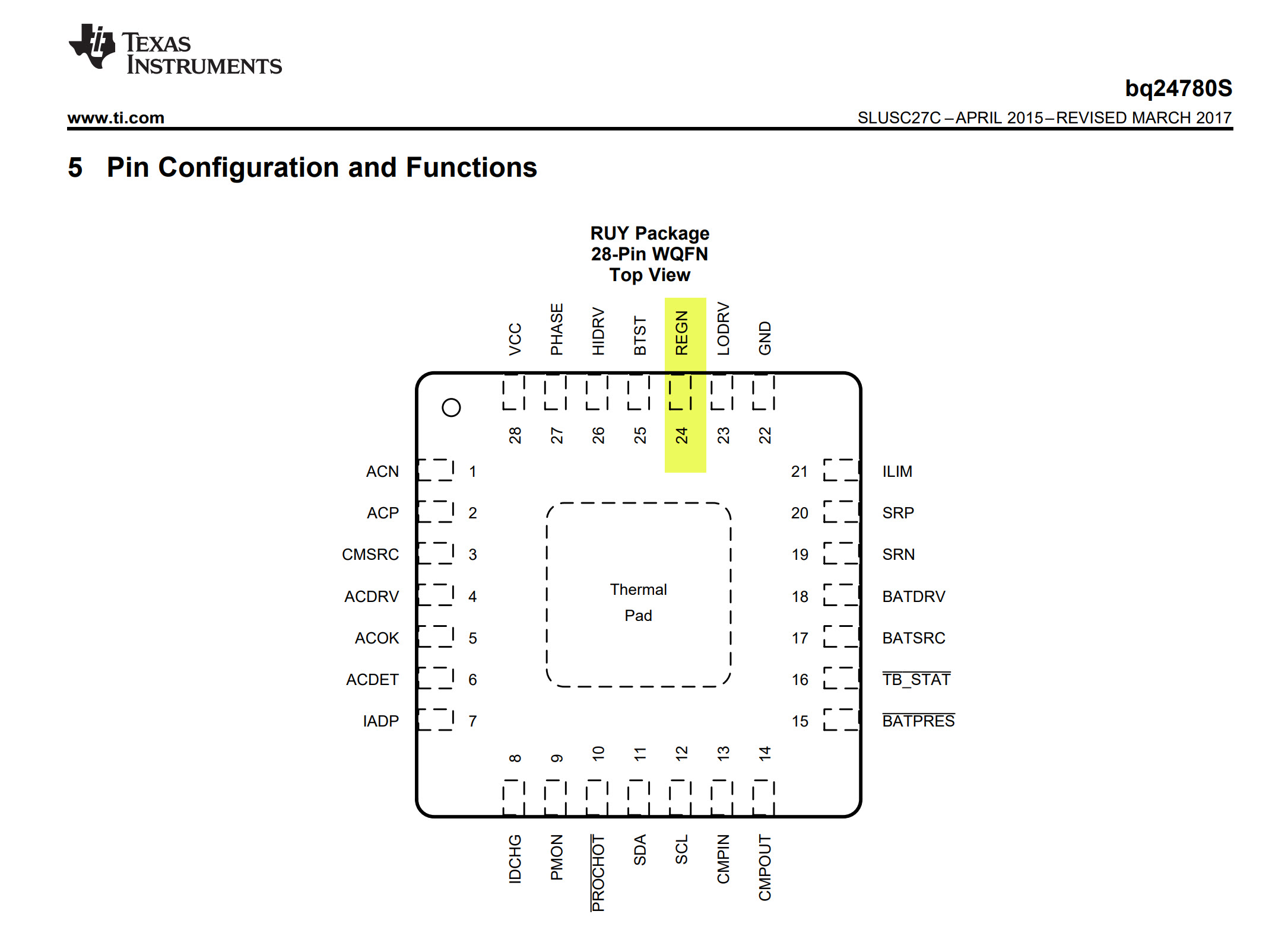

        LOL on your previous post.
        Pin 28 will be the pin north of the dot marking.
        Pin #1 is to the left of the dot marking.
        Measure voltage to ground of pin #28 = VCC.

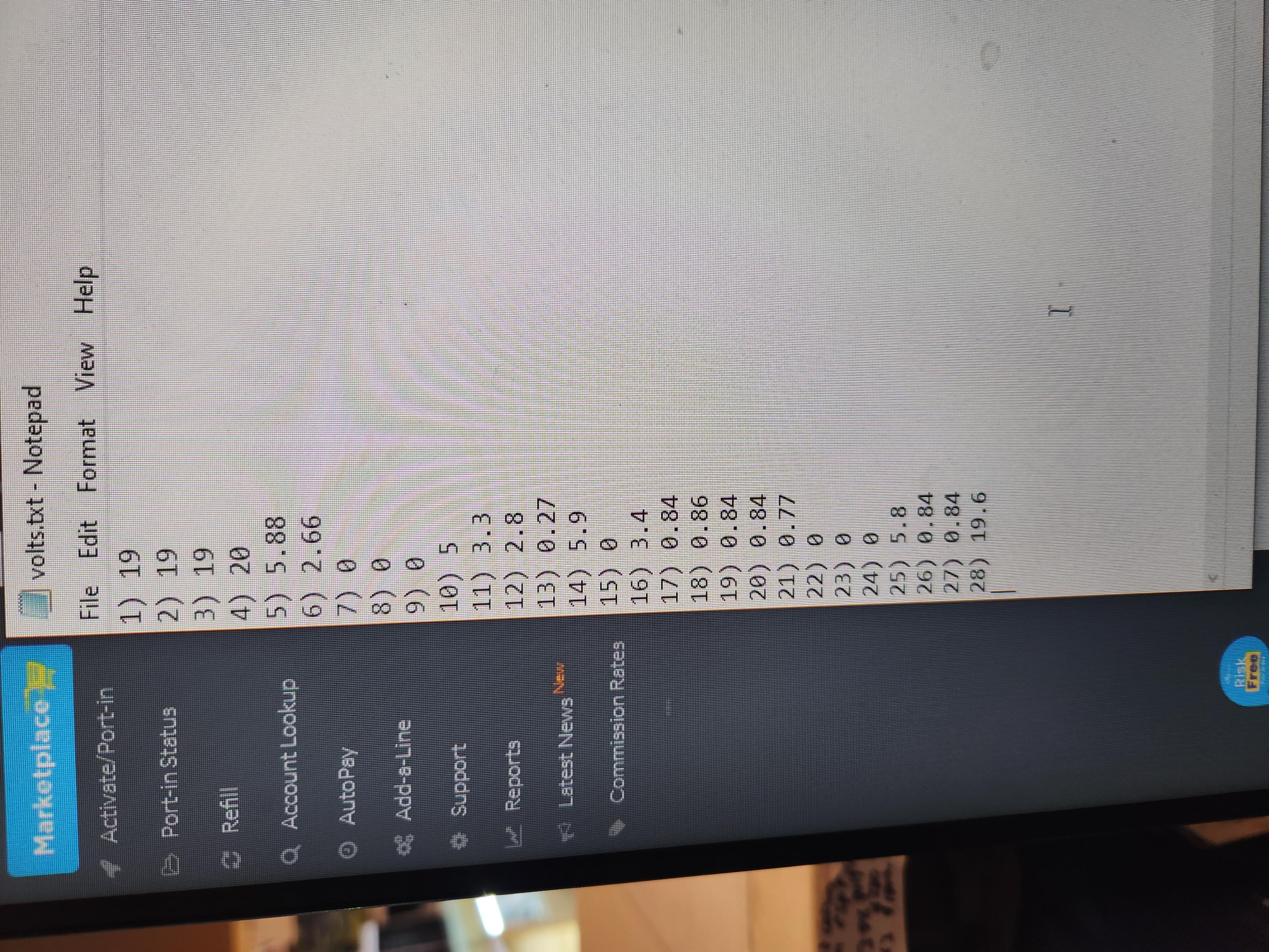

          pin 28 measures 19v
            Good VCC.
            Measure each pin on this charger IC with the battery attached. Proceed with care so not to short any pins.
            Post each measurement.
              ok finally got to it
              • irepair559
                • Dec 2022
                • 134
                what do u think ?
                  The ACDRV pin #4 voltage is too low. It should be a boosted voltage of ~25v. This voltage output should be adapter voltage + REGN voltage, so 19v + REGN = ~25v.
                  With 20v only on ACDRV, the DCin mosfets between the adapter and main power rail will be OFF.
                  REGN pin #25 is at 0v and should be at 6v.
                  Remove all power, meter in resistance mode.
                  Measure the resistance to ground of the REGN pin.
                  Post the measurement.
                  Also, with no power, meter in diode mode.
                  Red meter probe, yes red to ground.
                  Black meter probe to the REGN pin #25.
                  What is the measurement?
                  Be sure there is no power to the board. Be sure you are on pin #25.
                  As mentioned earlier by other techs, you may have a leaky MOSFET that is causing these faults.
                  Concerned about the missing REGN rail. This often means the charger IC is defective and needs to be replaced. If you are not in a rush, AliExpress will have this part. When placing an order, also purchase the mosfets surrounding this charger IC. They are very inexpensive. Post pics of the mosfets that are driven by this charger IC.
                  For example, the ACDRV pin will have a ~4k resistor that will go to pin #4 of 2x mosfets. Those mosfets are also suspects. A leaky MOSFET will allow the board to power up but not charge the battery.
                        isnt pin 24 the REGN ? pin 25 is 5.8v
                        • mon2
                          • Dec 2019
                          • 14781
                          #32
                          Correct, pin #24 = REGN. Be sure that you are measuring the proper pin.
                          Update the latest / corrected voltage to ground on pin #24.

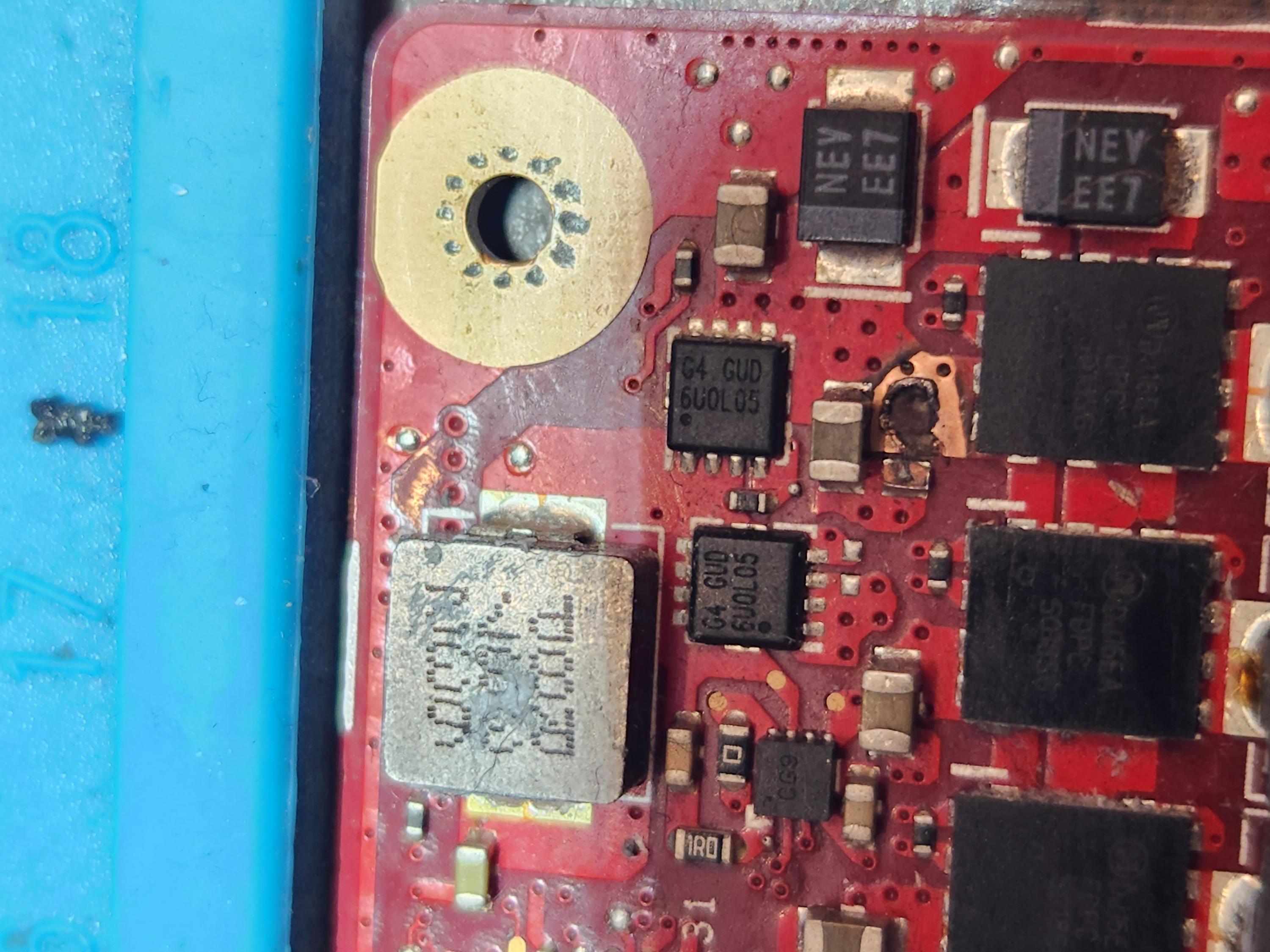

                              #34
                              remember i mentioned that top area of the board where it had a burnt cap i removed. Do you think something up there is causing all this?
                              Also those mosfets are more down the board near the batt term.. They look really heated up and curved.. How do i test mosfets ?

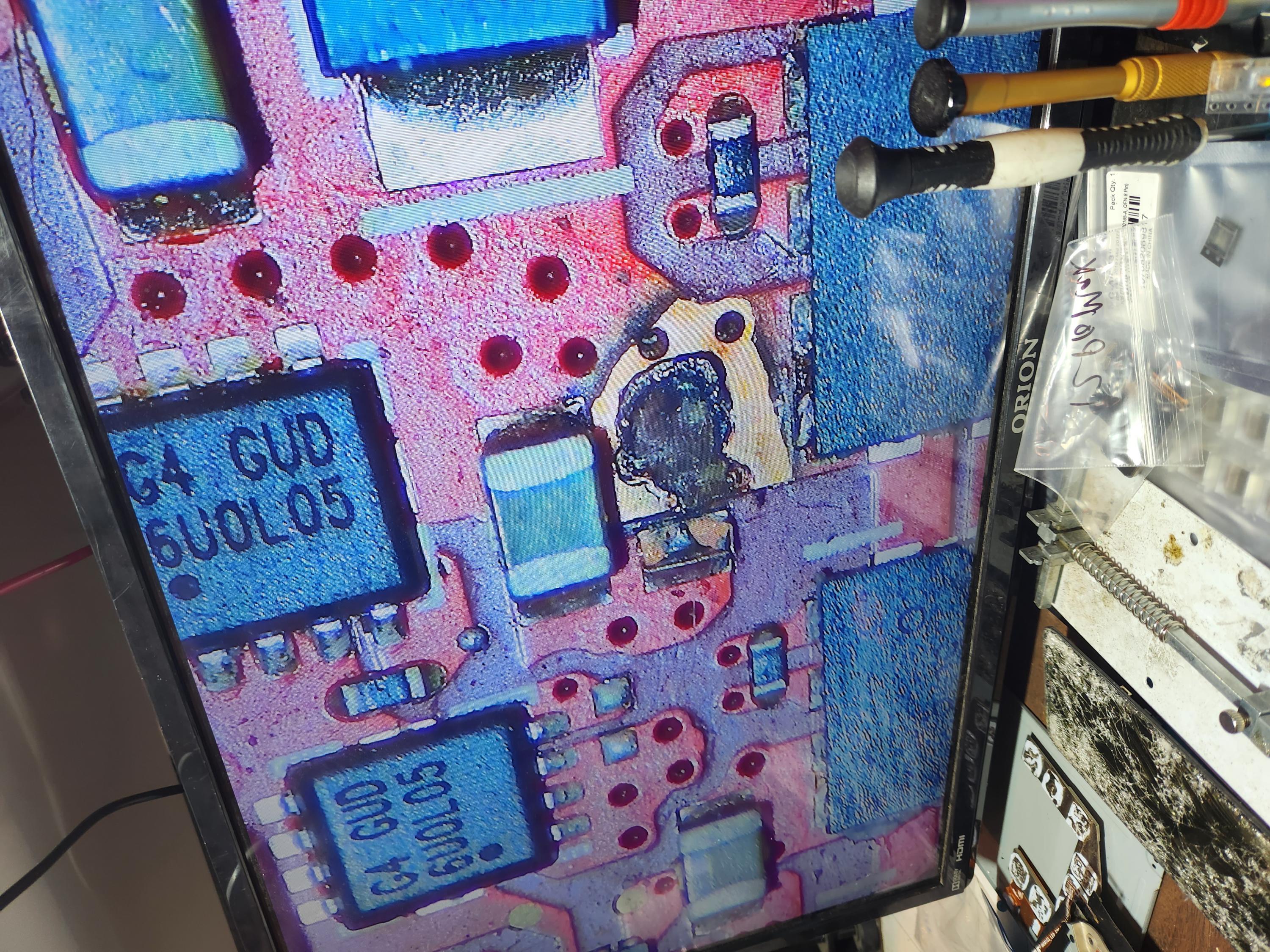

                                #35
                                what do u think brother ?

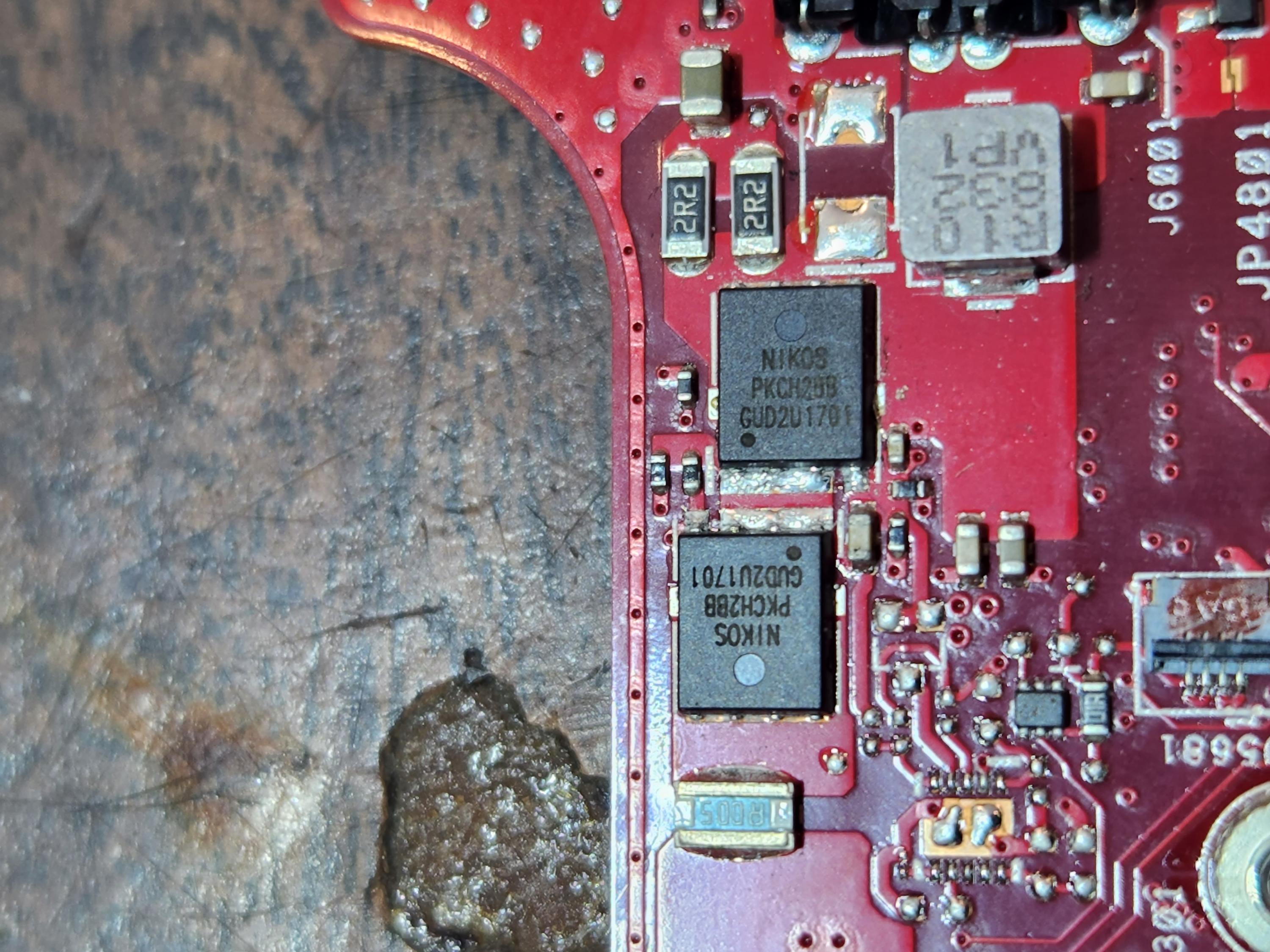

                                    To test mosfets, you can check the resistance between the pins of the device or check their diode mode readings. Found a great website that details both but let me summarize one method.
                                    Reference:
                                    https://electronicsbeliever.com/how-...-is-defective/
                                    Both methods must be with no power to the logic board.
                                    Checking in resistance mode is convenient.
                                    Meter in resistance mode.
                                    Measure the resistance across the mosfet pins as follows:
                                    Source (1-2-3) & Drain (5-6-7-8)
                                    Source (1-2-3) & gate (4)
                                    Gate (4) & Drain (5-6-7-8)
                                    Post each measurement. If the reading is low, the part is likely defective.
                                        Reference:
                                        ok it seems ike i found 2 bad mosfets?
                                        one right behind the charger port
                                        source grounded to drain
                                        the other small one near top of board where the cap burnt..
                                        Gate ( where dot is ) shorted to drain ( all 4 pins other side)
                                        gets 24 ohms beeps..
                                          Although it is a typical way how a DC-IN Mosfet shorts out, your resistance measurements does not makes sense at all regarding the previous observation.
                                          The two Mosfets on the first picture. What resistance do you measure between Source and Gate?
                                          The Dual-Mosfet near the burned via might be a secondary(!) issue which you might want to rule out later.
