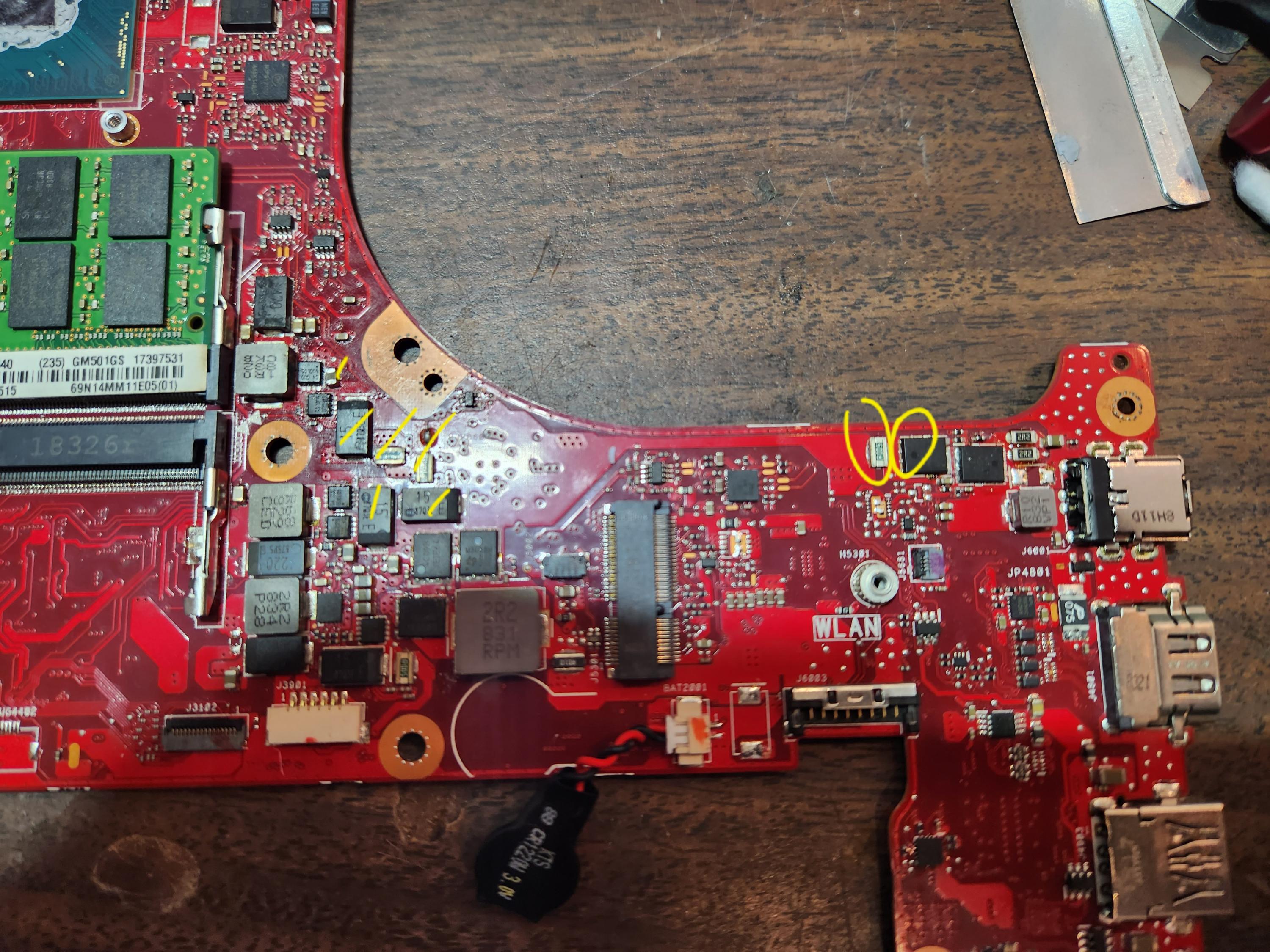

                #67
                Re: Asus Rog Laptop new battery still 0% Biard issue?
                Originally posted by Sephir0th
                Something must have happened or the board finally shows its "real face". Most likely you're dealing with a short to GND of the main power rail.
                So my advice will be to check Source and Drain of bith DC-IN mosfets to GND, in Ohms mode.
                a bunch of components are measuring 1-2 ohms to ground.. The 2nd dc jack mosfets drain also the fuse next to it and many more components ( both ends ) are measuring 1 ohm to ground..

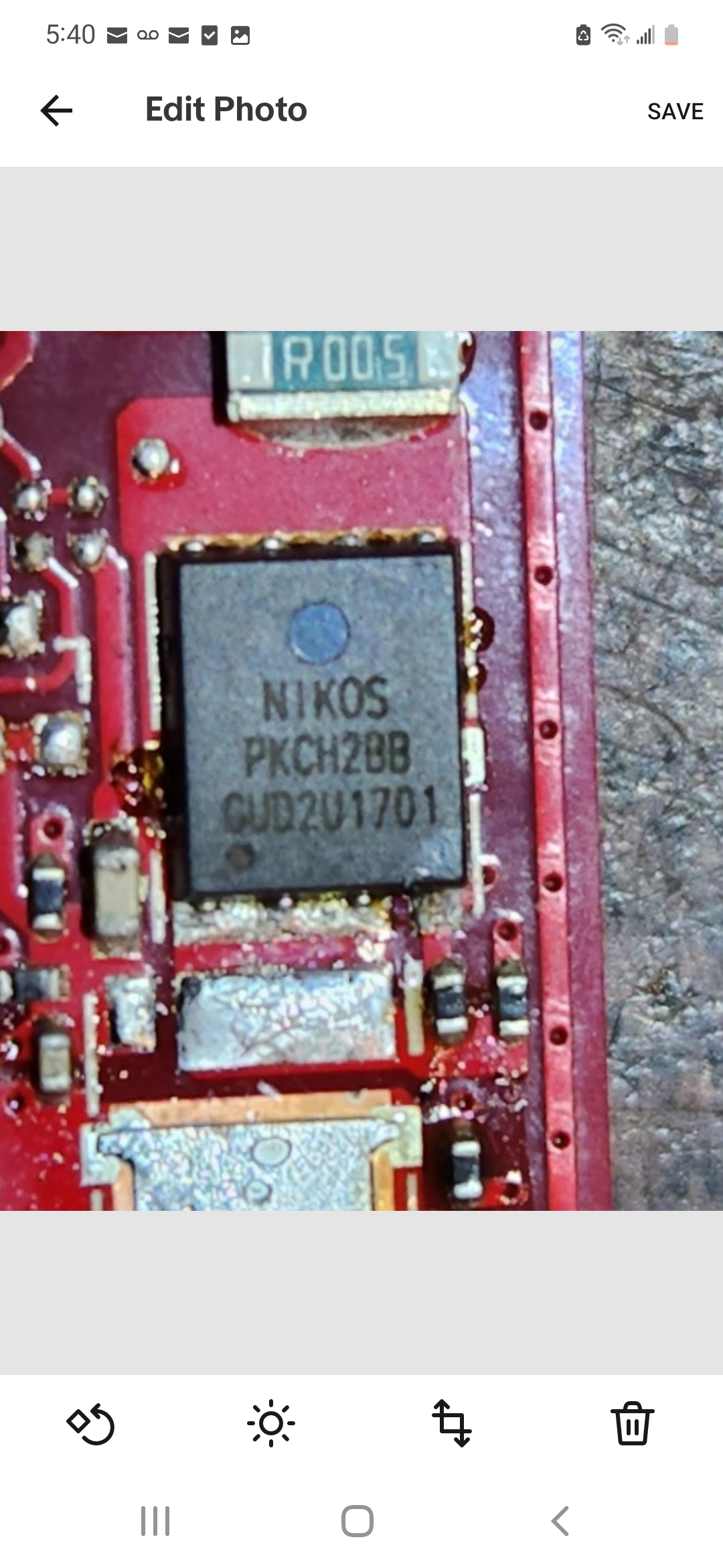

                  #68
                  The picture is a bit blurry but the 'fuse' is very likely a current sense resistor. It is, by design, a very low resistance component and is used to measure the current draw of the main power rail.
                  The charger IC will monitor the voltage going INto the current sense resistor and monitor the OUTput from the current sense resistor. There will be a small voltage drop across this resistor as there is a load on the line. The charger IC will read this small voltage drop and multiply it by a factor to determine the actual current being consumed by the load.
                  Have you replaced this 2nd DCin mosfet?
                  Either way, flux and remove this mosfet and then measure the resistance to ground again to see if the fault is gone or not.

                    #69
                    i removed the 2nd mosfet but still drain is shorted to ground ? should i install a new mosfet?

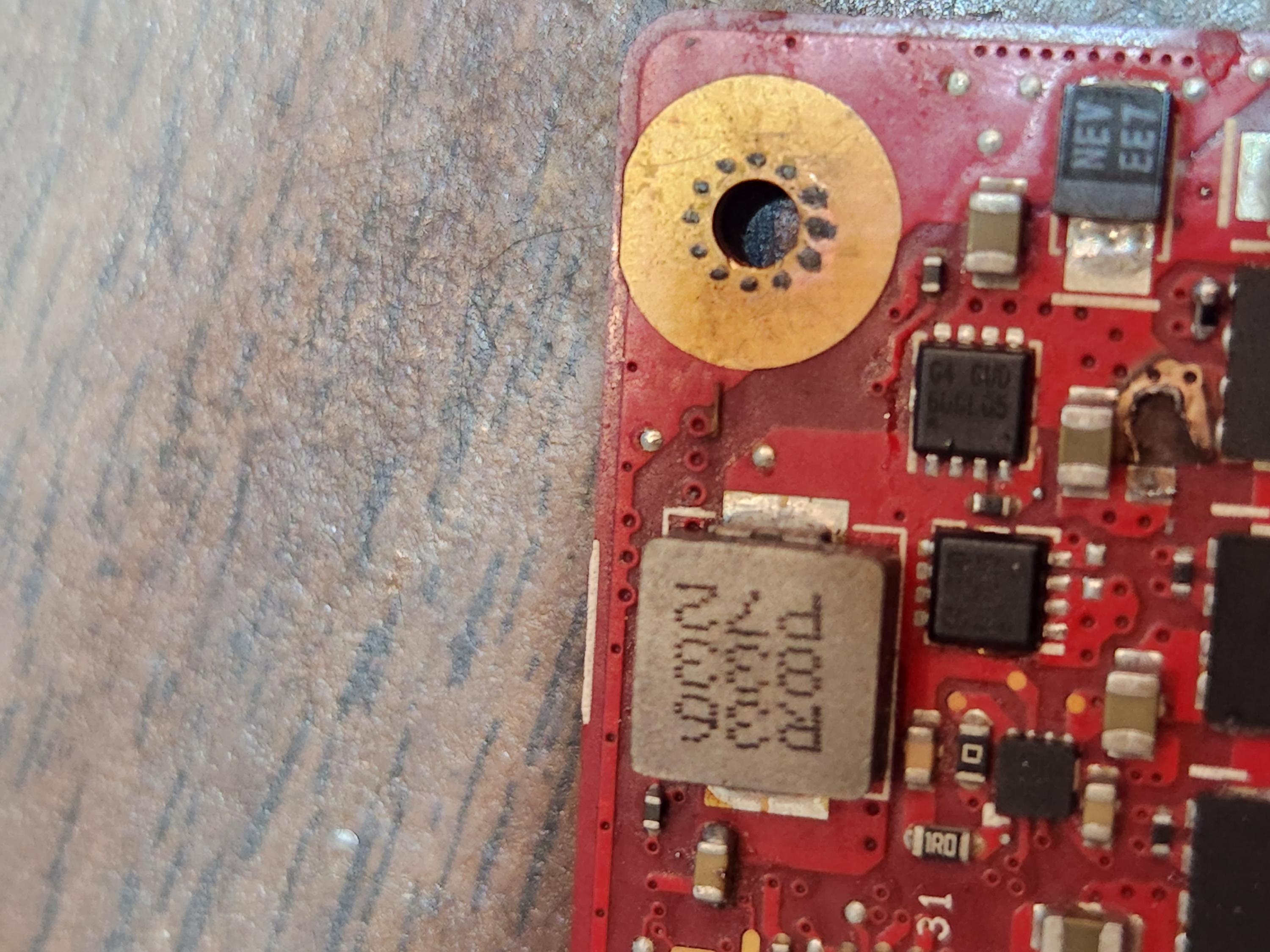

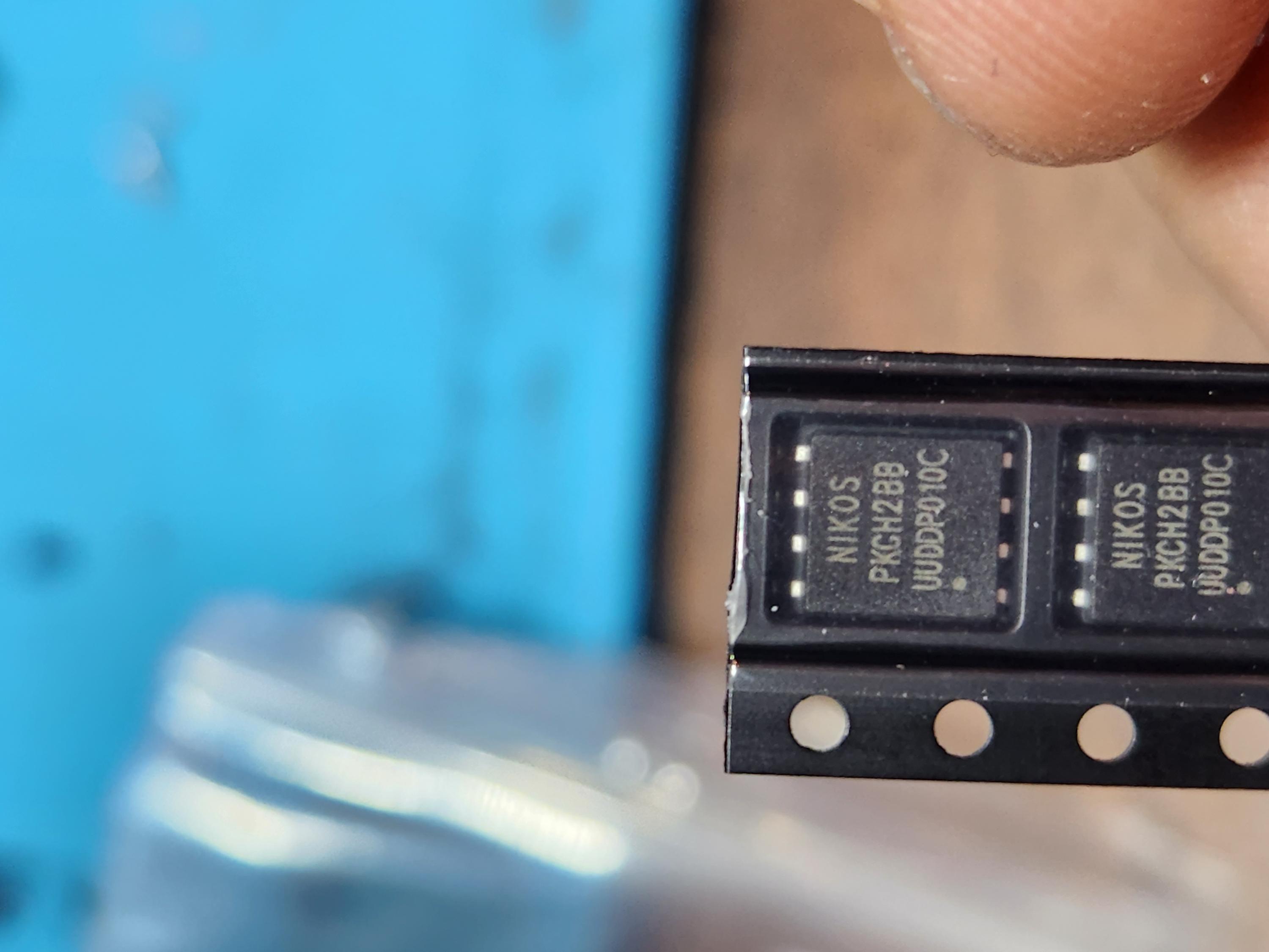

                        #71
                        Found the culprit , was the little moafet right above the old exploded cap burnt area.. was shorted in all directions.. removed it now short seems gone.. from the areas i mentioned..
                        Are these 2 mosfets the same
                        old one was G4 GUD 6UOI05
                        Replacement
                        KO3M5 DNS 0391
                        if not can you help me find the correct one from the US or if not from Ali express is ok

                          #72
                          Since CLR(Current sense resistor) located just after 2nd dc-in mosfet is showing 1 ohms to GND, its a clear cut short on +19V rail. Remove the CLR and check which side is shorted to GND and then proceed to inject 1V on the shorted side and wait for 5 mins. Try to feel if anything is warm. Voltage injection should'nt exceed 1V.
                          What do you think ?
