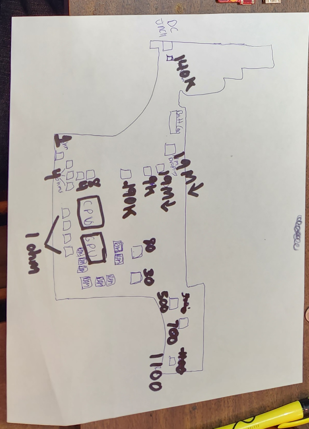

          coils ohm measurements are all diff, some are 1ohm near the cpu/gpu some are in the Kohm some are OL ? im just afraid if by changing the mosfets since there so close to the cpu /gpu if i fried them. How can i test the bios chip ?

            #85
            Re: Asus Rog Laptop new battery still 0% Biard issue?
            You need to give all resistance to ground over all board wothout any power and give also the voltage you have on the coils too that with power. so that somebody can help you where the problem is. Put it on hd picture. I said to see the board connect usb keyboard and see if capslock respond. If it does then will it say the board is posting and bios is working. Good luck

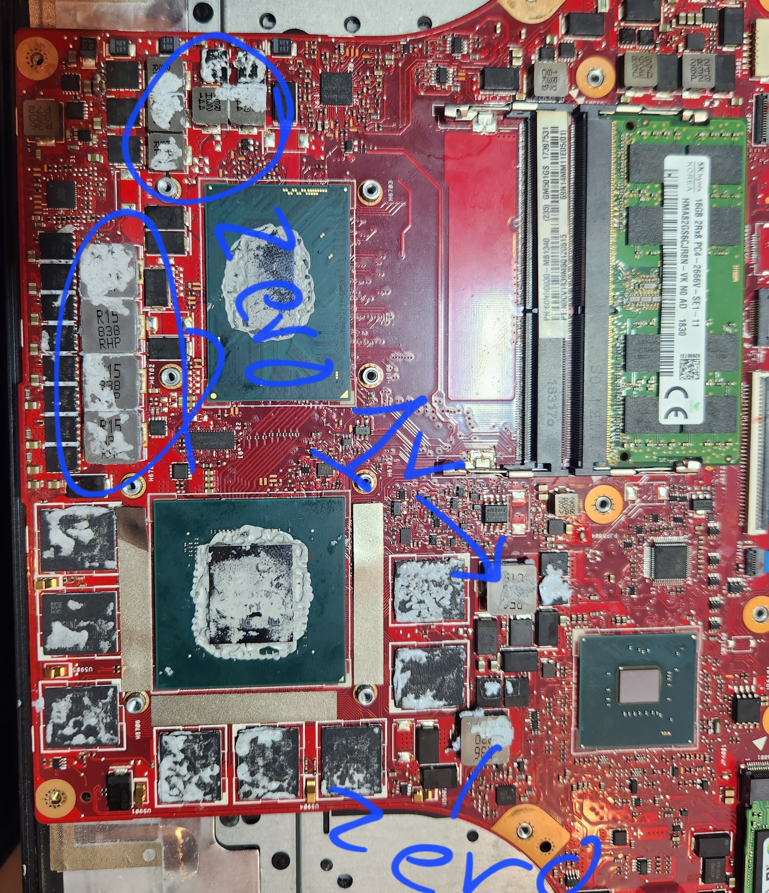

              #86
              All coils have voltages but the ones near the cpu have nothing.

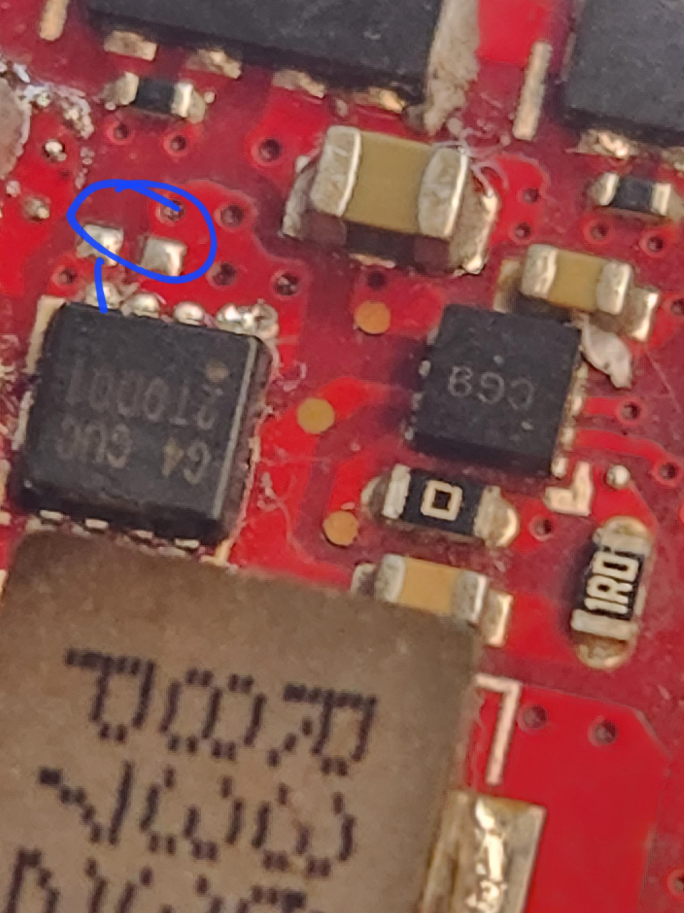

                #87

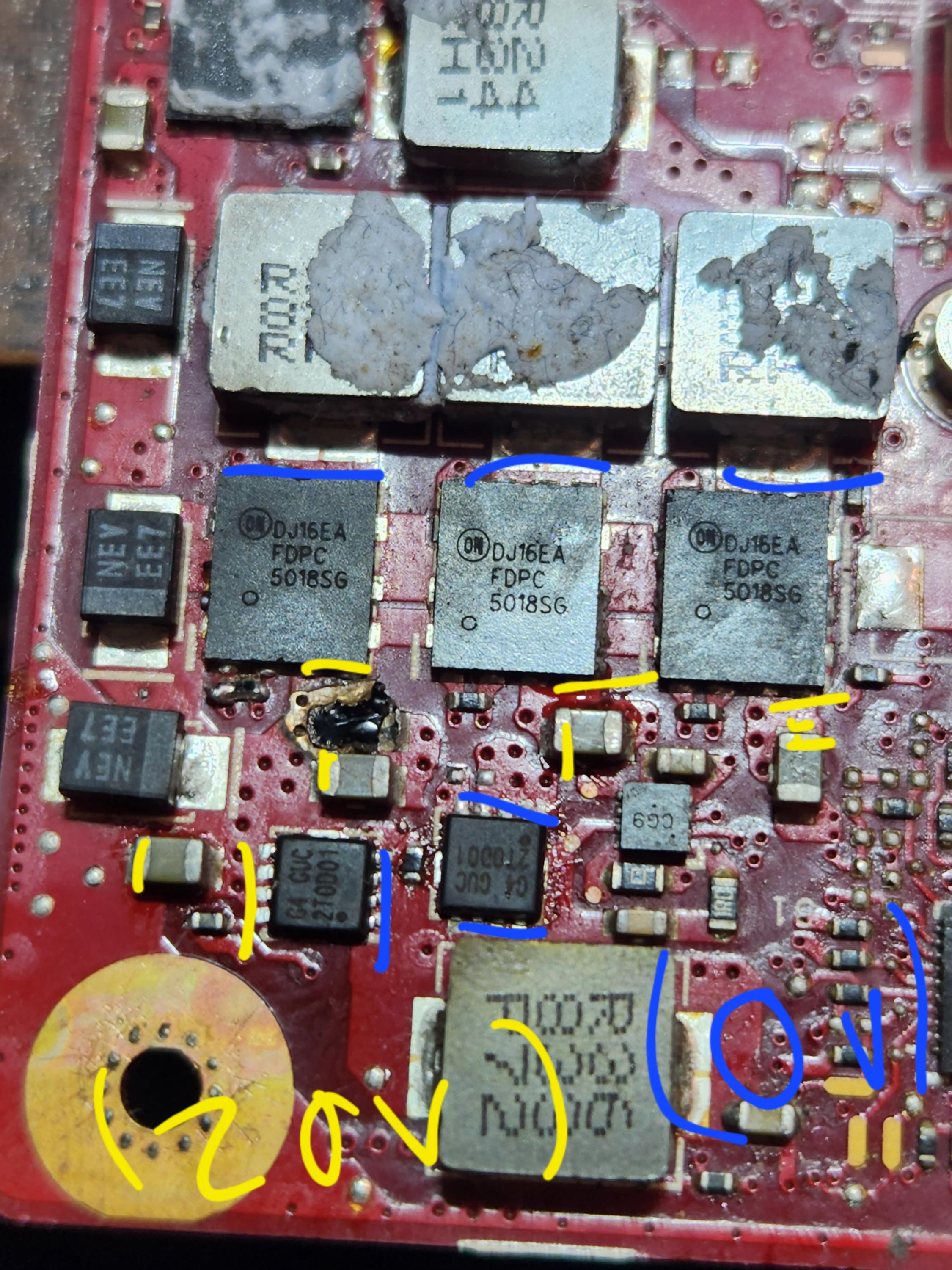

                Clear the mess in the circled area(black) and post a clear pic of the highlighted area. measure resistance to gnd on Vcore /VCCSA/VCCGT coils in ohms mode. No power should be attached while measuring resistance.
                • irepair559
                  • Dec 2022
                  • 134
                  #88
                  the ls a resistor on the left just bad soldering lol , the burnt cap area is cleaned no short thats just uv mask.
                  Which coils should i check ? sorry dont know what lines those are. I should get voltage on every mosfet right? but the G4 GUC mosfet one right under the burnt cap is getting no voltage on either side. maybe wring replacement mosfets? Original ones were G4 GUD , i only found G4 GUC ?

                    #89
                    Here are the coil ohm readings
                    Sorry for my bad drawing lol

                          #92
                          Originally posted by irepair559
                          No it doesnt boot.. Lights come on, hard drive spins and ssd gets warm. But wont boot. But why would those kick on withoit pressing the power bitton?
                          "coz the mb is turning on. This happens when you remove cmos cell/flash bios/backup battery not attached/removed. So thats not the issue. Vcore will rise after all its requirements are met(as long as its not shorted).
                          Check whether you have +VCC_SA/1.05V rails running. The resistance on CPU seems bit low to me-Have seen 2-3 ohms atleast but may be correct as its a gaming board.

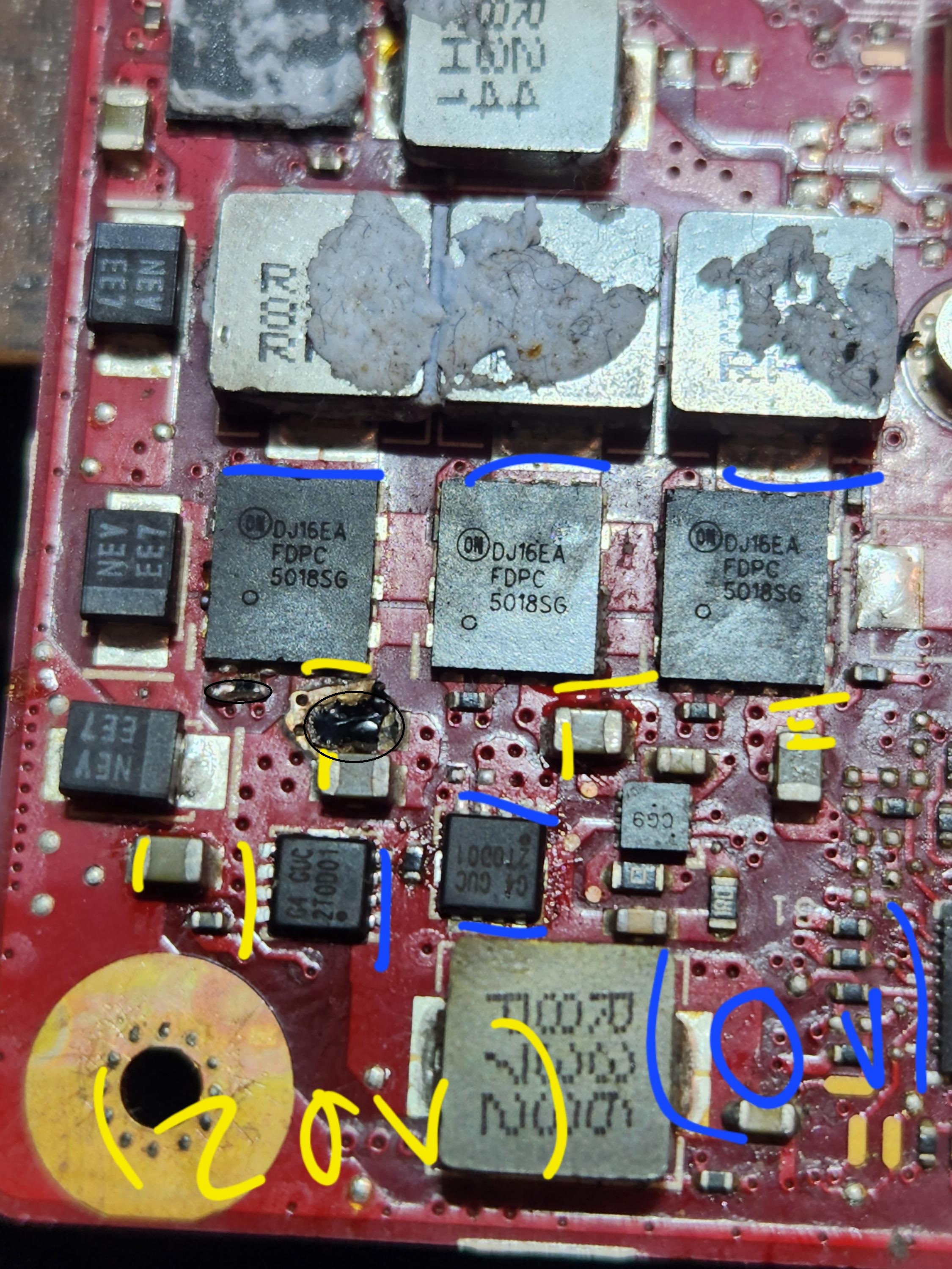

                                #95
                                VCCSA coil will be near to cpu. Normally 4 coils are there for vcore,one for vccgt and another one for vccsa. 1.05 rail coil should be near PCH. Post a clear photo of the area near cpu so that we can try to identify vccsa coil.

                                  #96
                                  Ok only 1 coil has 1v rest no voltage..
                                  I came across something interesting when measuring voltages on those little mosfets , they ones i pictured getting no voltage on any side. If i place my finger on it while measuring source i get voltage of 4-5v then dropping? ( its not loose solder joints i redid 3 times ) I think the gates on these mosfets need 5v to turn on? I do notice a restitor or something near those mosfets that has 4-5v maybe that line is cut? Is that possibly the line that feeds those mosfets gate?

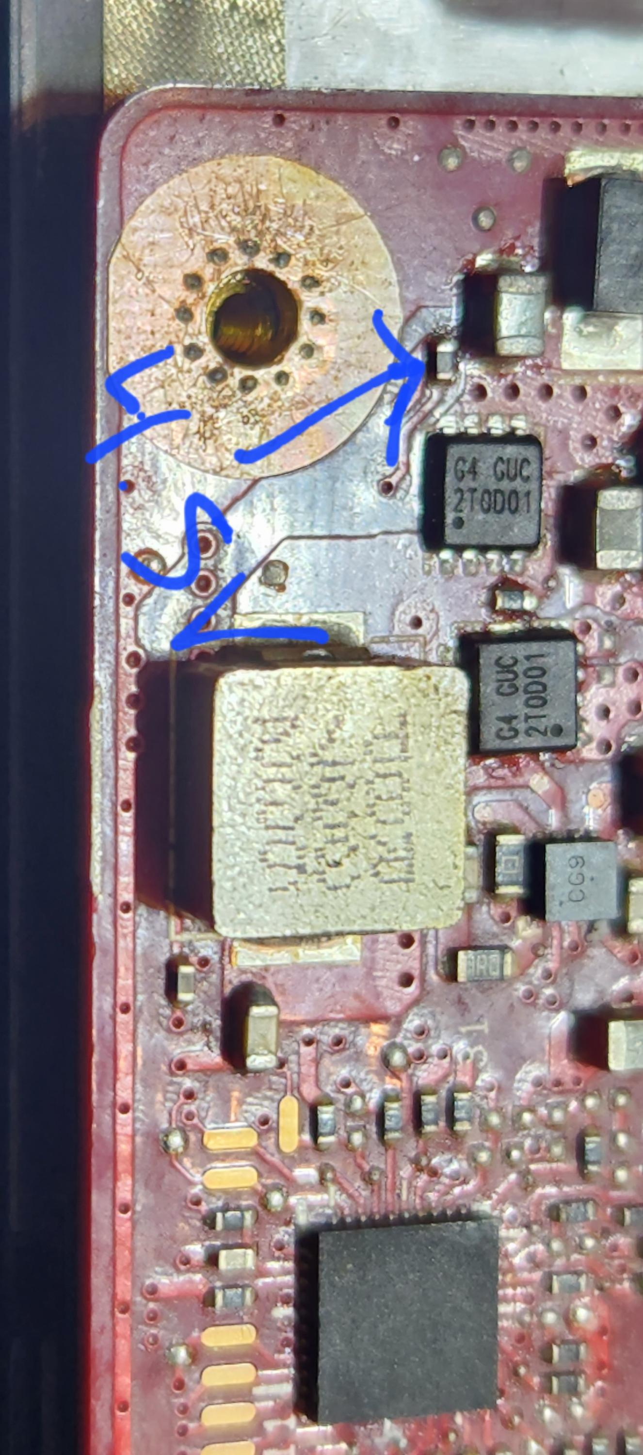

                                    #97
                                    i think i found the issue , maybe missing component here ?? These points have continuity to the gate? The other similar mosefts all have a component that connect to the gate.
                                    Its on the corner of the board near the gpu Asus GM501GS maybe a scematic will verify ?

                                      #98
                                      what do you think ??

                                        #99
                                        Cant say anything in absence of schematic but very likely its not populated from factory.

                                          #100
                                          ok got back to where it was last week.. was bad mosfet
                                          Now still stuck on lights on.. sata spins...ssd gers warm.. but cpu and gpu cold ( off ? )
                                          Can this be bios issue?, so close guys..
