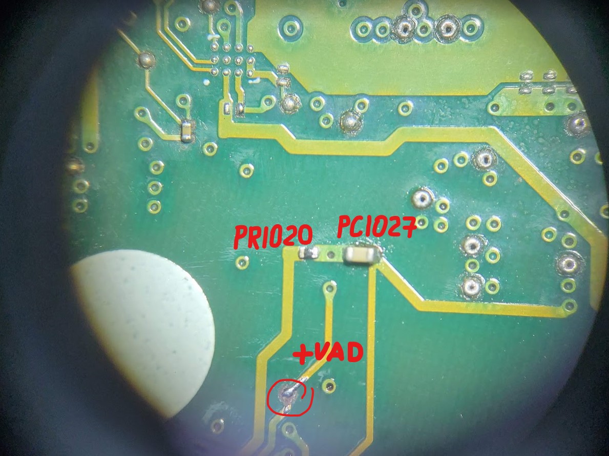

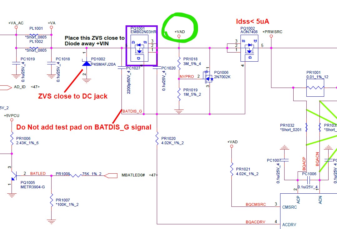

                I was able to fix it, but it was by pure luck and 0% skill, so I went back to the area that had sign of liquid and noticed a solder jumper with a brownish color, when I took off the solder, I could see the trace was broken, I soldered it with a wire and it worked, I got ACDRV and laptop also turns on with no problem.
                I checked the boardview and that trace was not in there, I was able to trace it back to +VAD, I'm glad I was able to repair this, but I would be more happy if I was able to diagnose that +VAD was the cause.
                Can someone explain to me how +VAD is necessary for ACDRV generation? I don't think it even feeds the charger IC, I'd be glad to be educated about it.
                I also undid everything (put back charger IC, ACDET resistor), all it needed was the trace to be repaired.

                  So you are saying you had no continuity between the source of PQ1001 and the source of PQ1002? Usually ACDRV will appear momentarily and the IC will give up after 7 tries if an abnormality is detected. You may have seen a pulsing when the board first has power applied to it. Since no voltage appeared at the drain of PQ1002, this is probably considered a short by the IC so it removes ACDRV.
                  PQ1006 is there for reverse polarity protection, and normally it's biased off. So I don't think it played a part.

                    Can you tell me the difference between +VA_AC, +VA and +VAD? Is the power adapter the source for all three? Thanks again.

                      Just different test points on the board really and a hangover from when the board was being developed. PL1001/1002 may have been fitted with RF chokes to pass some the RFI requirements in some countries, but in production were removed with shorts. From a troubleshooting perspective, +VA and +VAD are test points before and after the first FET.

                          Goes to charger IC CMSRC pin through PR1021.
