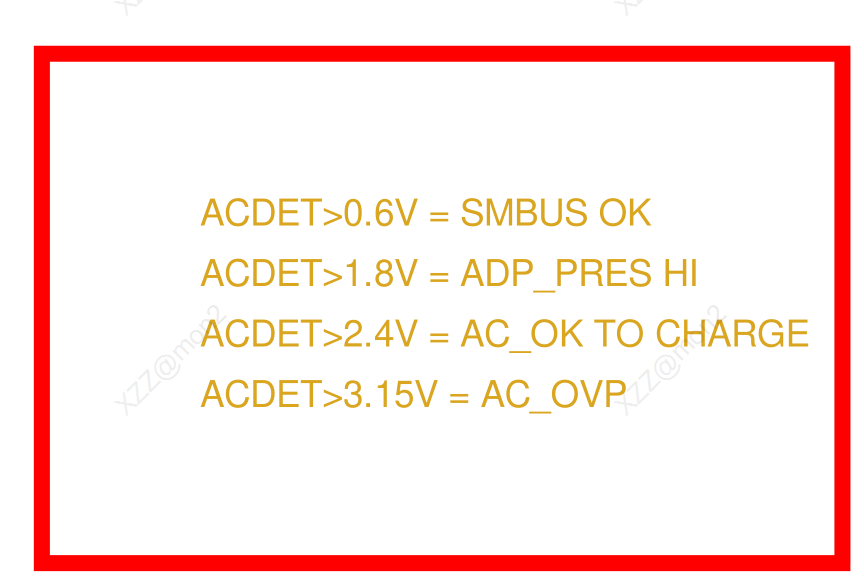

          From the datasheet for the charger IC. While this exact part is unique and not the datasheet is not public, you can check other available parts from Texas Instruments.
          The charger ic = BQ24728HRGRR and from my database, found the following.
          Remove all power. Meter in resistance mode.
          Measure the resistance of PR1024.
          Measure the resistance of PR66.
          Use an online resistor based voltage divider and insert the values you see from the schematic - the Digikey one is a good one to use.
          With 19v as the source (power adapter) and R1 = PR1024; R2 = PR66. In summary, if all is well, the ACDET should be 2v4 or higher with a 19v adapter.
