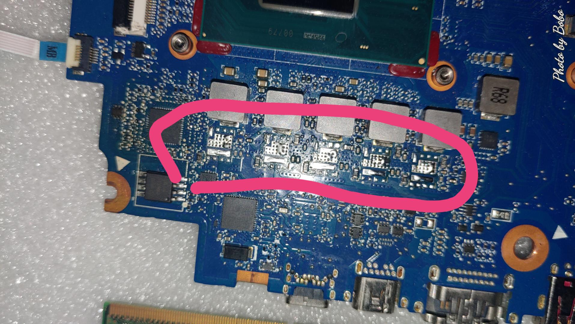

    Hi all.
    Please can you help me identification missing components on this board.

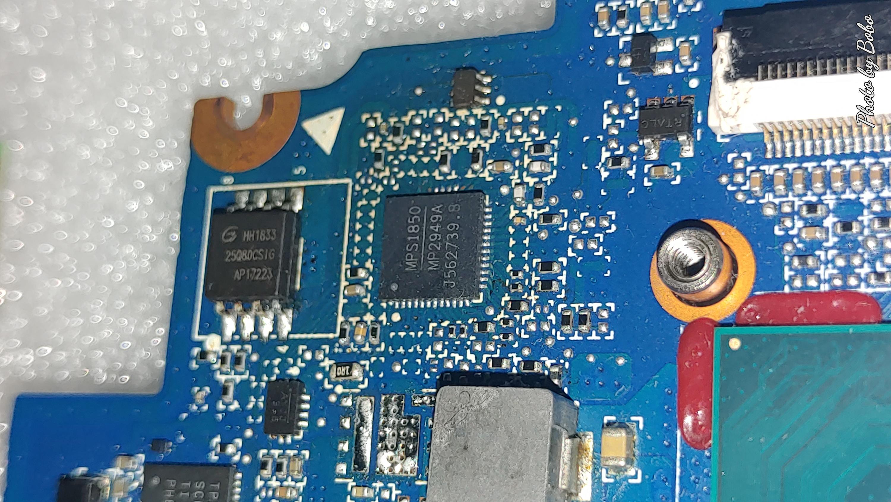

    Power IC is MP2949A.
    May be AOE6932
    Thank you so muche.

    Re: HP omen 15 - DAG3DBMB8D0 - Quanta G3DB missing components
    Hi, I think you are right, they are all AOE6932 like on the G3DD motherboard.
