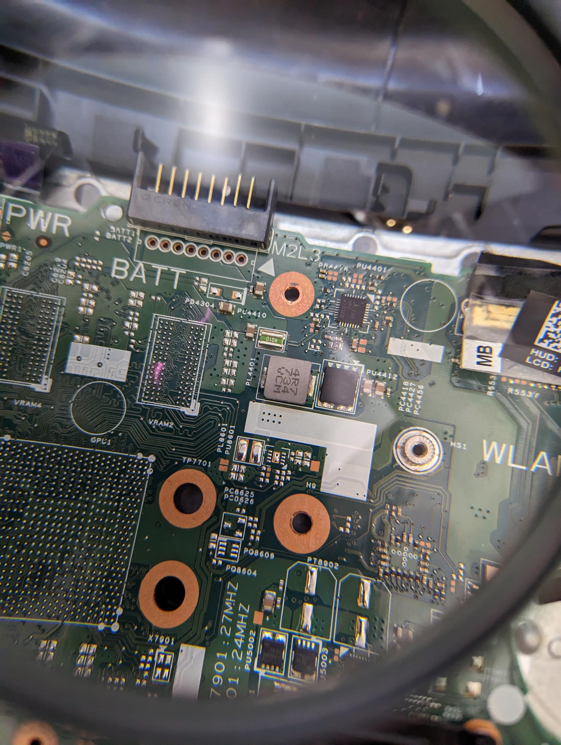

    thanks in advance for any help you can give.
    i have a vegus/turis skl/kbl
    15341-1
    91N85
    this came to me with broken hinges so I lovingly acquired the parts I needed and reassembled it all to find everything working except for the battery. It was @ 30% and drained to zero while installing the OS. When plugged in the laptop works. CPU at 100% when no battery installed and only 0.4ghz if battery and AC are both plugged in.
    i tried 3 different batteries and 2 different chargers so it's down to motherboard.
    IR camera doesn't show any obvious over heated components. I thought I saw damage to the ncp81208 but new one looks the same so maybe not.
    Now I'd like to understand the circuits and repair. Would someone be willing to walk me through it? I gather the mosfet may need replacing from the sticky but not sure how to find it.

    Does it shows the correct wattage of adapter in bios setup screen?? If no,then your problem is PS_ID circuit.
    Next measure voltage on PU4301/PQ4410 for Pin 1/4/8.
    All the measurements should be without battery,only adapter connected.
    Voltage on PL4401 also.
    Report back and then we decide and may opt for resistance check and some voltage measurements on charging ic PU4401.

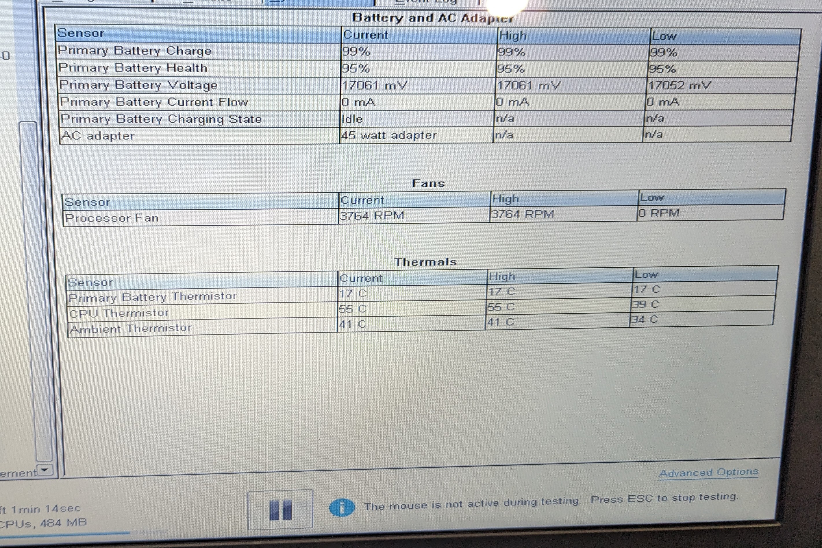

      Bios shows the correct wattage.
      Bios also reports status of battery as charging, but reports current as 0 mA. (the battery said charging before, I think it shows idle in the screenshot below because it was nearly full and wasn't calling for a charge)

        Re: dell 3567 / AC fine, but Battery not charging and CPU @ 0.4ghz if battery not rem
        Image from bios
          PIN1 = 42.1v
          PIN4 = 6.1v
          PIN8 = 42.1V (PINS 7&8 are joint in same solder, as is 5&6)
          PIN1=42.1V
          PIN4=3.2V
          PIN8=42.1V (PINS 7&8 are joint in same solder, as is 5&6)
          PL4401 I'm not sure how to test... looking that up now. It is labelled 4R7 734 VCM and seems to have only 2 pins?

                      For checking the voltage, you will measure to ground.
                      Meter in DC volts mode (30v or higher is recommended since the adapter is ~19v).
                      Black meter probe to ground on the logic board (shield is ok).
                      Red meter probe to the point to measure.
                      For N-channel mosfets, the GATE pin # 4 is expected to be ~25 volts to ENABLE.
                      gate pin # 4 = adapter voltage + REGN voltage (~6 v) = ~25v.
                      For P-channel mosfets, the GATE pin # 4 should be LOWER than the voltage passing between SOURCE & DRAIN pins to ENABLE.
                      Continue to review & post the list of voltage checks requested by @mcplslg123.

                                Hmm.. The image at post#4 shows battery is at 99% charge level. Discharge the battery to atlest 90% and then plug the adapter.Does it charge now??
                                PS:Measurements at post#7 are correct and that proves nothing is wrong with these mosfets.
                                    I already discharged the battery to 80% since taking that picture. it says charging but current is still 0ma on bios. I just don't have a screenshot.
