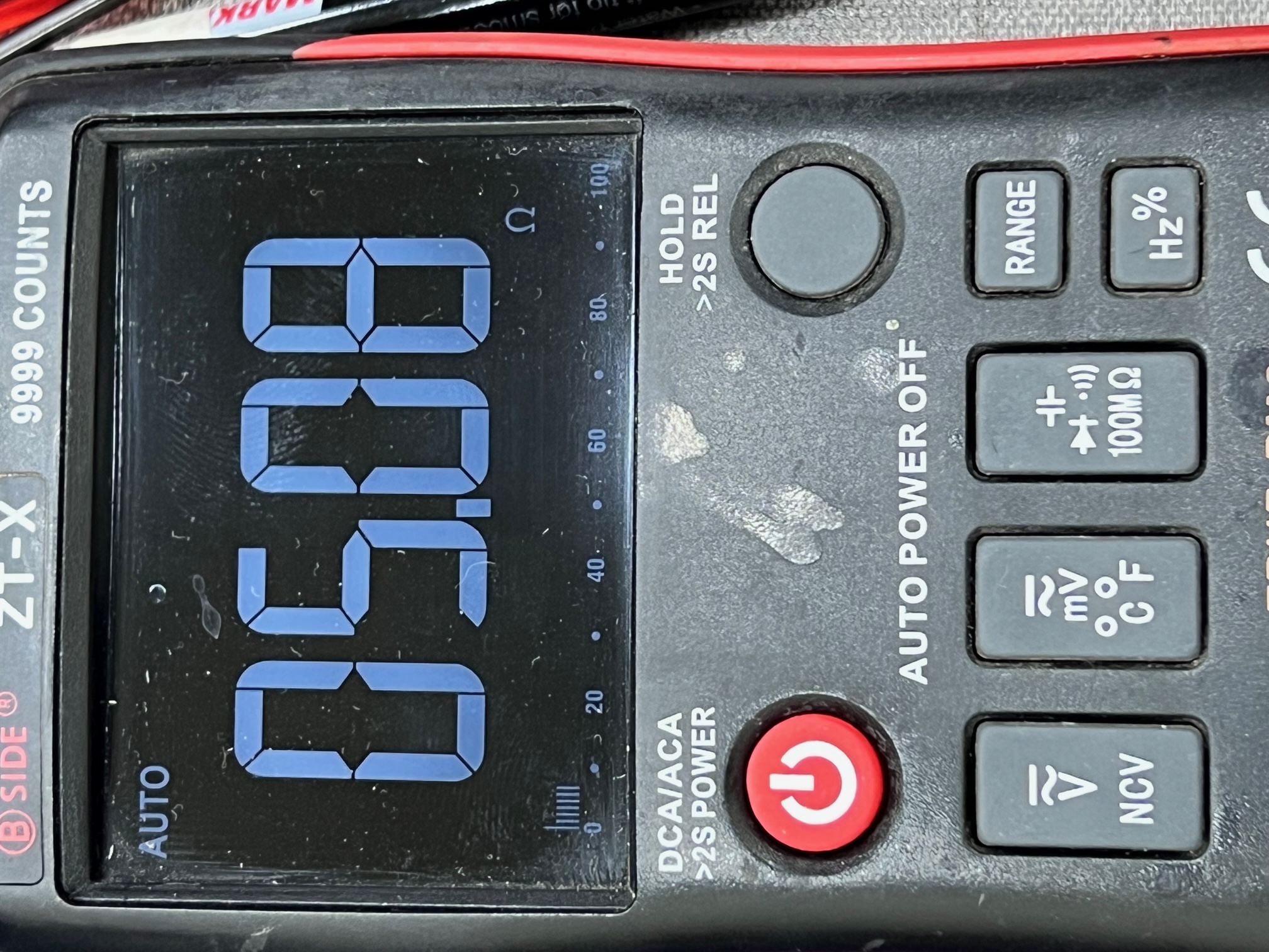

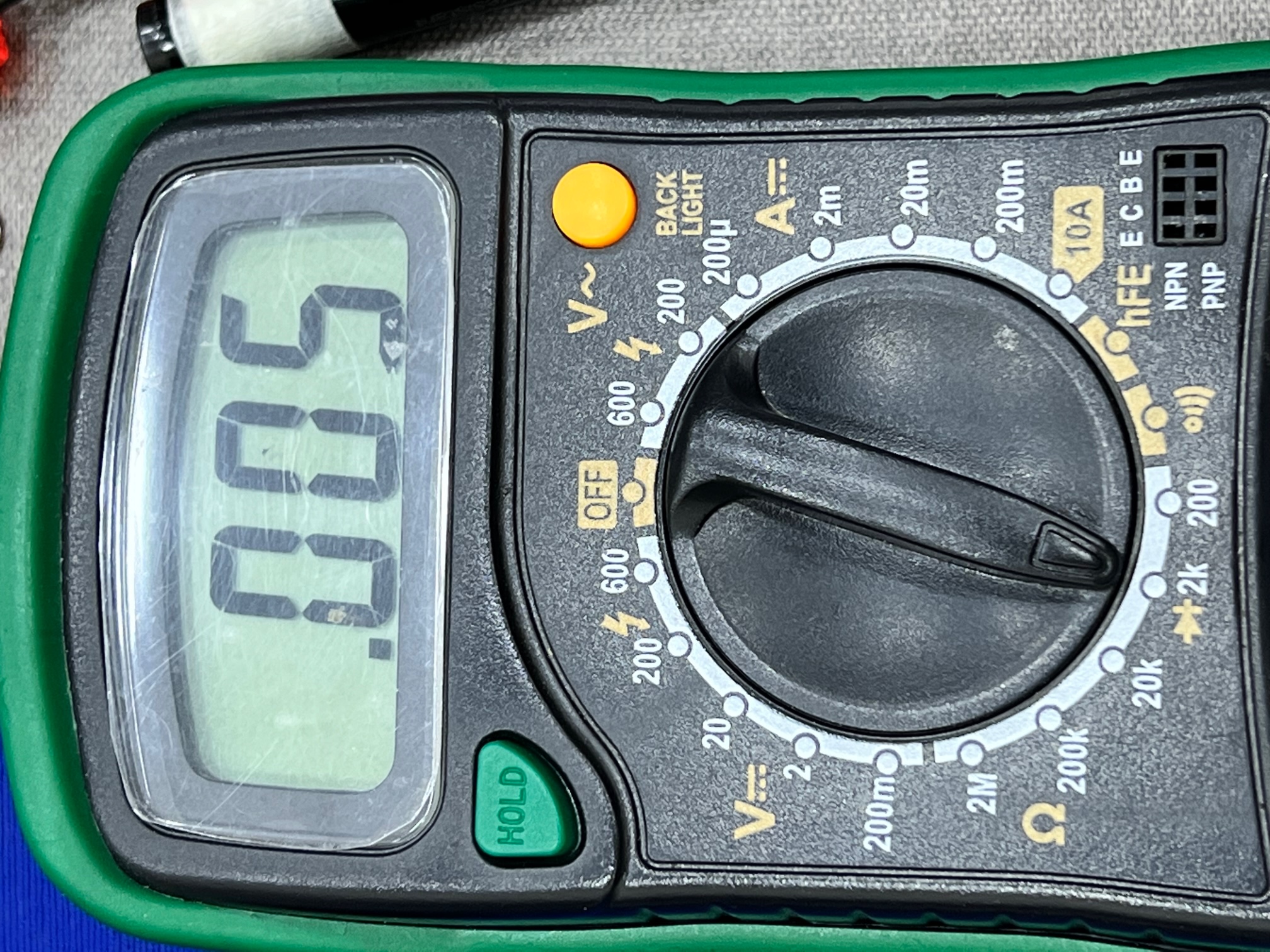

      CPU isnt very hot. Its normal heating. The heatsink is there.
      PPVCC_S0_CPU checked at C10G1 .
      Meter is Resistance Mode (Omega Sign) 5.08 ohms
      Meter is 2K Mode (Analog Meter) its 0.05.
      (Both Images attached)

        Switch the (first) digital meter to the lower 200 ohm scale and measure again. The resistance looks ok for the CPU.

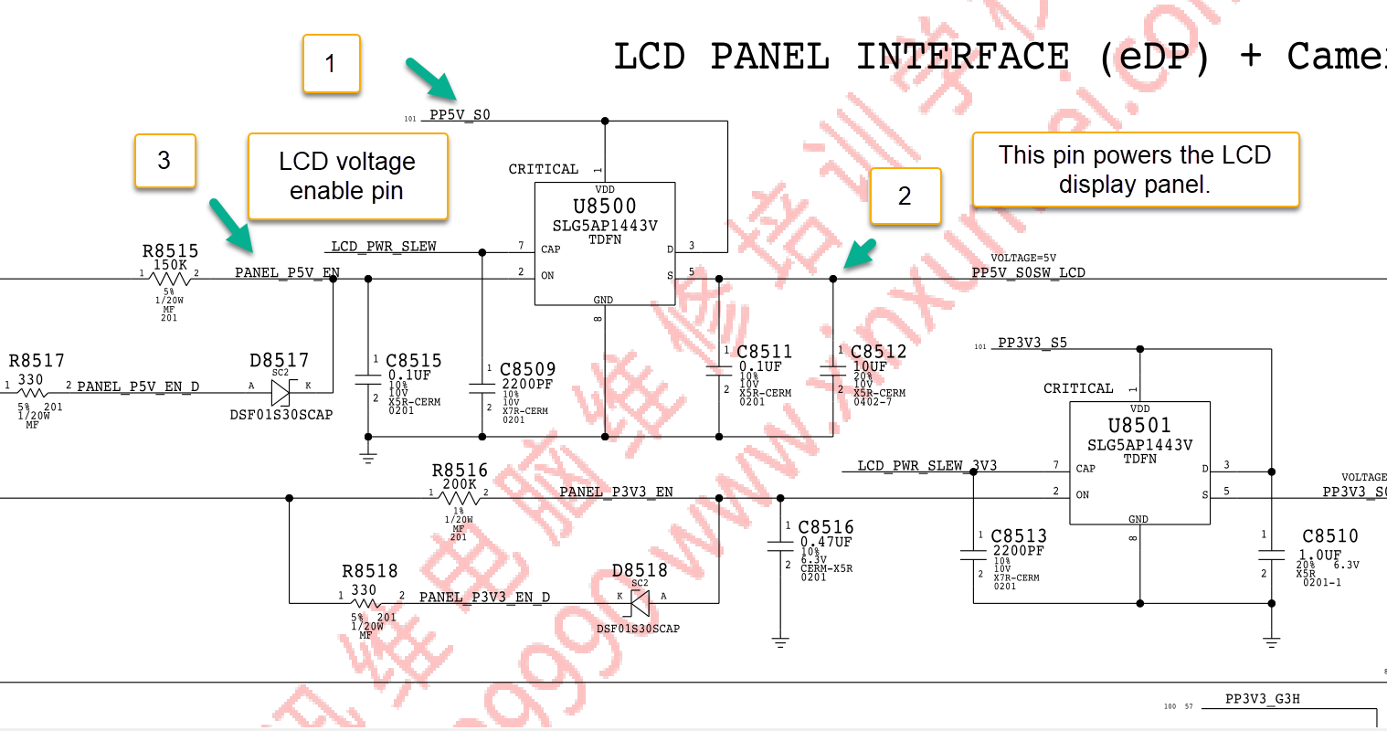

        See attached. Measure the voltage to ground of each point of interest.
        U8500 is a load switch. Fancy name for a solid state relay and is used to power the LCD display. If you are not measuring a voltage to power the display / camera then the wiring that was applied should be reviewed and also the linked regulators.
        Confirm that U8500 is being powered; being enabled. Post each measurement.

          The voltage at all points of U8500 is 0.
          Since the area is a bit cramped hence i checked corresponding points on other area of the board for the same line. Its 0V.
          The amp meter shows that the board is pulling 19.7V.
          (Nothing is connected to the board except the charger.)
          Setting the resistance to 200 i am getting 5.1 ohms at C10G1.

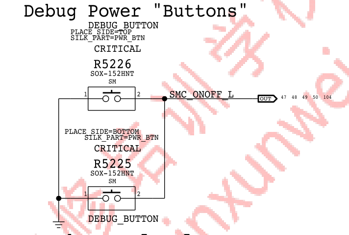

                See attached - does the board turn ON/OFF with the button presses?
                If yes, measure PM_PWRBTN_L voltage to ground as you press the same button(s). What voltage do you measure?

                  No the board doesnt turn on/off with the button pressed.

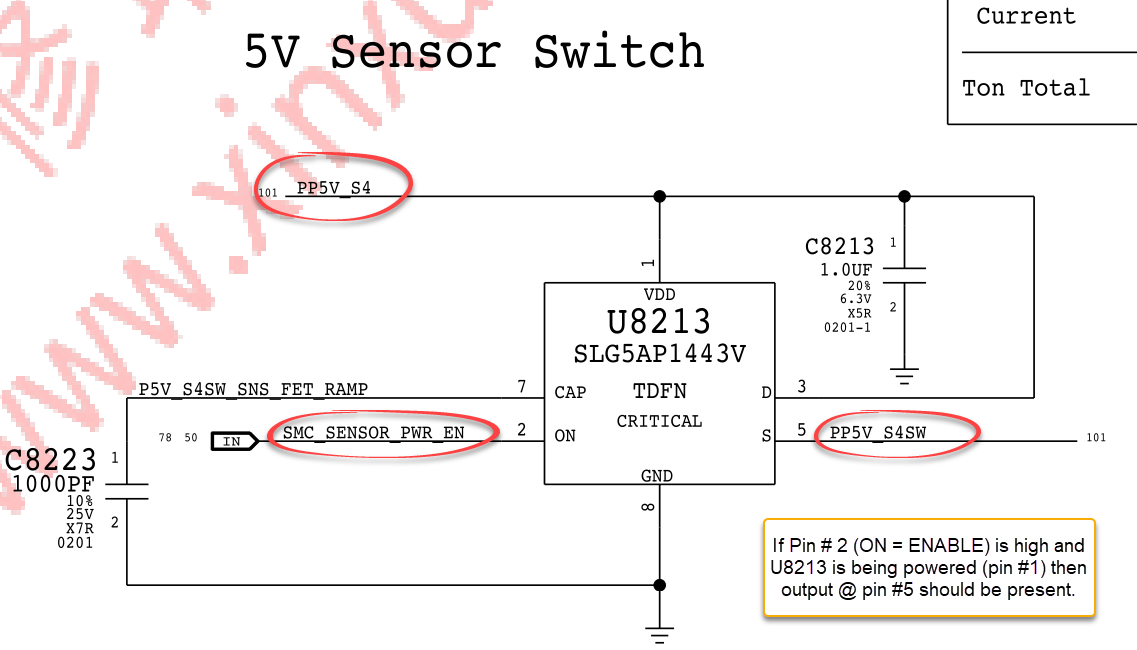

                    What is the voltage to ground of SMC_SENSOR_PWR_EN ?
                    Review u8213.

                          SMC_SENSOR_PWR_EN at U8213 Pin#2 is 3.39V.
                          Pin#5/6 and Pin#7 is Missing.

                                What is the voltage on pin # 1 of U8213 ?
                                Confirm each of the voltages on U8213.
                                If this part is being powered AND being ENABLED, then output should be present.
                                Either this load switch is defective OR the output rail is being shorted.
                                Remove all power -> meter in resistance mode and check the output pin # 5 to ground.
                                What is the resistance reading of PP5V_S4SW to ground ?

                                    U8213
                                    Voltages
                                    Pin# 1 5.13V
                                    Pin# 2 3.38V
                                    Pin#3/4 5.13V
                                    Pin#5/6 0.09V
                                    Pin#7 0.09V
                                    Pin# 8 GND
                                    Resistance (Omega Mode)
                                    Pin # 5 is 5.4.

                                        To me, U8213 is defective and should be replaced. This is a load switch that is being enabled but the voltage is not present at the output pin # 5.
