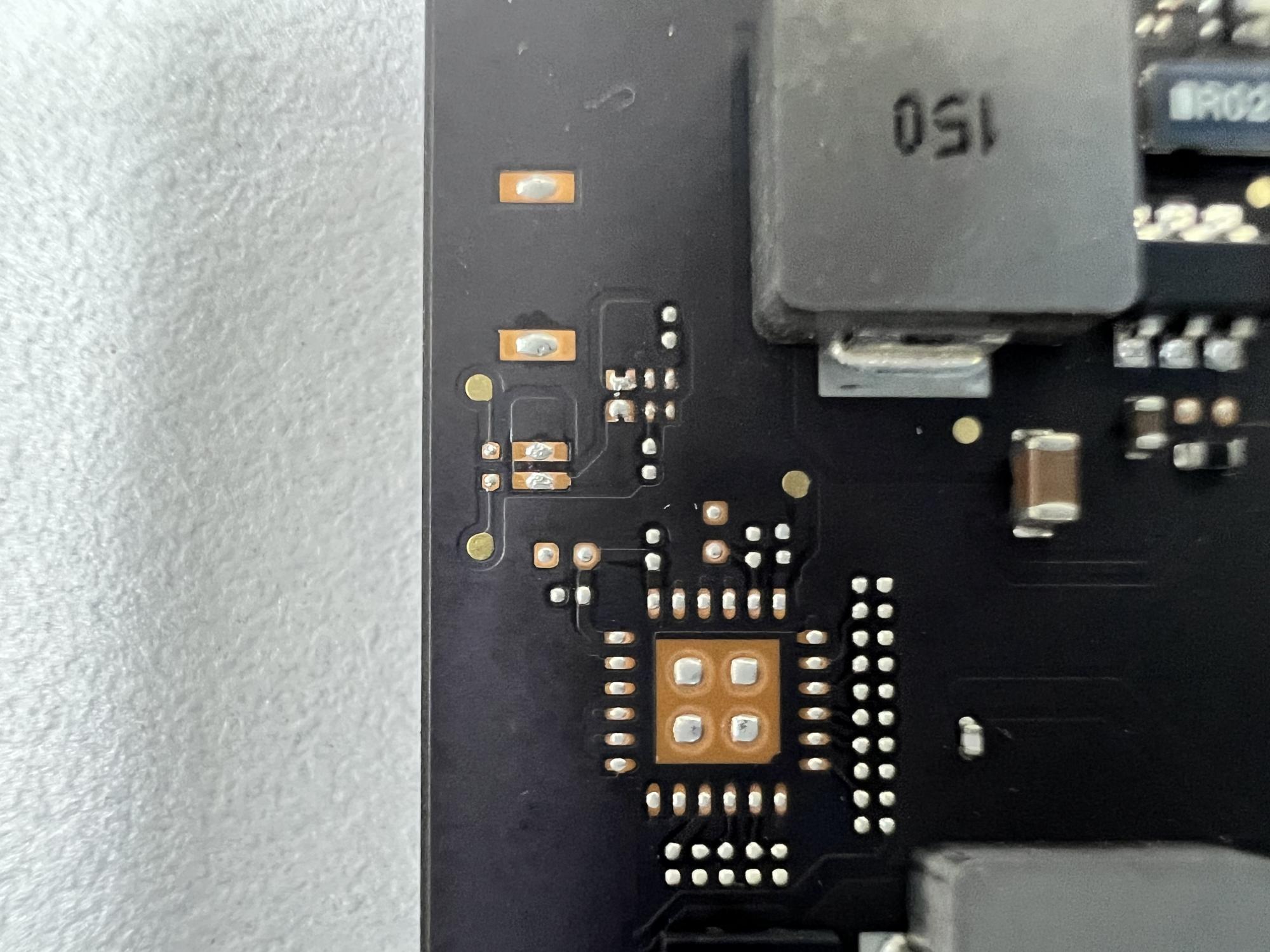

    To me, U8213 is defective and should be replaced. This is a load switch that is being enabled but the voltage is not present at the output pin # 5.
    But there is no component here. Its like this. See Attachment
    How to replace this??

          Re: Macbook 820-00923
          Can you confirm if the markings of your board = 820-00923 ?
          From the schematic, they look as though the parts should be there but given that this laptop was working before, there must be an alternative bill of materials.
            Yes it is 820-00923.
            I checked with other dead boards as well. This particular components are not there.
              Originally posted by Instafixx
              What about this?
              You haven't posted measurements.
              LOADISNS BOM option is only populated on engineering boards as indicated by the BOM configuration.
                Getting 1.2V at Pin # 1 of C7907

                      #30
                      Hi. From Louis' forums:
                      If U8213 is not factory installed
                      Then PP5V_S4SW is not required.
                      Can you check it?

                        #31
                        Can you check it?
                        Its 100% confirmed that it is not factory installed
