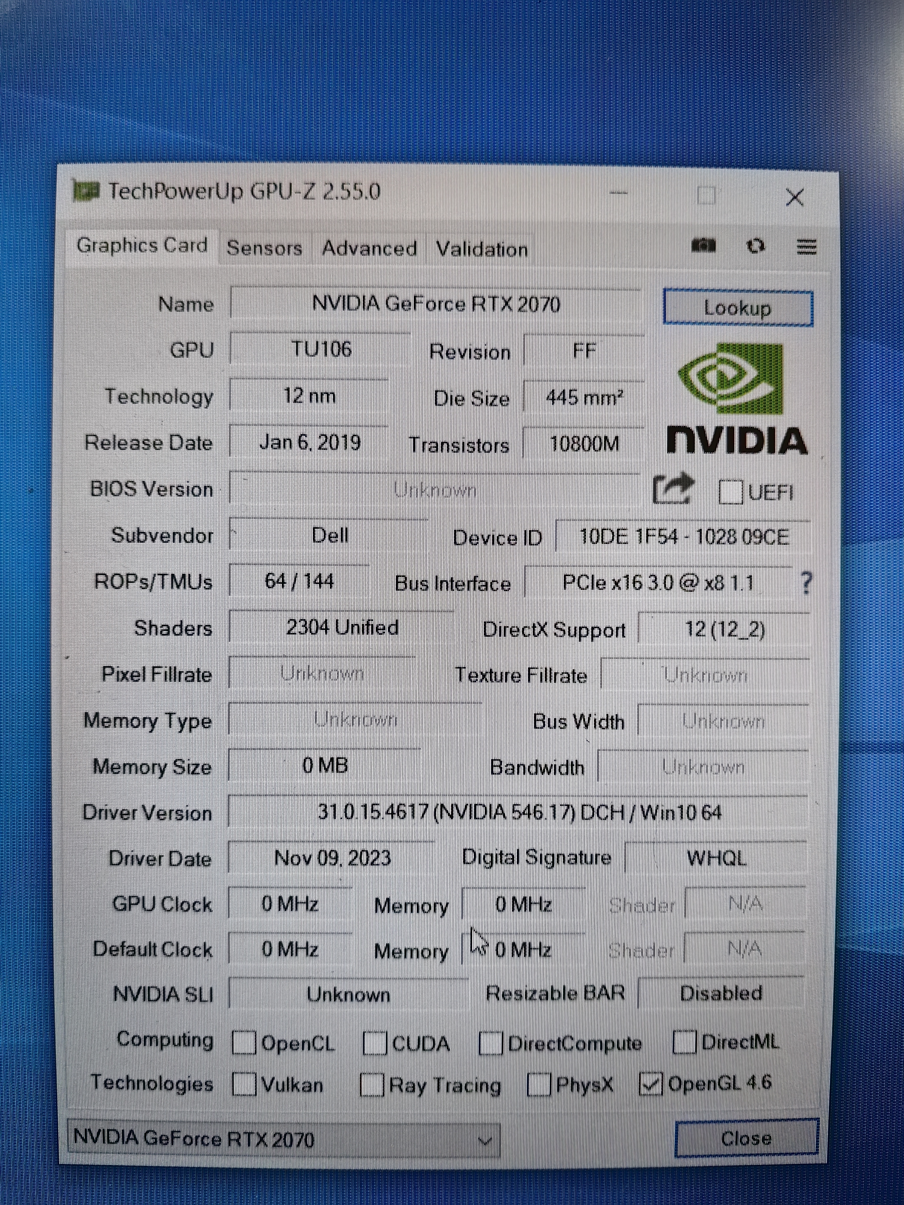

            Can anybody tell me what's expected voltage for +NVVDD? My graphic card doesn't work, it's RTX 2070. I got 1.2V on VRAM and 0.813V on NVVDD. Only VBIOS I managed to find with same device ID is from Clevo laptop which is strange, and when I flash it laptop stays black just before loading windows. With that VBIOS my NVVDD voltage is 0.697V. Also not sure why it loses picture when it displays over Intel anyway, at least I think so. However, I was thinking if 0.813V was low too, maybe it needs to be higher.
            Anybody got a idea what to check?
