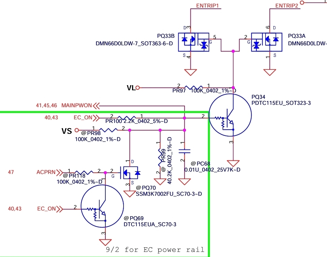

    Hello.
    Have this Alienware M18X R2 LA-8321P with no 3.3/5VALW. IC is RT8205. Have VIN, have EN, have REG 3.3/5, mosfets ok
    With controller resistance on both rails are only 15ohm when connected and disconnected power. Without it it is high. replaced IC but still the same
    When i inject it have very low consumption
    where can be fault?

          more like that controller after getting power put that two mosfets to 15 ohm
          • Sephir0th
            • Oct 2020
            • 1283
            This is normal.
            We're discussing here about completely normal behaviour of a PWM-Controller. It sets itself into protection. You need to wait until the circuit is discharged. This can take a while. Then you can measure the "real" resistance to GND of the rails.
            Additionally the EN pin doesn't control the buck converters, but it is responsible only for basic function and the LDOs.
            The Step-Down voltages are enabled from ENTRIP1 and ENTRIP2 instead which can be found out while reading the datasheet of the IC. The circuit can be watched in the schematics and your real job is to understand what is missing and why.
