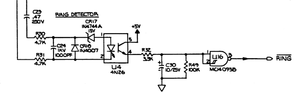

      I extracted the schematic out of the manual... I should have done this the first place, but it was getting late last night.
      Yes, these Zetron's are a bit dated, but replacing all of them for newer model isn't going to happen. They are quite bullet proof and yes, I did check the input protection to see what's going on there, but it was fine. I am not much of a phone guy, but I do know that much that the ring voltage out of most ATA's is not 90V AC. Also with ATA I mean a simple box like a Granstream etc, not some card to stick in a fancy phone system.
      Modding the ring detection circuit by changing the zener diode CR17 may be worth a try, it may also need lower resistor values in R30 and R31.
      Problem with this idea is that I have to go to each unit, put a temporary Zetron in that needs to be programmed same way. Not so much of a problem using the TL-866II and using an EEPROM rather than an EPROM plus a spare battery backed up S-RAM (because then I wouldn't need a stack of EPROMs or bring an UV eraser with me too). Clone the EPROM, clone the S-RAM, install the temporary Zetron. Then mod the original unit as such that the new modification is switchable or auto switch, so both systems can be used. Then go to each spot and change these Zetron's out again in order to put the original one back. There is only one spare Zetron, so I can't go and switch out a dozen at once. That's would keep me busy for a long time and is a pain in the doin it that way... just for a backup solution. But I have been surprised before.

                  If you can, measure the ring voltage going into the Zetron. Some multimeters will not read properly on ACV when there is DCV present. At least say 50VAC should be enough to be a ring, unless the Zetron has some hardware problems. There are transients and lightning that can zap the ring detect capacitor, but I find then a device will just go and stay off-hook when connected, a steady DC load does that.
                  Some better analog phone tech meets the FCC 600VAC surge spec using MOV's or gas-tubes, some PTC's.
                  You could post pics of it, to see how the circuit does ring detect and why that is finnicky to an ATA. It could be a grounding issue too, if the Zetron is earth-grounded and the ATA too then tip/ring polarity matters.

                      I missed the schematic - it's your typical ring detect circuit, about 0.1 REN load and needing at least say ~30VAC min. to light the opto-coupler LED. An ATA should drive it no prob. RING also activates the front panel LED. It looks like there is no battery to store a config such as # rings.
                      So I'm wondering if it is the relay or something else not working.
                      Fluke multimeters are AC-coupled so they don't get messed up with DC present.

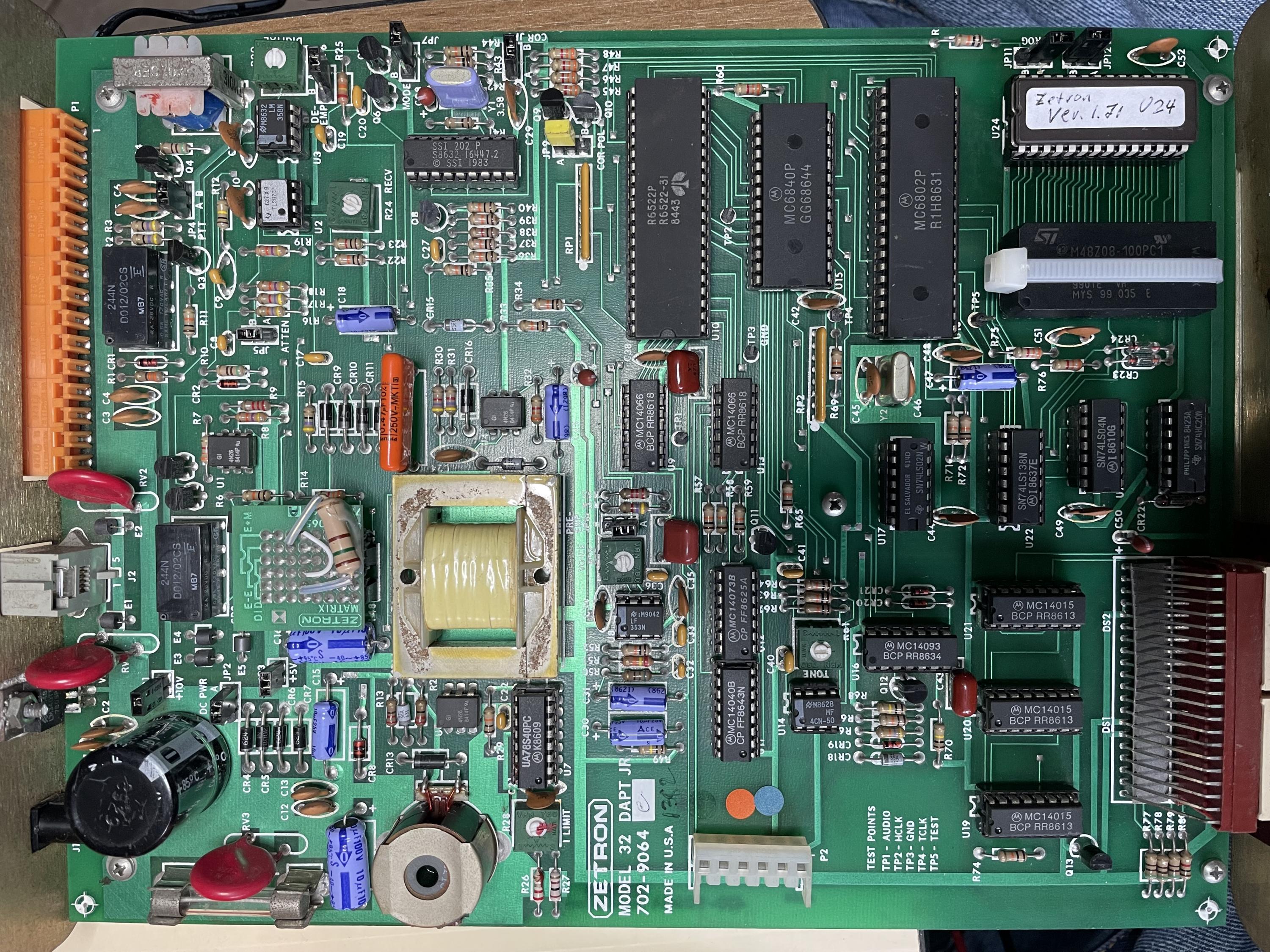

                            Things are weird all right. So here is what I got.
                            ATA = Grandstream HT701
                            1 old rotary pulse dial phone with a bell ringer
                            1 analog wireless DECT phone
                            1 Zetron Model 32 DAPT-JR rev C board.
                            Right now I have a line splitter direct in the ATA and hooked up the old rotary phone and the wireless DECT phone. Guess what? Works like a charm! Bells ring, no problem!
                            As soon as I plug into that Zetron by itself or paired up, things are not so good. The Ring indicator only gives short blips, but it will not for its own life pick up. For example, I paired up the old rotary phone with the Zetron. No go, the ole phone wont even ring. As soon as I unplug the Zetron, it works perfect.
                            It's got to be something with the Zetron.

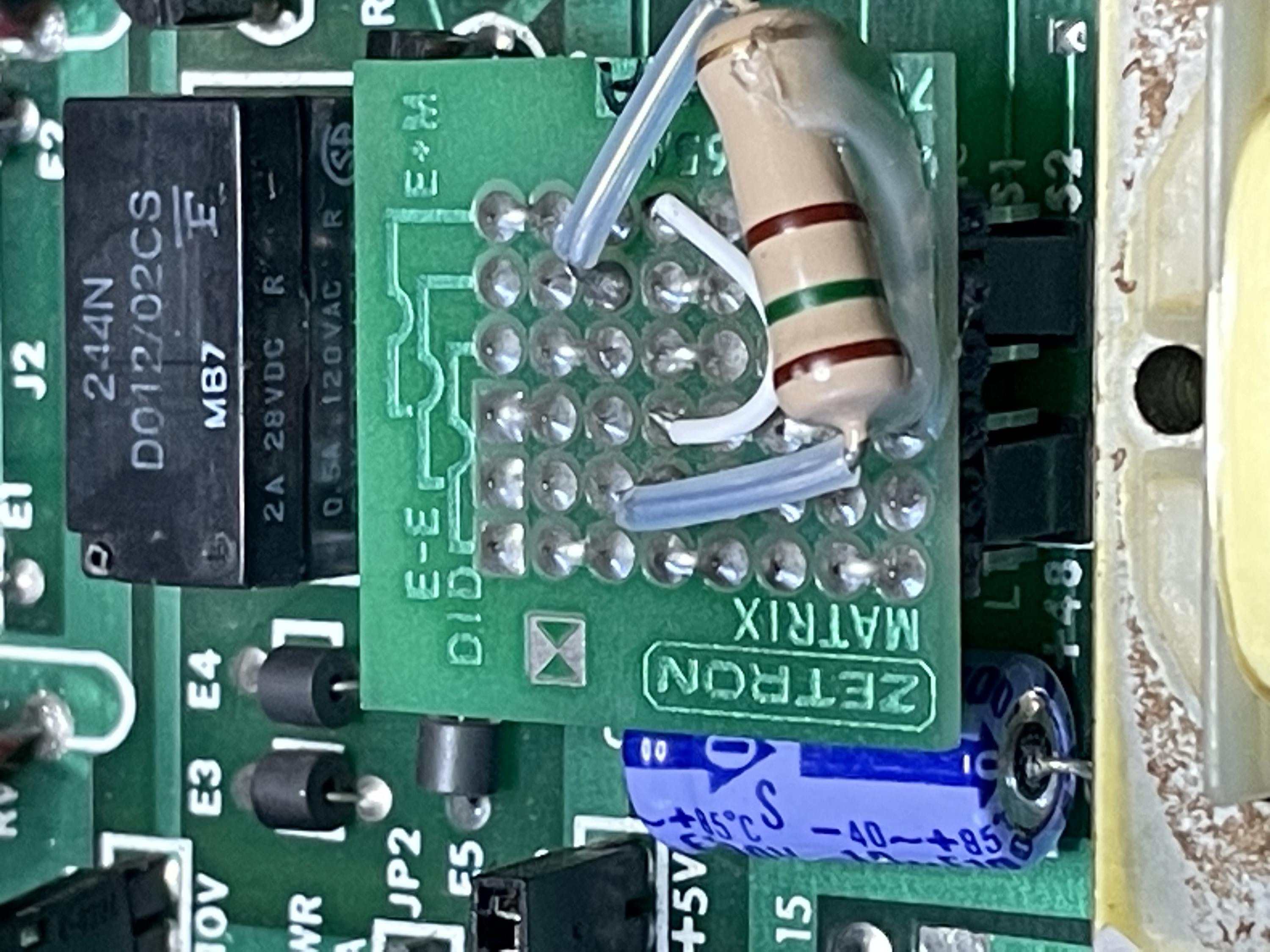

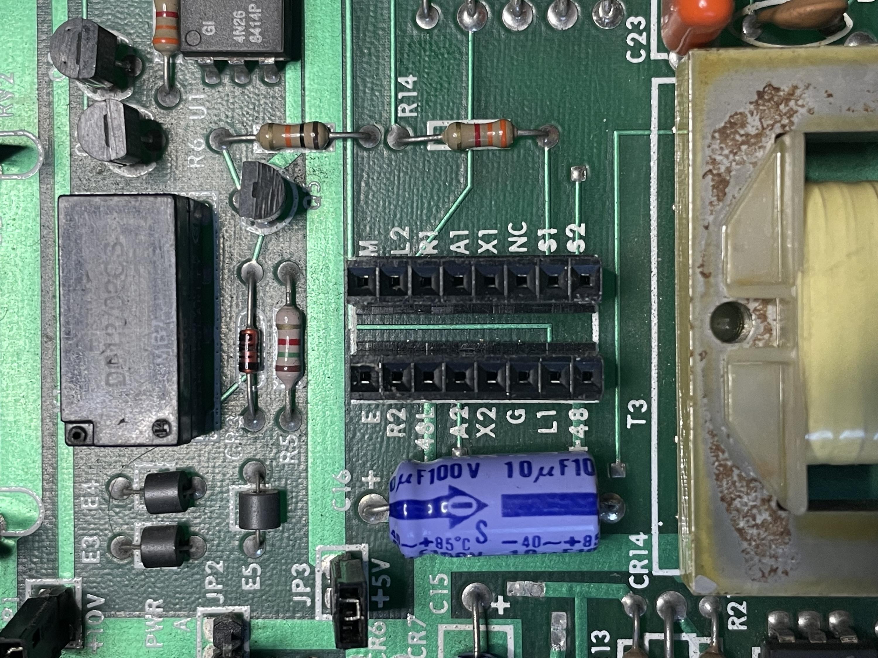

                              For F*CK sake's. The problem is or was in the Zetron all right. I went all over that damned heap of pieces of sh*t. Blah... checked the MOVs, the diodes, switching ring and tip, changing PSU (wrong PSU with it), nothing worked.
                              Look over that big yellow transformer. There is a Matrix board. All I did was to move that board over ONE NOTCH! So the setting is E-E. That's it!
                              Stupid thing works perfect now. No ring booster needed anymore!

                                  In the DID setting of the matrix, there would be nothing connected between either sides (open).
                                  In the E-E setting there is a 150 Ohm 1 watt resistor across A2 and R1 on the matrix
                                  In the E+M setting there is a jumper between A2 and A1 on the matrix.
                                  Thanks stj... I saw that too... but that is a way too easy fix!

                                    From the manual, the Matrix plug:
                                    DID = Telco is DID/PBX Loop/Local
                                    E&M = Telco is E&M Type I tie-trunk
                                    E-E = Telco is End-to-End Phone Line

                                      I did copy already the EPROM and the RAM with the battery inside.
                                      Went and got a phone ring generator. It’s 100VAC @ 30Hz. To make a sanity check.
                                      Phone ring generator, splitter, Zetron and the old rotary phone.
                                      Set the Zetron matrix to DID: Zetron sees the ringer, phone doesn’t ring and the ring generator sounds like it has a load on it.
                                      Set the matrix to E-E: everything is working and happy as it should.
                                      Now if someone can explain that in simple English why that is, I’d greatly appreciate it. Guess I got a 200 paper toilet read to do.
                                      Question is which setting is correct? I mean the Zetron's are just on a stinking regular phone line. It's not going through some crazy company phone network. So IMHO the end to end setting is correct?

                                        Verdict: the e-e (end to end) is the correct one. The matrix changes the tap points on the transformer, to accommodate what ever other phone line system works. The DID setting will work on a true end to end phone line, but it’s not correct as other phones connected to the same line won’t ring. However the Zetron will see the ring and pick up. The problem never surfaced for like 25 to 30 years, because the Zetron was on a single dedicated phone line.
