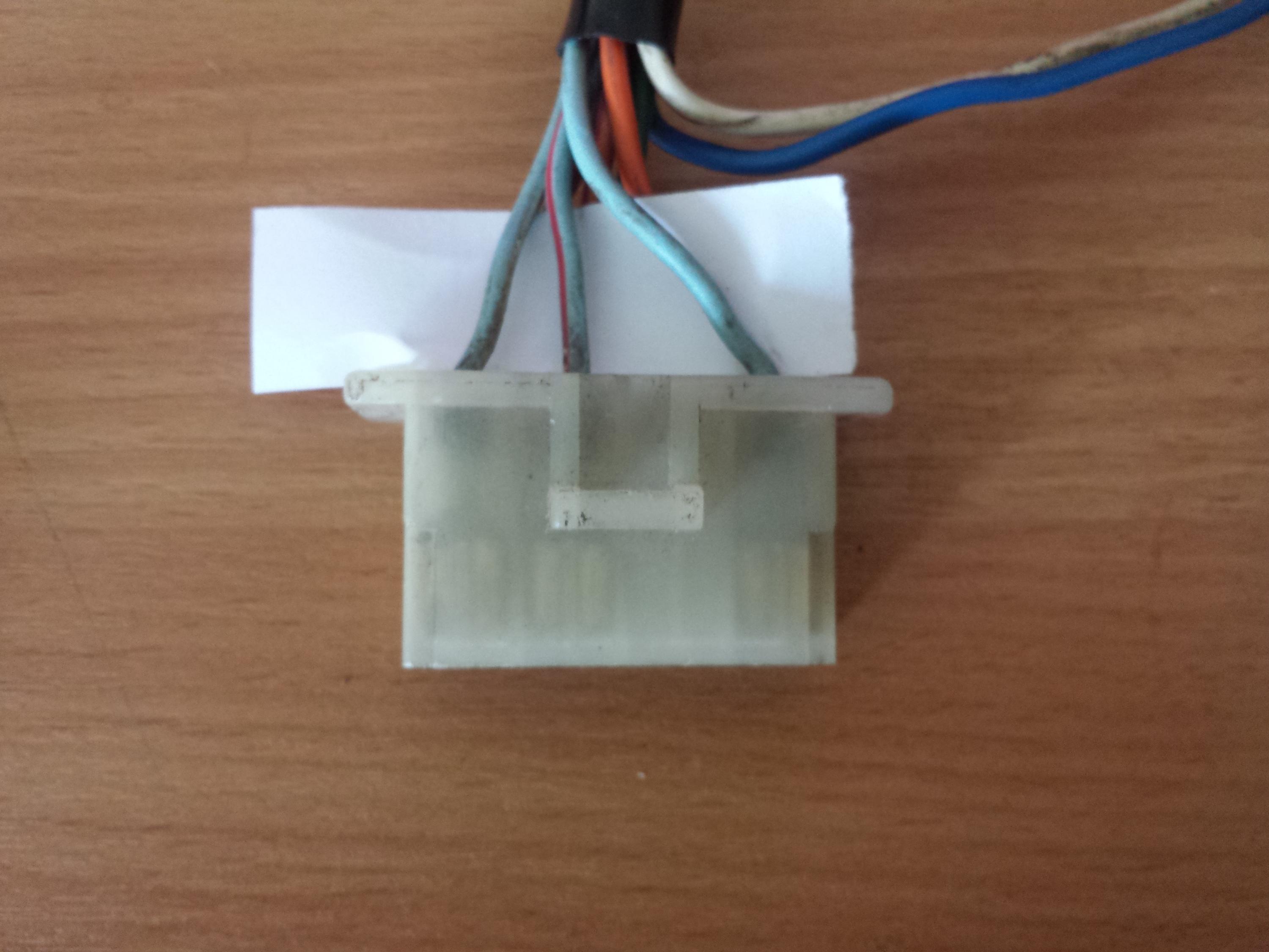

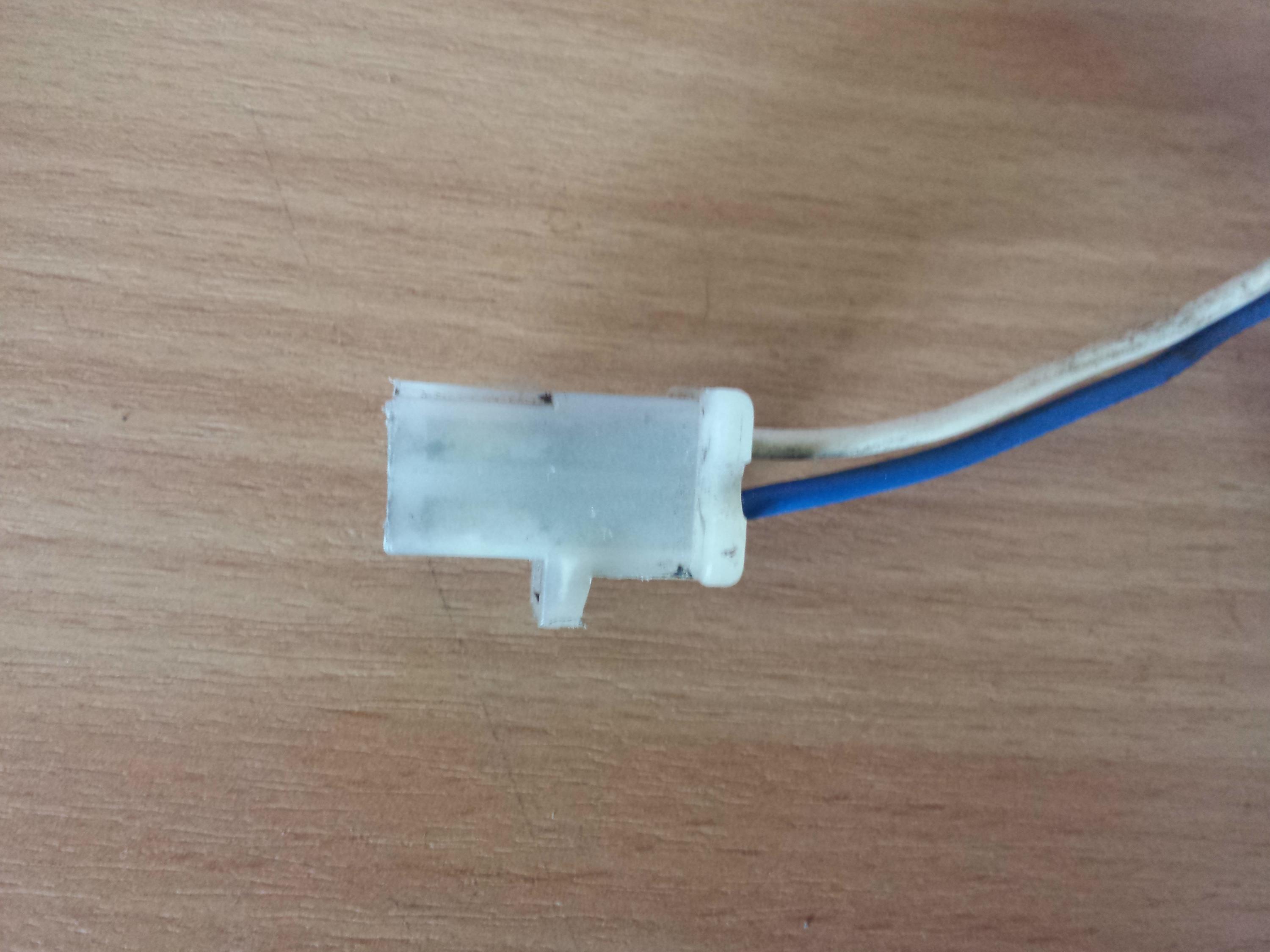

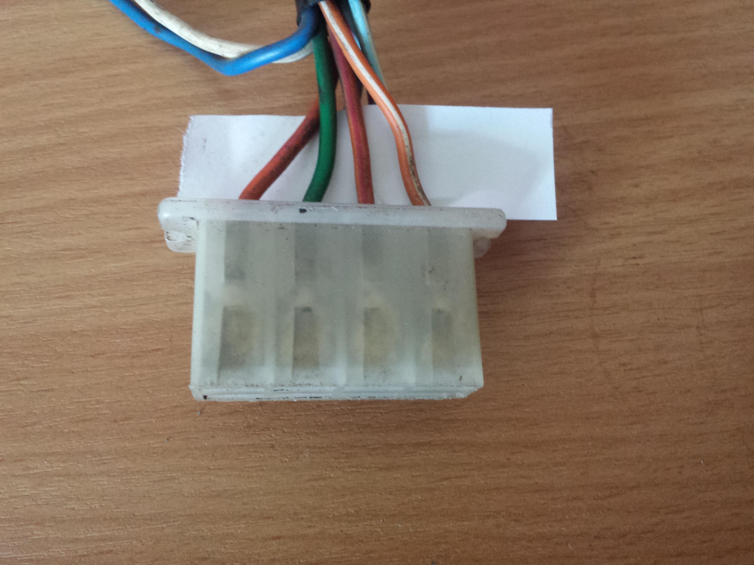

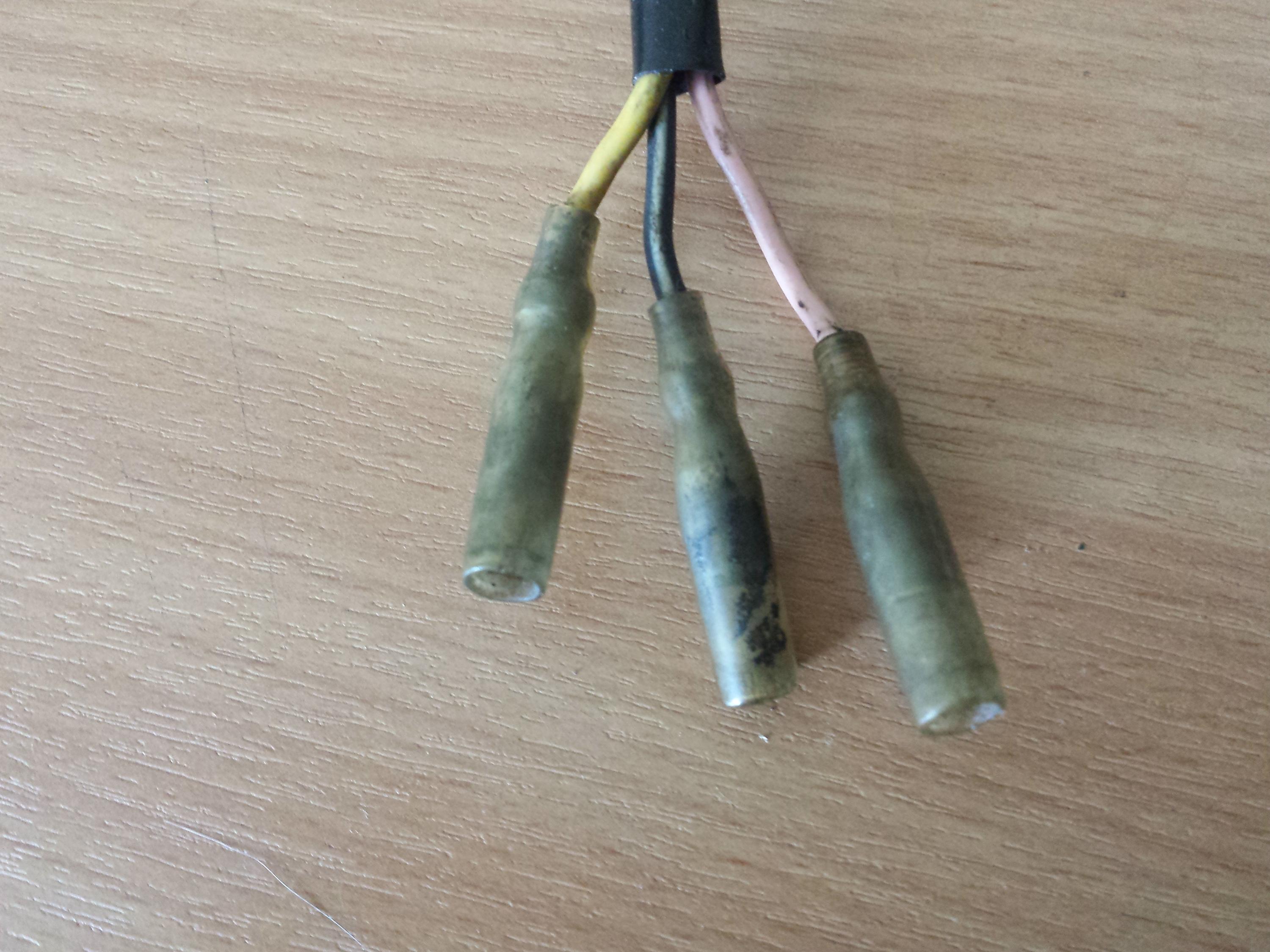

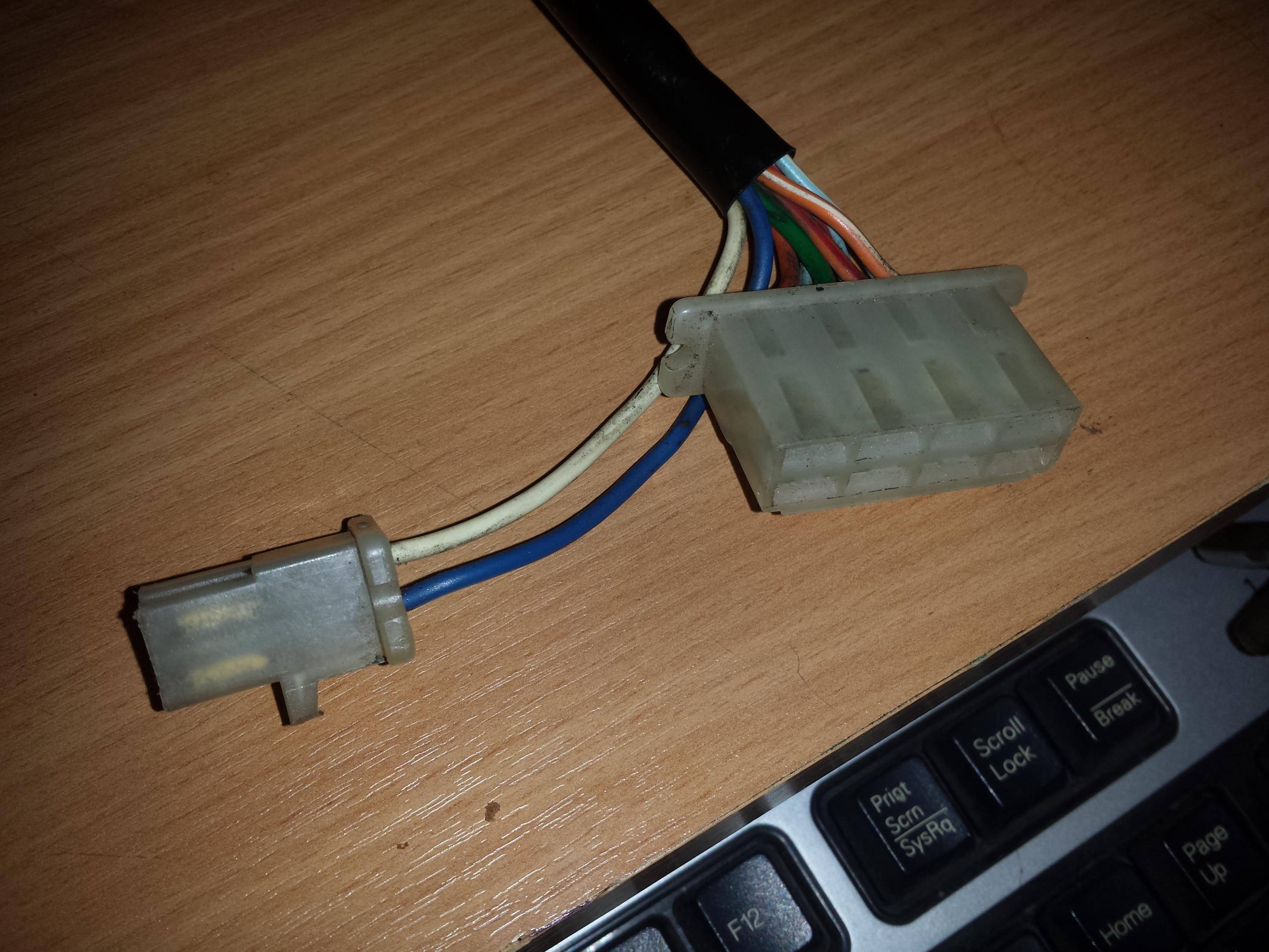

                Here are some photos of the connectors and a list of what they are and where they go. Ive listed them in the same order as the schematic to make it easier.
                2 way female spade
                blue
                white
                8 way female spade.
                blue
                white
                green
                orange/white (left tdc)
                orange/red (left tdc rtd)
                orange (left adv)
                lt-blue/white (right tdc)
                light-blue/red (right tdc rtd)
                light-blue (right adv)
                3X female bullet connectors
                black/white (on/off)
                yellow left coil
                peach (right coil)
