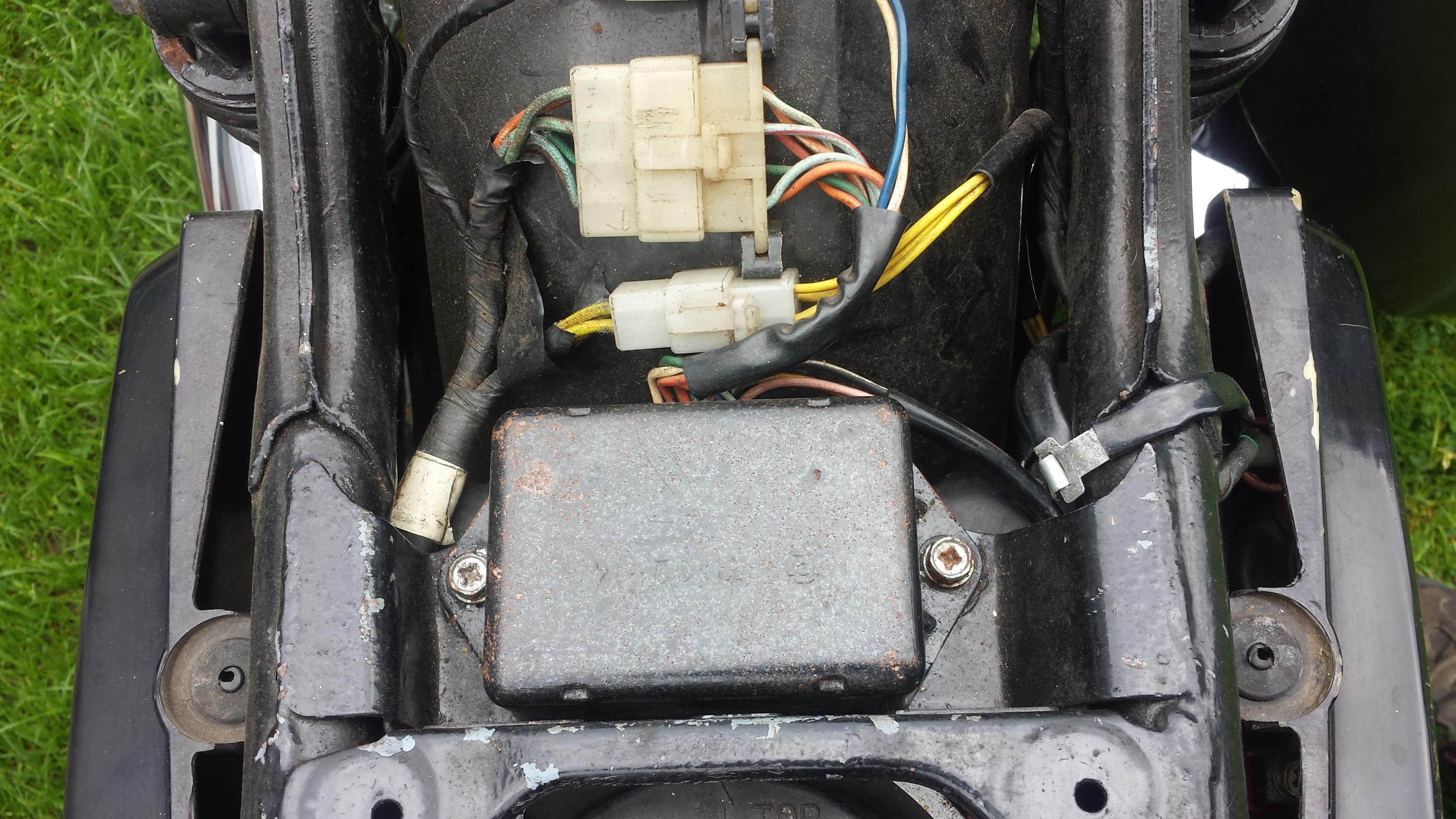

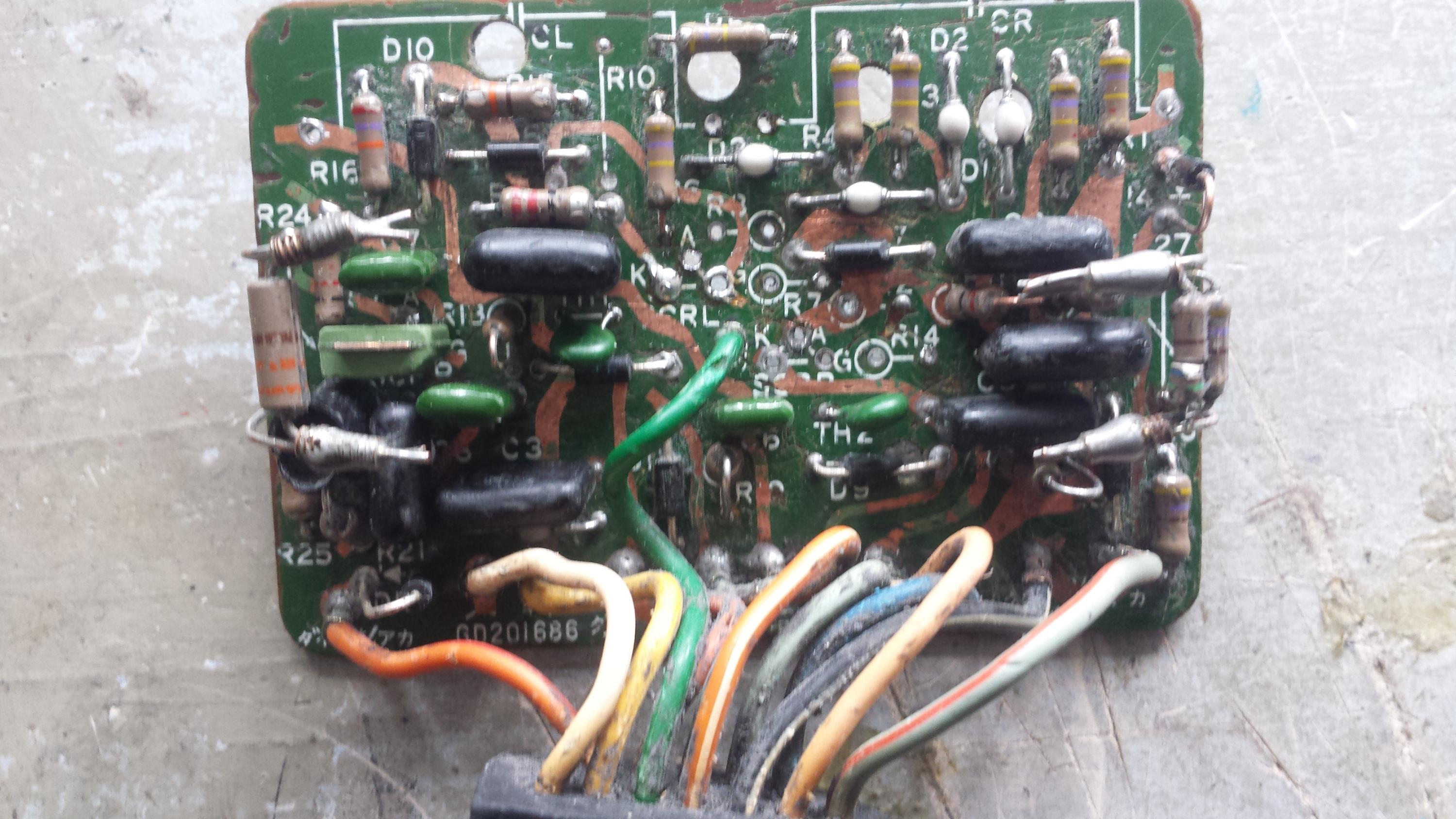

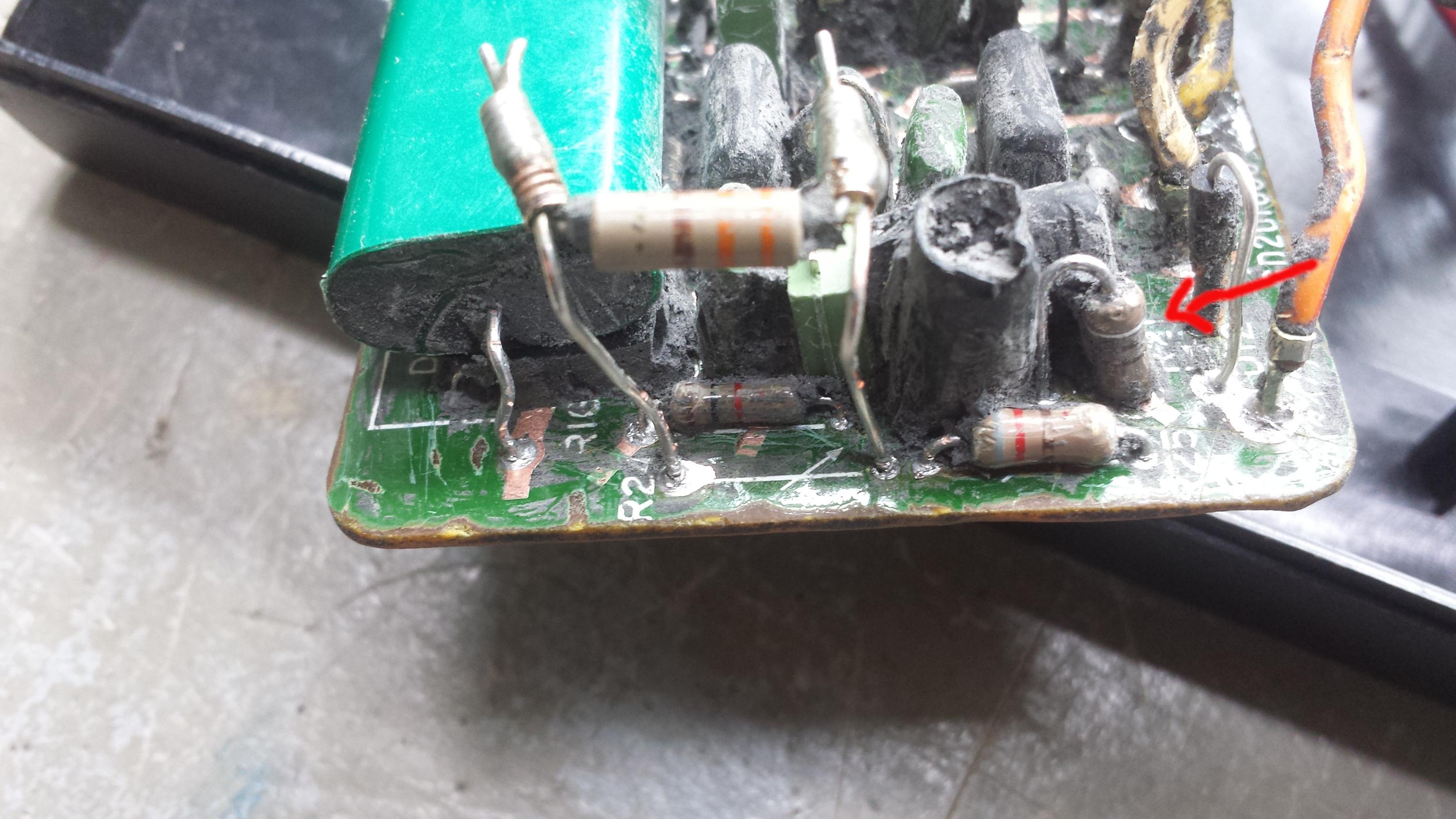

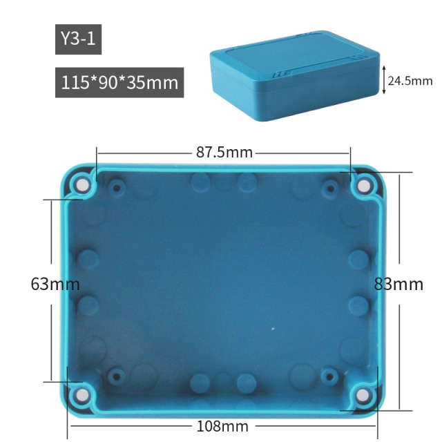

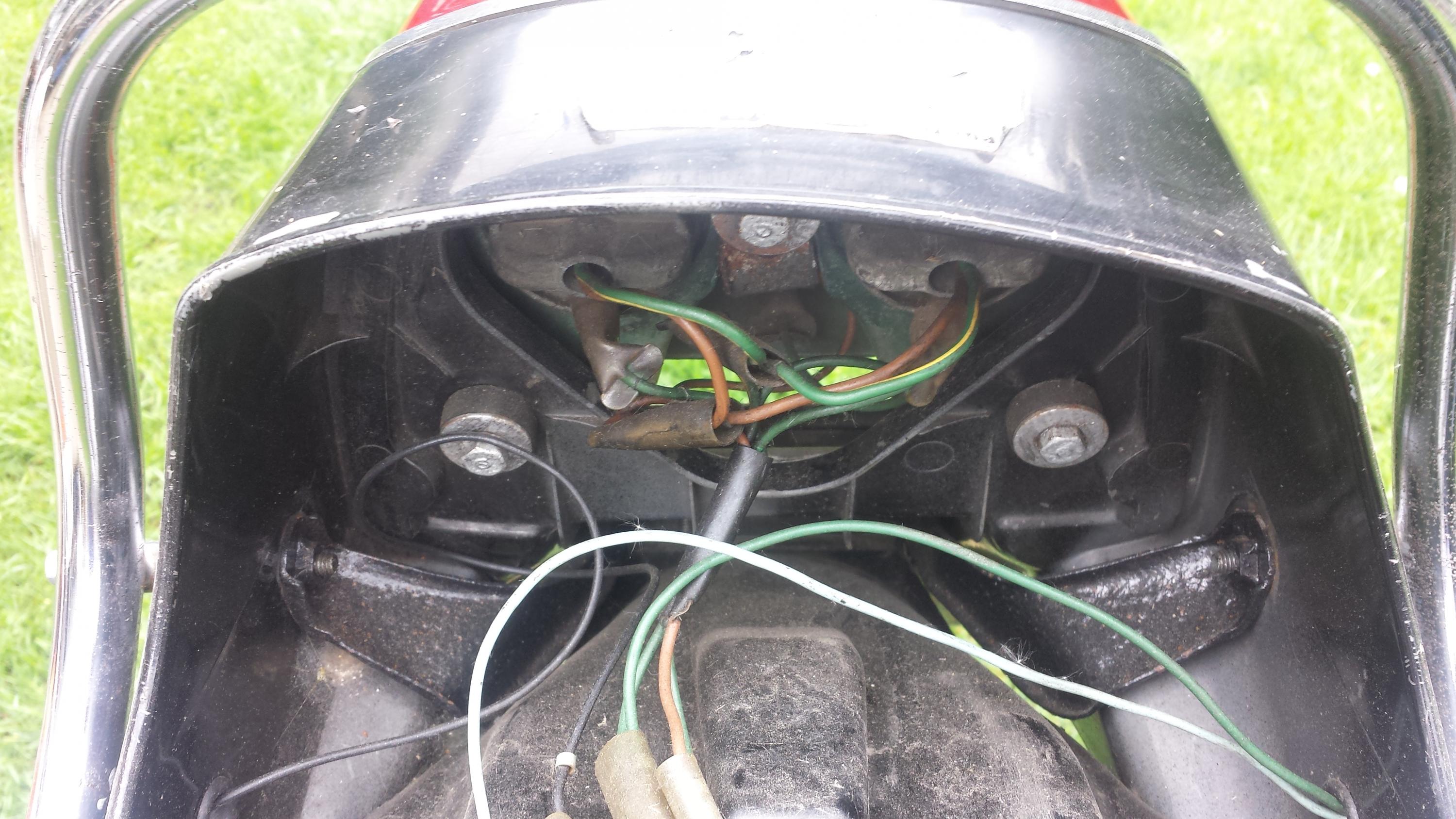

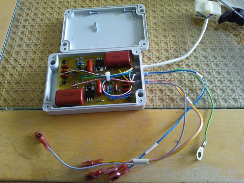

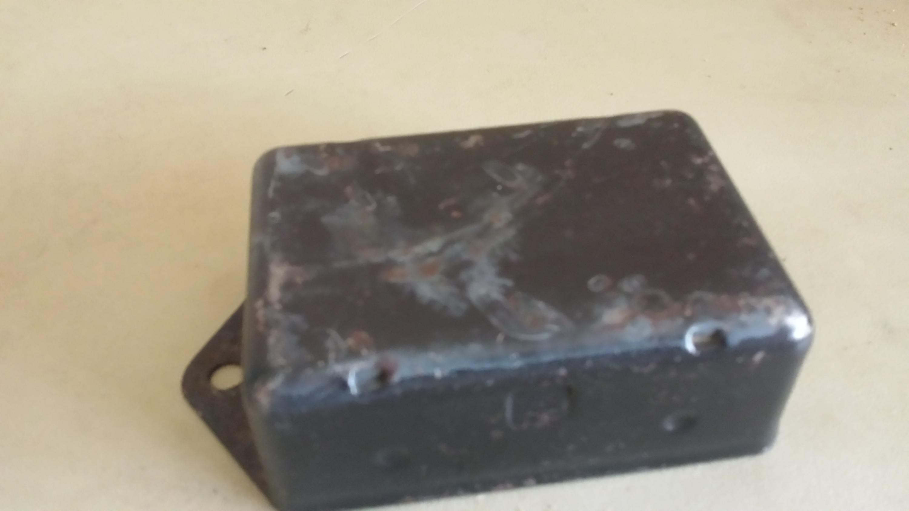

Honda CX500 Motorcycle CDI ignition unit
  • redwire
    • Dec 2010
    • 3912
    #61
    Re: Honda CX500 Motorcycle CDI ignition unit
    I got stuck finding a waterproof box, finnbox appears to be 120x80x30mm and all I could find in North America is way thicker like 55mm. The next size down, smaller enclosures I couldn't fit all the parts on a pcb.
    Looking at Bud PN-1323 or Hammond 1554F the 1554C is too small. Let me know what you think.
    I can make a board made once I figure out the box size and thankfully the heat wave ended. I don't care about a few bucks for parts.
    The other R21 that connects to R20 (220R) is 910R?
      • 31100
      #62
      Re: Honda CX500 Motorcycle CDI ignition unit
      https://www.aliexpress.com/wholesale...of+project+box
      • redwire
        • Dec 2010
        • 3912
        #63
        Re: Honda CX500 Motorcycle CDI ignition unit
        Stop making me laugh
        Sort by size - haha 5,610 results fu
        "waterproof" - no gasket lol avoid puddles
        Comes with screws? - no
        Dimensions drawing - not available
        recycled plastic - maybe
        It's chinese torture. These boxes come in standard sizes, all are way too thick over 2-1/4" 55mm.
        For some reason the prices are actually the same through distributors, I wonder why the price is up there.
        I did find the usual 115x90x55 though and only one box is slimmer but it looks a bit um uh low quality and reviews complain the plastic is hard and full of voids.
          • 31100
          #64
          Re: Honda CX500 Motorcycle CDI ignition unit
          why not a cast or extruded aluminium box?
          • roadrash
            • Oct 2015
            • 490
            • U.K.
            #65
            Re: Honda CX500 Motorcycle CDI ignition unit
            Thanks very much for all your doing for me. Just had a bad time last few days as I lost my mother due to a blood clot in her heart. I Will be back on in few days.
            Last edited by roadrash; 07-08-2021, 04:10 PM.
            • redwire
              • Dec 2010
              • 3912
              #66
              Re: Honda CX500 Motorcycle CDI ignition unit
              My condolences on your great loss. I lost my mom suddenly years ago and I feel it was better than seeing her suffer slowly from some crappy illness.
              Working on the project, best I could do is a PC board for a common 115x90x55mm box. Just too thick for my liking. Please advise if it will fit.
              Best box (pic) is one Aliexpress box low profile but I don't know how long the boat ride would be.
              • Per Hansson
                • Jul 2005
                • 5895
                • Sweden
                #67
                Re: Honda CX500 Motorcycle CDI ignition unit
                Condolences for your loss!
                A small idea about the box if you haven't already considered it is a custom 3D printed one.
                Many places you can order 3D prints from models you provide...
                  • 31100
                  #68
                  Re: Honda CX500 Motorcycle CDI ignition unit
                  noooooooo......
                  you cant use thermoplastic on a bike - it will soften or melt!
                  • redwire
                    • Dec 2010
                    • 3912
                    #69
                    Re: Honda CX500 Motorcycle CDI ignition unit
                    The module is located underneath the seat, away from the engine.
                    ABS rated -40°C to +80°C, no sunlight, I was using this it's low cost.
                    Polycarbonate rated -40°C to +120°C, UV is okay
                    Aliexpress rated nothing, melts if you look at it.
                    pic is of what the low profile finnbox looked like.
                    • roadrash
                      • Oct 2015
                      • 490
                      • U.K.
                      #70
                      Re: Honda CX500 Motorcycle CDI ignition unit
                      Originally posted by redwire
                      The module is located underneath the seat, away from the engine.
                      ABS rated -40°C to +80°C, no sunlight, I was using this it's low cost.
                      Polycarbonate rated -40°C to +120°C, UV is okay
                      Aliexpress rated nothing, melts if you look at it.
                      pic is of what the low profile finnbox looked like.
                      Yes you are right Redwire, the CDI box is located under the seat and is not in a exposed area to the wet. its more likely to just get damp under there.
                      The height of the box is more important than any other dimension as if its too high it might be subject to the seat pressing down on it or even the seat may not fit anymore. Otherwise there is plenty of room around it. If it was larger than the original it would be fine as long as its not higher.
                      I've spent hours going through that awful schematic and and following the circuit through against the real PCB. and I can only find one resistor R21 which is directly connected to R25 and R20. There is only physically one single R21 on this PCB which sits mounted vertically just to the right of R25 and below R20 (in tube). The value of R21 on my PCB is 910 ohms. see photo.
                      • roadrash
                        • Oct 2015
                        • 490
                        • U.K.
                        #71
                        Re: Honda CX500 Motorcycle CDI ignition unit
                        Have you managed to get all you need Redwire? I've almost finished putting the old unit back together and just have a few broken resistors to replace. I am only reassembling it for reference purposes if needed.
                        Is there any more info you need from me Redwire.
                        Last edited by roadrash; 07-13-2021, 01:35 PM.
                        • redwire
                          • Dec 2010
                          • 3912
                          #72
                          Re: Honda CX500 Motorcycle CDI ignition unit
                          Will this enclosure fit? Bud PN-1323-DG
                          It's the same size as Finnbox but thicker and people were using Velcro to mount it. I'm not happy with all that but it needs to be waterproof because of the high voltage. If you know of something better, I'm all ears. I have all the part values and circuit.
                          • roadrash
                            • Oct 2015
                            • 490
                            • U.K.
                            #73
                            Re: Honda CX500 Motorcycle CDI ignition unit
                            Originally posted by redwire
                            Will this enclosure fit? Bud PN-1323-DG
                            It's the same size as Finnbox but thicker and people were using Velcro to mount it. I'm not happy with all that but it needs to be waterproof because of the high voltage. If you know of something better, I'm all ears. I have all the part values and circuit.
                            Just took a look on my bike and the CDI box sits in a recessed space in the frame, below the seat. Your box would not fit as the space available is not much bigger than the original CDI box which was 134 x 65 x 35.
                            The maximum size of the recess in the frame you can see in the picture is: 130 x 65 x 35mm.
                            The maximum size in the tail space behind seat is 180 x 90 x 45mm
                              • 31100
                              #74
                              Re: Honda CX500 Motorcycle CDI ignition unit
                              is something wrong with the original box?
                              why not just sray conformal coating on the board or paint it with rubber and then use the original box?
                              • redwire
                                • Dec 2010
                                • 3912
                                #75
                                Re: Honda CX500 Motorcycle CDI ignition unit
                                The original module had a tight size then because it was potted. Putting 1/4W resistors vertically saved space but is not good for vibration. And then you need to bolt the board down to the can.
                                Due to the high voltage, many parts are big through-hole.
                                What about one size smaller, Bud PN-1321-DG or Hammond 1554C? If I use some SMT parts it could fit. But still 11 wires to get out.
                                • roadrash
                                  • Oct 2015
                                  • 490
                                  • U.K.
                                  #76
                                  Re: Honda CX500 Motorcycle CDI ignition unit
                                  Originally posted by redwire
                                  The original module had a tight size then because it was potted. Putting 1/4W resistors vertically saved space but is not good for vibration. And then you need to bolt the board down to the can.
                                  Due to the high voltage, many parts are big through-hole.
                                  What about one size smaller, Bud PN-1321-DG or Hammond 1554C? If I use some SMT parts it could fit. But still 11 wires to get out.
                                  I think the Bud PN-1321-DG is the most likely as its only a fraction higher than the original.
                                  The original is still in great shape and there is a plastic sheet that keeps the pcb from shorting on the bottom. I would have to make a good job of sealing it up again but otherwise it would be ok and I could also reuse the original rubber sealing piece around the input and output connections. Original case inside dimensions are (mm):
                                  Length=92mm, width=55mm, 30mm.
                                  Just do what you prefer Redwire I would be more than grateful for anything you can do for me and that would keep this old CX500 going.
                                  Was that value of R21 ok at 910 ohms. I dont know why its differnt to whats on that Schematic. It might be a good idea for me to go through all the resistors and check the values against that schematic.
                                  • roadrash
                                    • Oct 2015
                                    • 490
                                    • U.K.
                                    #77
                                    Re: Honda CX500 Motorcycle CDI ignition unit
                                    Originally posted by redwire
                                    Will this enclosure fit? Bud PN-1323-DG
                                    I have just checked all resistor values on schematic against the ones on the pcb and here are the results. Some resistors I was unable to find.
                                    resistors used
                                    ON PCB On Schematic
                                    R1 to R12=470k
                                    R13=82Ω
                                    R14(x2)=82Ω
                                    R15=330Ω
                                    R16=27k
                                    R17=22Ω ................................. 1k
                                    R18n cannot find on pcb or schematic
                                    R19=180Ω
                                    R20
                                    R21
                                    R22=470Ω
                                    R23=680Ω
                                    R24=CAL
                                    R25=820Ω cannot find on schematic
                                    R26=470Ω
                                    R27(x2)=CAL
                                    R17 is 22Ω (grey/red/black/gold) on pcb but schematic says it should be 1K
                                    R14 & R27 are duplicated on the schematic but not on the pcb.
                                    except for R17, all values on pcb and schematic are the same.
                                      • 31100
                                      #78
                                      Re: Honda CX500 Motorcycle CDI ignition unit
                                      did r17 meter as 22ohms?
                                      because reverse the colours and convert gold into brown to allow for age/heat and you get 1k
                                      • roadrash
                                        • Oct 2015
                                        • 490
                                        • U.K.
                                        #79
                                        Re: Honda CX500 Motorcycle CDI ignition unit
                                        Originally posted by stj
                                        did r17 meter as 22ohms?
                                        because reverse the colours and convert gold into brown to allow for age/heat and you get 1k
                                        Its definitely brown red black gold but when I tested it it gives a error so it's duff anyway by the look of it.
                                          • 31100
                                          #80
                                          Re: Honda CX500 Motorcycle CDI ignition unit
                                          brown red black gold is 12ohms
                                          • ngml
                                            Repair of an LG split AC system indoor unit PCB
                                            by ngml
                                            I am trying to repair an LG split AC indoor unit, which does not start and gives a CH05 error code.
                                            This indicates an error in the communication between the outdoor and the indoor unit.
                                            The outdoor unit is fine, so the problem is the indoor PCB.
                                            The indoor unit is an LG PC09SQ NSJ (3SNM09JA2FA), and the PCB has the following type number: EAX35907219-1.2 (see photo1)
                                            I changed optocouplers ICO1X & ICO2X and the NPN transistor S9013 which drives optocoupler ICO2X (see photo2), but this did not remedy the fault.
                                            Does anybody have the schematics of this board,...
                                            02-01-2025, 12:55 PM
                                          • roadrash
                                            Motorcycle flasher mystery.
                                            by roadrash
                                            usually get help on here for computers and monitors etc but I thought you guys are the best I can think off to help me solve a real mystery.
                                            I have a Honda NT650V bike and recently fitted a towbar to tug a little trailer sometimes.
                                            Everything was good until I connected up the trailer socket.
                                            The problem is whenever I use the direction indicators/flashers it causes a misfire as soon as I cancel the flashers the misfire stops. The bike without the trailer lights attached is fine.
                                            .So far Ive tried the following:
                                            1) I replaced the battery for a higher A/h original...
                                            04-28-2022, 05:29 AM
                                          • nobbnobb1
                                            Bose Companion 5 - Unit Powers On then Cuts Off Shortly After
                                            by nobbnobb1
                                            Hi guys,
                                            Trying to salvage a Bose Companion 5 computer speaker system that powers off shortly after powering on. It's got a primary USB input (built in DAC) and an aux 3.5mm input. The USB appears to be the primarily source that tells the unit to power on (control pod LED goes green) as the unit has no power switch.
                                            When I first connect power to the unit, plug in the USB, it will play audio nicely for a minute before it drops out and the unit appears to go into standby (control pod LED goes red). It stays in standby and I cannot seem to power it back on without physically...
                                            02-03-2022, 11:14 AM
                                          • Gjackson
                                            Air-conditioning unit power supply failing to power up
                                            by Gjackson
                                            Hi all, I managed to narrow down which PCB was causing my Haier AC to throw out an E7 error code (E7 indicates that the indoor unit and outdoor unit cannot communicate). I found that the outdoor unit power board which gives 5v and 15v to the outdoor unit module board fails to fully power up.. The power Led starts to fade in incredibly slowly and the 5v and 15v power buses jump around like crazy and never reach their required voltage. I unplugged the module board from the power board and the power board powered up fine! It had a steady 5v and 15v out and the power LED came on instantly and Bright....
                                            01-08-2022, 09:24 AM
                                          • navagator
                                            Hitachi Power Supply Unit Interchangeability
                                            by navagator
                                            I have a Hitachi 57F710E rear projection set with a bad power supply board. I've tried to fix it with help from this forum as well as another one, but without success. Today I found a Hitachi rear projection set for sale on Facebook that looked just like mine. After contacting the seller I found out it was a 51F510. According to the service manuals my set uses a HA01312, POWER UNIT DP4X-DM_24W and the 51F510 uses a HA01313, U901, POWER UNIT DP4X_24W.
                                            Does anyone know if these 2 power supply boards are interchangeable?
                                            Thanks.
                                            01-08-2024, 07:53 PM
